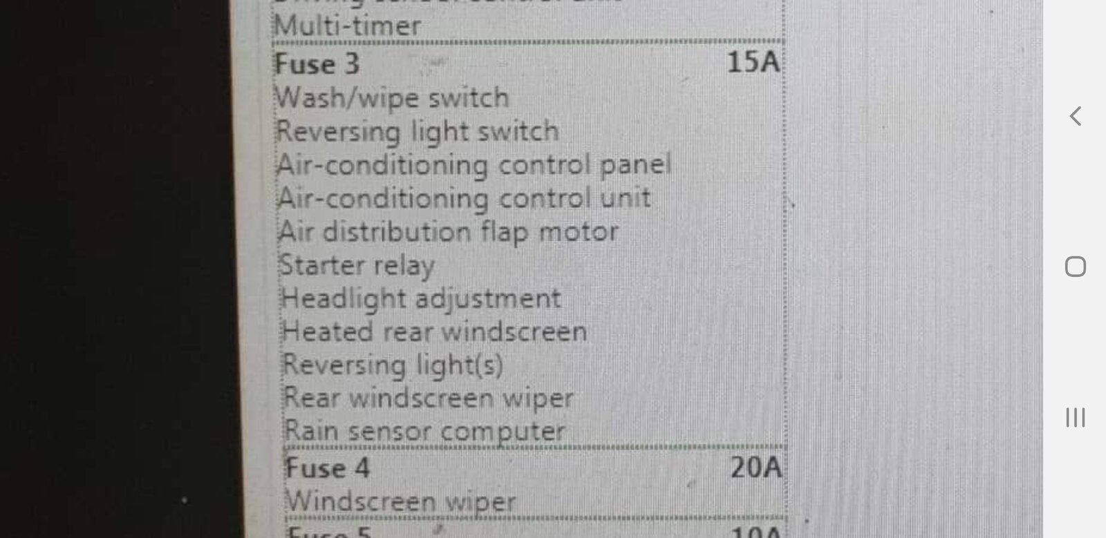

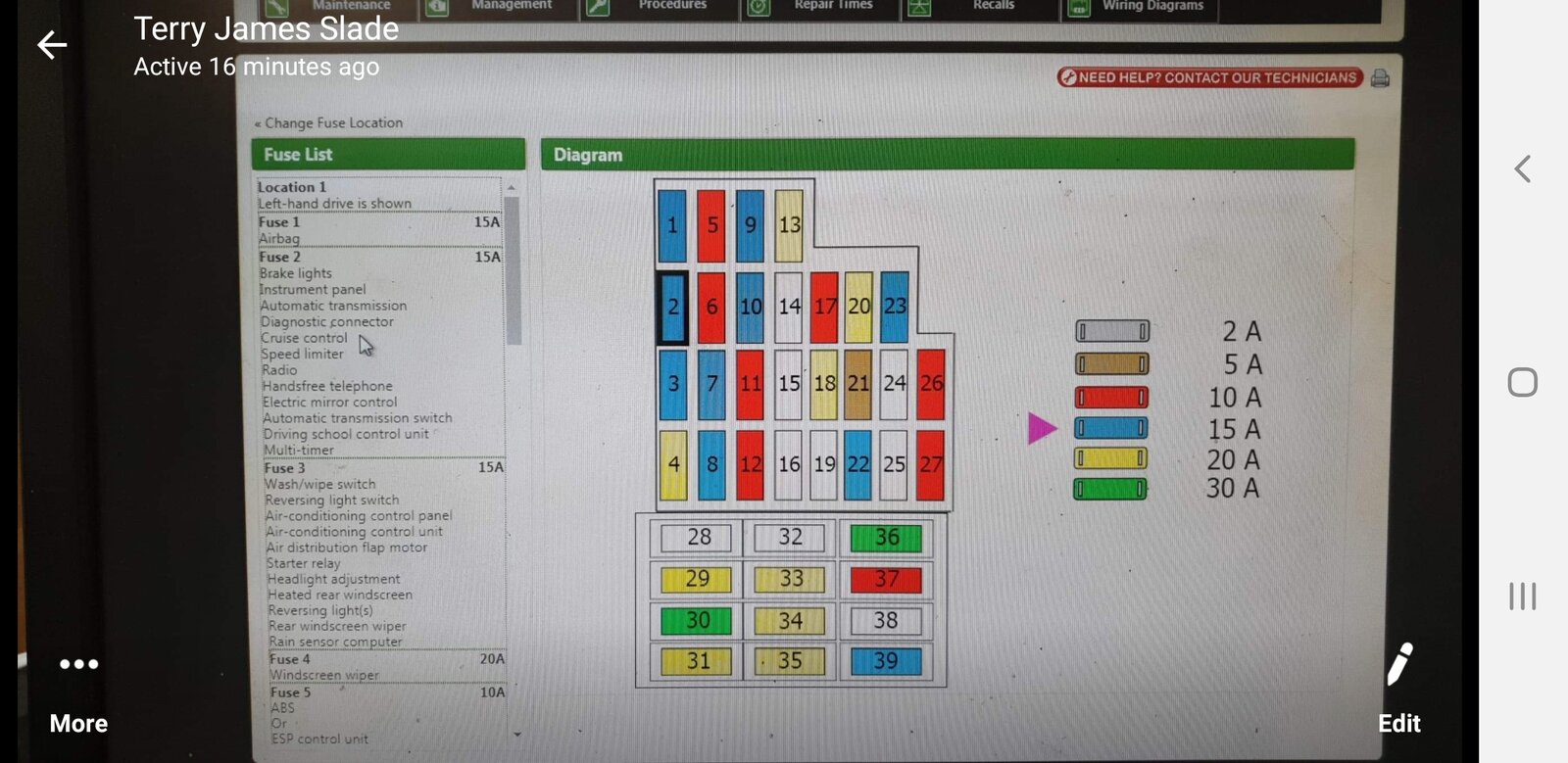

So I brought a car to get me out of a tough spot as my family car was vandalised to the point it was a right-off now out of work due to it.
But any way brought the car but realised it had afew things needing doing to it I.e the rear window wiper and the washer pump- turns out in my initial investigation that the fuse that runs all those things blow as soon as I turn the key so the dash lights come on! Has anyone got any idea to why this could be happening
I’d start by unplugging as many of the things as you can on that list and then seeing if you can get the ignition to come on without blowing the fuse.. then from there on in plug one thing back in at a time and test.
