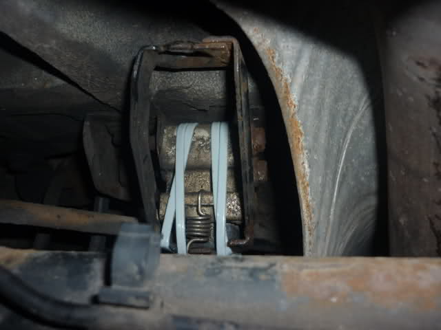

Garage have cable tied the brake load sensing valve on my cup
Car  172DD Cup
as above, it failed mot due to having 150 efficiency on rear nearside and 40 on rear offside. i told them it's low on the rears anyway and showed them the vosa newsletter. they weren't having anything and charged me to fit a new caliper, and it looks like they've cable tied the valve up, i guess because the new caliper didn't make much difference and to get the efficiency up and get it through its mot. they can't fail it for imbalance on the rear.
current plan is to go down there and ask them to remove the cable ties and show me the brake efficiency, and if it's low, ask for my money back.
or should i contact vosa?
http://i55.tinypic.com/f2ttmp.jpg

can't tell if this is cable tied to increase or decrease?

My understanding of this (someone please correct me if I'm wrong) is that when you brake in the cup the rear end lifts slighty. In doing so it 'closes' the valve reducing the flow of fluid to the rear calipers. This stops rear wheel lock up as a result of no abs. Therefore I'd assume that by cable tying it open means the back end will lock up a lot easier and possibly result in you losing the back end under braking.

no, the lever doesn't touch anything on the back. on cars that have the rod and spring in place and actually use the valve, when the weight at the back increases (passengers or boot) it increases the efficiency on the rear brakes to compensate for the extra load. not active on the cup due to lack of abs. that's my understanding.
i just want to make sure that what they have done in the pic DOES increase the efficiency to the rear, then i can go in with "so you've used cable ties to alter the brake efficiency to the rear of the car, thus altering the brakes from the manufacturers specification to get the car through it's mot and making the car dangerous to drive in the process" or something to that effect. not forgetting the fact they've had to use cable ties to increase the efficiency, means i probably didn't need a new caliper in the first place.
i got the black box with the brake likes going into it, and a lever with a hole in the end, but there's no rod or spring connecting the lever to the car

As the car is loaded up the lever is pushed to open the valve and allow more pressure to the brakes. Very common on most fwd cars. They have cable tied it to open the valve and increase the pressure to the brakes. Wouldn't want to be braking hard in the wet in your car as it is that's for sure!
so is the lever usually connected to the rear beam and pushed up on other cars, as opposed to being connected to the underside of the car and pushed down?

"Only the Cup version of the Clio does not have an actuating arm fitted as standard. This version does not have ABS as standard and the pressure regulator within the valve is set to a predetermined value at the factory."
The wording here suggests that the cups are built with fixed valving internally and the position of the arm has no effect? I suspect this more as standard 172's don't seem to have an issue despite having the same rear calliper, and the valve probably towards a mid position during a test. My guess is that cups would be valved at worst case (no rear load, heavy vehicle pitching forward motion and minimal rear traction - the ABS on standard cars would detect rears locking and relive rear pressure in this case, cups obviously can't - no abs - so run the "safer" worst case)
For my MOT, the arm was as high as it could be, simulating a heavily loaded rear giving maximum braking effort on the rear (if the arm works, more rear braking effort in the test case than a standard 172), however it only got 20ish%.
Has anyone ever dismantled (or actually know the inner workings of) a cup spec load sensing valve to see if they are fixed valving, or if moving the arm actually affects rear braking? The tester was going to clarify the issue with VOSA over this week (the test was on Saturday and VOSA are office hours mon - fri)
the position of the arm does have an effect. you moved it in the right direction, the higher the arm the greater the rear braking pressure. problem is, due to no movement they must disentegrate inside over time.

Its just a normal rear bias valve that they fix to a set position and don't fit the arm to at the factory. Shouldn't really be touched but some of them have had the arm fitted in error by garages trying to get the rear efficiency up.
Tieing the valve closed simulates having weight in the back of the car with the arm connected and opens the valve to increase the rear braking effort. Can end up swapping ends under heavy braking if you aren't careful.
FF models is a different ballgame as its all controlled by the EBD system.
The way the valve works is that the lever is pushed down by a little piston when you press the brake this reduces the pressure to the rears. With the spring in place it acts against this - the spring causes the lever to push back against the piston. Thus if you cable tie the lever up tight against the car it can't move and you get maximum rear effort.
If you get someone to press the brake while you put your hand on the lever you can feel it move down, unless the lever is seized.
None that shouldn't be missing on purpose. They are not connected to the rear beam from the factory, its pre set as said previously.

Are u sure? When my arm was cable tied up the brake efficiency increased
