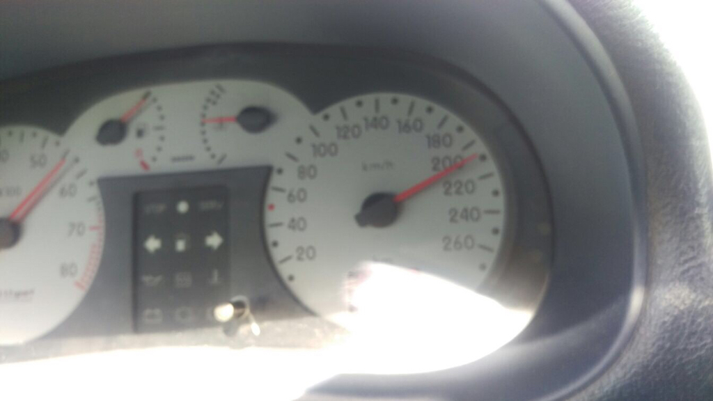

Hello everyone, will you help me get a good configuration for my gearbox, since I feel the fourth speed is very long, yesterday testing the car gets very slow in 4th to 6000 rpm goes to 135mph and is moving very slow, which Would you recommend changing, the final drive, or the gearbox? my car is a clio sport 172 ph1 year 2000

later I'll try to make a video and I'll pass them so they can see the development of the speed

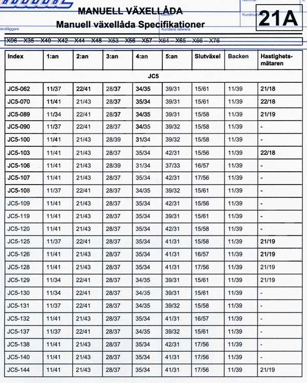

@blito2790 I’d say with almost certainty the cars got the wrong gearbox fitted currently. The 172 PH1 originally came with a JC5-089 - I’d say from the ratios you’ve currently got a JC5-126 from a kangoo fitted (something with long ratios but speedo drive fitted as the PH1 obtains it’s speedo readout from the gearbox, the ph2 does not have speedo drive and obtains it from the ABS rings)
You can of course verify this, slide under the car and remove the plastic undertray (if fitted) The gearbox code is punched into the bottom of the gearbox.
  PH2 172
@blito2790 PH1 obtains it’s speedo readout from the gearbox, the ph2 does not have speedo drive and obtains it from the ABS rings)
The Ph2 172 Model Year 2002 and 172 Cups had the JC5-129 with a manual speedo drive, as indicated in the right hand column of the table I posted earlier in the thread.
Model Year 2003 172`s with cruise & ESP, produced from 10/2002 onwards had the JC5-130 with no speedo drive as used in all 182`s.
The 7th column from the left in the above table is the final drive ratio for those that had not worked it out.
089, 129 & 130 have identical gear ratios, but the 089 has a higher final drive, but not high enough to do 135mph @ 6000 rpm in 4th.

Here is the video you can do, it looks good what I tell you about the gearbox relation and see when you change to 4th as the car dies
  Clio spor 172 Ph1
Jesus that drop off after each change, that must be awful to drive !
You could try and source a jc5 thats got at least a higher final drive than that. Youd lose a bit of first gear but would be heaps better than that
http://www.volvohowto.com/jc5-jb3-jb5-jb1-and-jb0-renault-gearbox-ratios-and-applications/
