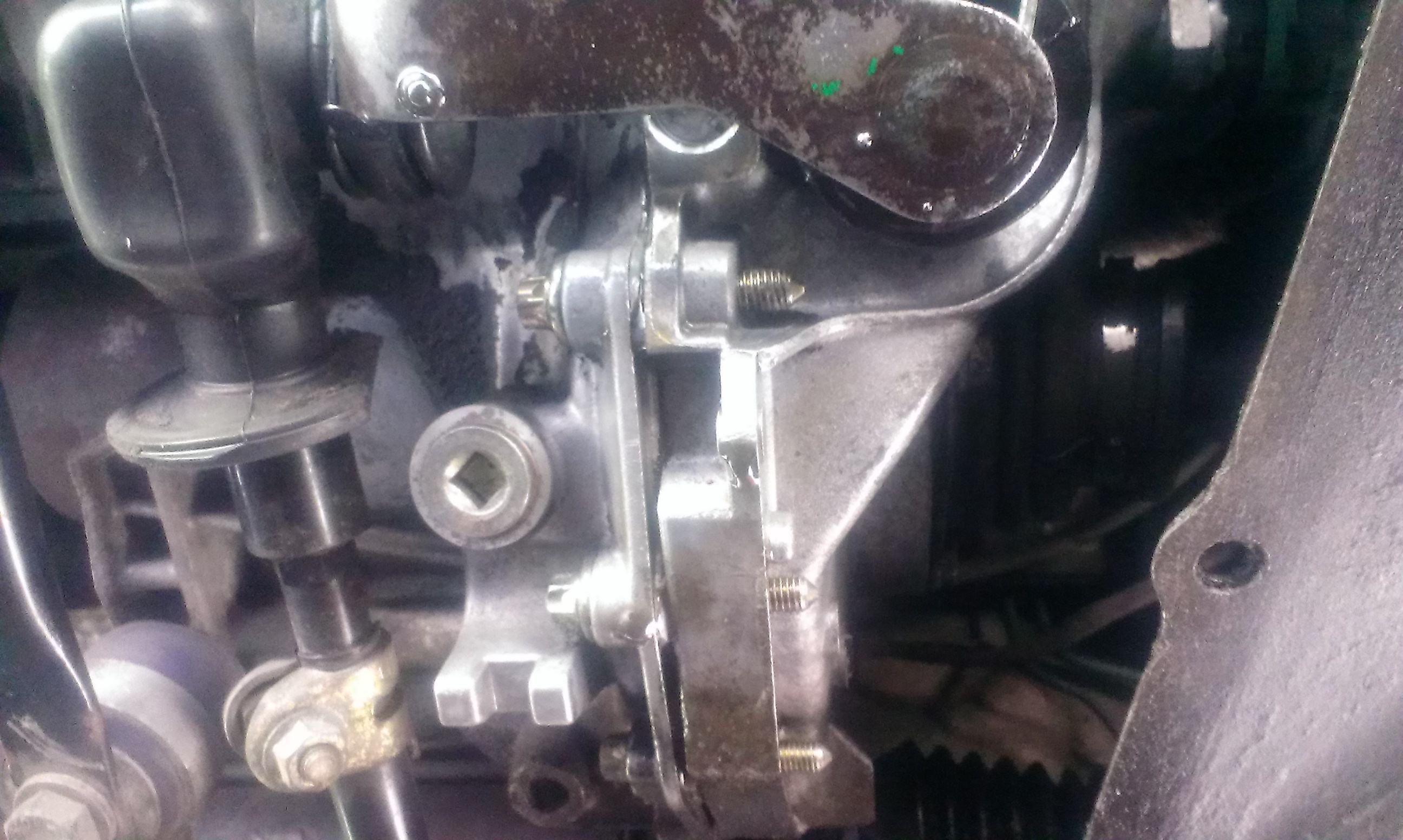

Have got à leak on my gearbox have looked under the motor and there are three drops one of the selector and two drops to the back of the gearbox IMAG0880.jpgIMAG0880.jpg

Selector seal. Very very common problem.
Wipe clean , top up and monitor it.
Only "real" fix is box out and open it up to change the seal and whilst at .it refurb it.

i have cleaned it up got a bowl under it when it is on the drive and can see three drops coming of it have seen on here if it is dripping it is to much. Lukej have you used this item and did work cheers for the help.

ok mate would u say the drips near the back of the gearbox bottom of the pic would be coming from the selector

I had gear oil all over my backbox when my selector seal went.
As ive said before the only proper fix is a new seal which does need the box removing and re building.
These other seal things on the market do not work and i have tried and tested most options that mapco one is the same as the TND product they require you to butcher the outer part of the seal so it can be fitted when its actually the inner part that causes the leak. I would give it a couple of months if you are lucky before it pisses out worse than it did before fitting it . I drove for over 18months with a leaking selector seal and topped it up every 3months. Box died in the end(not oil related) so had the seal done correctly.

ok mate i think i will skip that easy fix then have just found my car on here when it was owned by previous owner and it was leaking then so i will keep it top up for now looking at getting a secound hand gearbox then get it refurbed .
