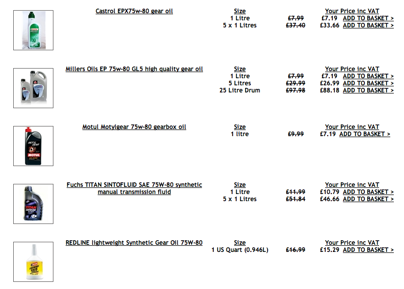

Which of these would you lot recommend, if any? 88k and never been changed as far as I can tell, gives me something to do at the weekend.

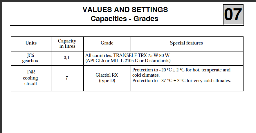

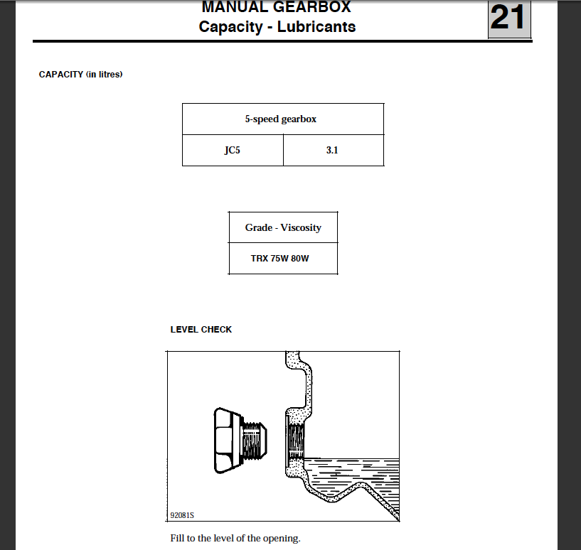

Postin' these from the service manual because they're relevant.
