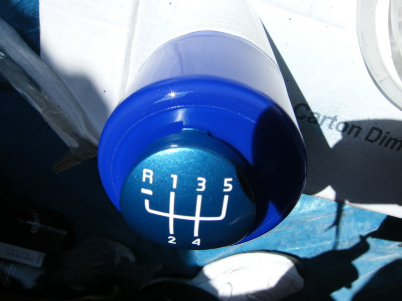

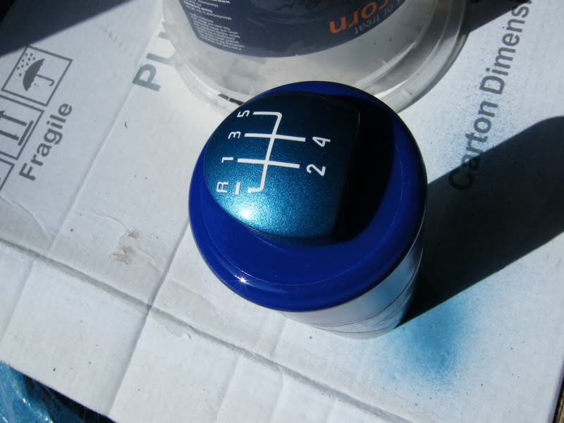

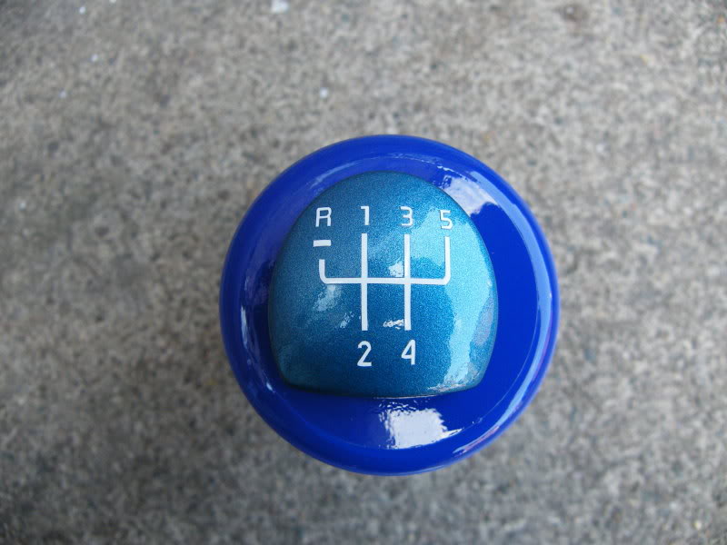

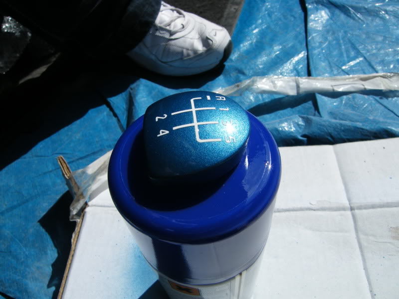

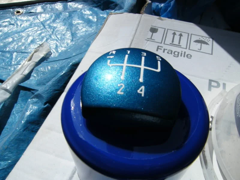

Brought this off Jay.Lad (cheers buddy) for £5 to refurb in Nautical Blue
and here's the results,(after sanding,3 coats primer,3 topcoat,3 laquer..
pictures not great but really looks mint in the flesh..

Yeah once i baked the top coat ( well left it in my snakes vivarium @ 100 degrees lol ) i added the decal and then applied a heap of lacquer in light coats then baked again in " Syd's " viv ... hopefully it doesnt wear down too soon ...may even polish the nuts off it in a couple of days before i chuck it on the car..

When I did mine I put a few layers of laquer on it over a few days and let it dry properly. has been fine now for a good few months - not wearing at all

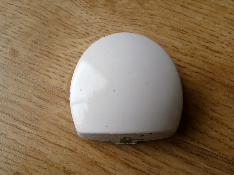

May sound silly but how do you remove this plastic insert from the gearknob?
I used a lil flat blade screwdriver buddy on the corner of the flat bit of the insert(bottom)..take your time not to damage the gearknob itself ,pops out pretty easy..
