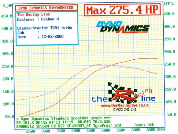

Well anyway, I own a Toyota Glanza V as a lot of you know. It has been stripped out of all carpet, rear seats, trim, spare wheel, stereo, speakers and aircon. Weighs around 880kg or so, which should give me a power/weight ratio of around 300hp per ton.
Not been around for a while, so here is my new HP and torque figure, a long with a few pictures.

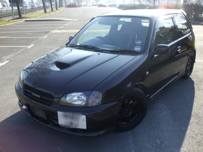

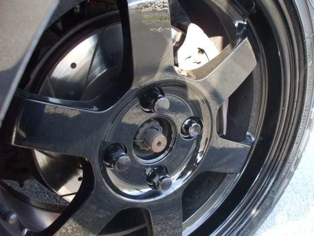

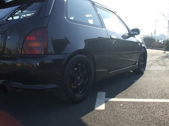

And with new rims and Eagle F1's on.

I see you have 8 POT's? What power are you pushing?

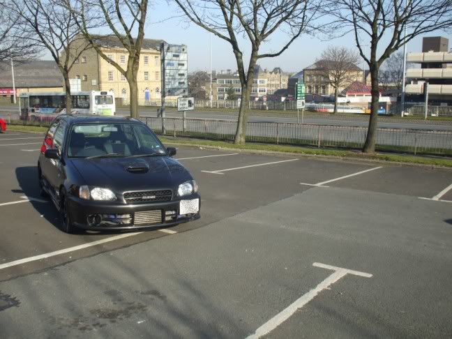

where is your third pic taken next the alpine restaurant? is it denshaw? I recognise it!

Same as you mate, 275bhp, however my car dont weigh as much as a rollerskate! lol.
Mines nearly at stage 1. Just need the nismo 555 injectors and a stage 1 chip then i should see over 300bhp mark.
Bought the 8 pots though as standard jap brakes are always shite aint they! lol.
Unfortunately i've not raced anything quick yet, never nothing out! always had loadsa races in the 182 too :( Saying that, a CTR tried against me down a duel carriageway and i pulled away with absolute ease (was running on low boost too) lol.

DanS - Up in West Yorkshire, dales somewhere..near a reservoir?

Dan - Nice one mate. Got some Celica ST185 2 POT's to go on mine. Sending them off to www.biggred.co.uk to be rebuilt and restored. Car does not weigh much, so 2 POT's should be fine.

Liking the new Rotas. The Buddy Clubs looked sweet though. (I have them myself now lol)
Yeah, the Buddy Club's did, but polished lip is too much hassle to maintain. God dam salty roads..here it was then:

Engine is forged and fully race balanced.
Some of the spec:
Pauter Rods
Ross low compression forged pistons (0.5mm overbore)
NST lightened and balanced underdrive crank pulley
Cruise valve springs
1.2mm metal headgasket
Exedy paddle clutch
The turbo is a TD04L from a 2005 Impreza WRX running 1.4 bar of boost.
About 250 miles to a tank, which is about £35 V Power.
Easy to drive off boost mate, so best of both worlds ;)
