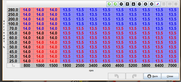

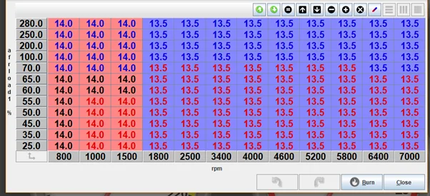

So a nice trick to help you visualise your closed loop response is to get the AFR's dialed in pretty well under open loop.
Say you get a steady 14 (or stochiometric if your using a narrow band) at slight throttle, 1500 RPM. Disable any acceleration enrichment and enable closed loop fuel with the target set to be the same as your observed (real) AFR. You should have very little to no correction %.
Set your closed loop AFR target table (assume you will have one) to be something like this:
Then while you datalog AFR against time take the no load RPM upto 1800 (or whatever your richer column of cells starts). At this point the PID should kick in and start trying to correct the error. Your tuned fuel table is all setup for 14 still while the target AFR is at 13.5. The closed loop should start to try and add fuel.

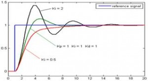

Your data log is basically plotting the closed loop response curve:
Obvs won't be as pretty as that! but will give you a good idea regarding your P,I and D terms - as you already know (but others might not) you will adjust the P term initially to achieve the desired initial rate of correction, the D term to deal with overshoot (as it effectively reduces P as you approach the target) and I to deal with long term errors, or an offset which doesn't go away.
Because you really want the closed loop fueling response to be pretty slow you will end up with quite small P and D and as a result a larger than expected I. If your control loop is too fast you will generally oscillate around the set point (even more true with narrow band), but also because the AFR can change so rapidly you end up driving the loop mad. You want to be ignoring all the small fluctuations and deal with the slower errors which would be caused by environmental or running conditions which are currently outside of your setup OR in many cases due to a missing table which the ecu designer didn't think was worth it or didnt even know about.
For example if the ecu was able to correct for combustion temperature or fuel grade etc... most cannot which leads to a tune error which cannot have been tuned for. Closed loop AFR is good for dealing with that at lower RPM and light loads (cruise idle blah).
Hope that rambling made sense
This is also the approach I use to set closed loop idle - I want the control loop to be slow and deal with the offset error (so 300rpm error), I use the faster advance curve to smooth the fast fluctuations. The advance method gives you a nice smooth idle, the closed loop idle correction gives you an idle at the correct RPM. If you ecu used PID idle it is likely the same algorithm the programmers used for AFR so the size of the terms will be in a similar ball park (maybe).
Good luck - self tuning is fantastic fun!

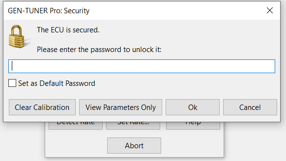

adir
  clio 172
i got my gen90 second hand, 5 years ago.
and it is the first time I'm trying to connect, and upload new calibration.
apparently, the previous owner locked it with password.
i did " clear calibration " in order to reset the ECU , and upload my calibration. and I'm keep getting this massage
what I'm doing wrong ?
incy-spider
Cycle the power and reconnect.. if really struggling you could give Andy a call at Phoenix automotive technologies and he can team view you and sort.

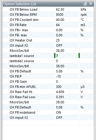

I still haven't got the closed loop lambda control working correctly, it's very odd. It's like the ECU is putting the sensor in error, it works initially then the feedback channels freeze at a value and it no longer works.
I've had the car setup by Chris at EFIParts, he was very very helpful and did a great job. He spent around 30minutes trying to get the closed loop working and couldn't. To prevent wasting time he moved onto the rest of the map. He suggested it might be because I had changed around the channel configuration, even though its configurable in the software he's seen it before when the hardware and firmware don't quite match up if you make some changes like that on this type of ECU.
I initially had the Lambda1 connector powering my wideband and the narrowband plugged into Lambda2. (this just suited wire lengths). I've reconfigured it so lambda 1 is the original channel and plugged into the narrowband, I'm using a brand new Bosch sensor which I can see working, but for some unknown reason the ecu doesn't want to work correctly in closed loop. The ecu measures the heater element resistance, but I can't tell if the sensor is in error or not. This is why I was keen to try a later firmware.
  Clio Sport 182
I think I have the same problems. ECU reading the same value, both sensor and resistance. Even after I disconnect the sensor.

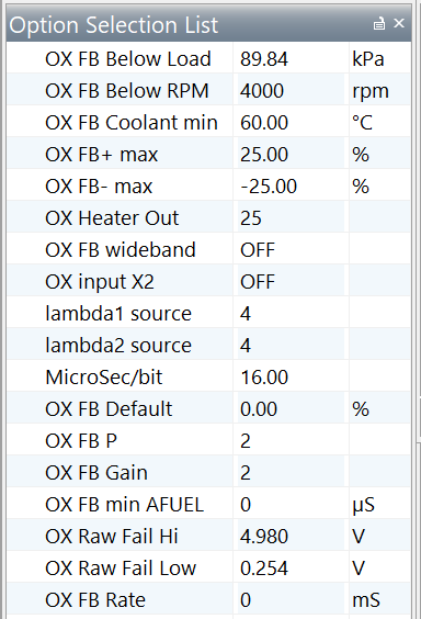

How is your ecu's calibration configured for open loop? Can you share the calibration file? I am taking the same route - making it open loop, because I cannot find a way to make it work with wideband.
scruffydubber
  RS CUP
Hi. I set the feedback rate to 0ms.
I can check the channel name, and any other info you need tomorrow
