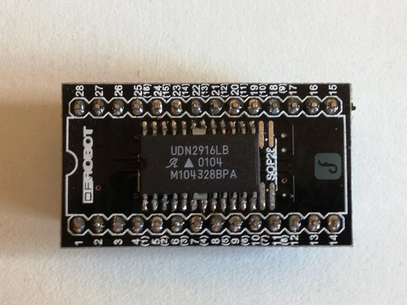

Soic Idle driver chip on a DIL adapter board.

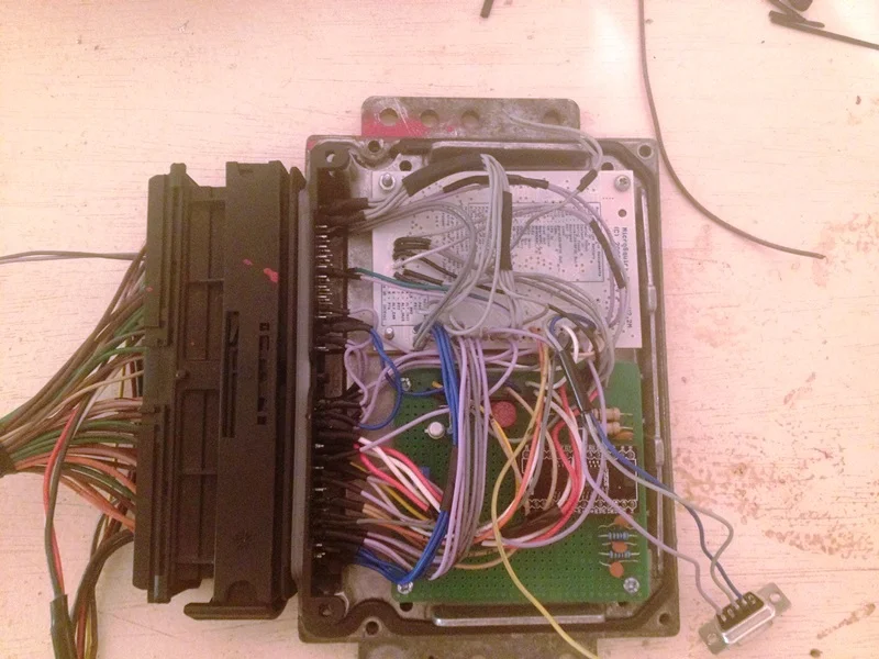

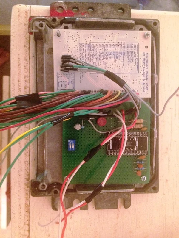

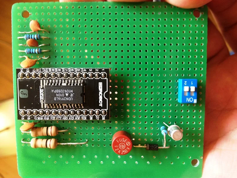

Prototype Add on board
Wiring in the case

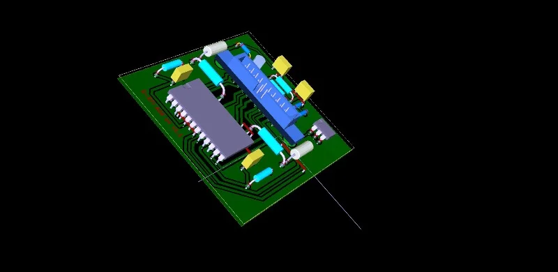

PCB final design to replace the prototype board...
