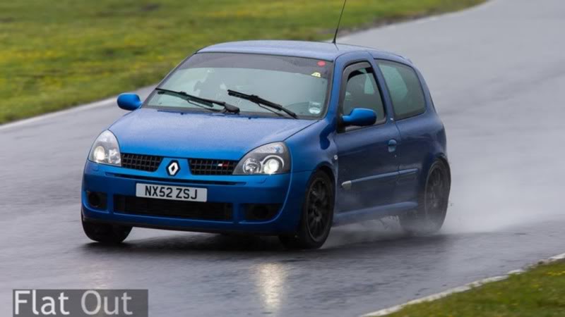

4 deg up front sounds excessive but if you look at below pic then dynimacally it is brought back a fair bit, I have done around 800 track and road miles on a new set of federal RS-R's and not noticed any strange wearing.
This is in the wet too so wing mirrors touch the floor in the dry.

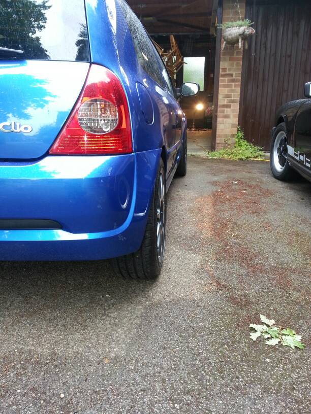

think i have got it sussed , going to add 15mm spacers per side on the rear ..... -2.5 on the front , -1.5 on the rear , just done the geo and got that setup , and will just get rear hubcentric's

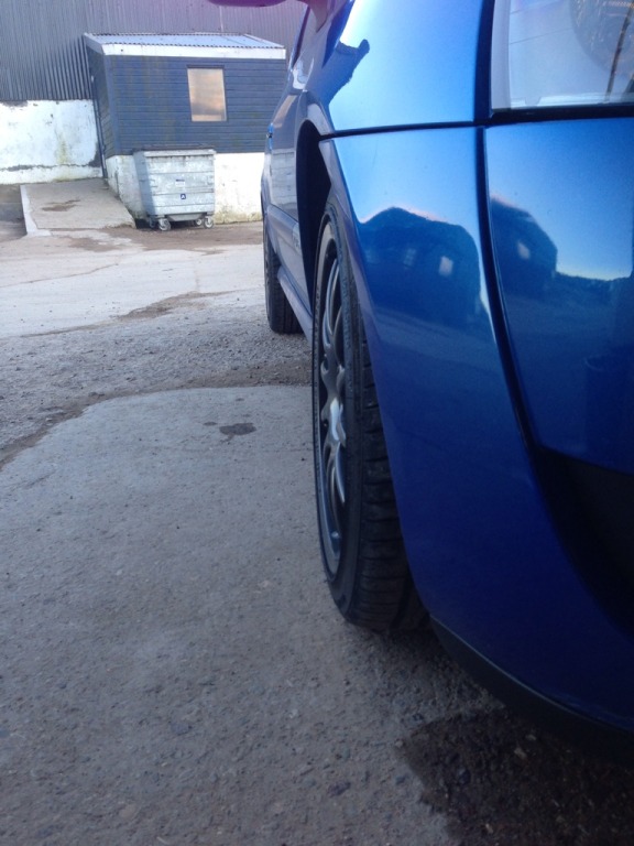

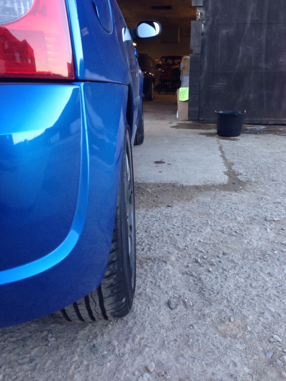

Yours looks a LOT more spaced than mine with just 10mm extra, wheel offset is only 2.5mm different but the thing that is probably making the big difference is the camber, 2.5 looks massively different to 4 deg.
