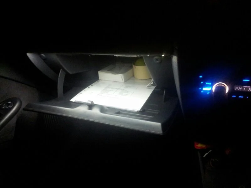

I've used a strip of SMDs for my glovebox using the same sensor when the glovebox opens :)
I took the dash off and tapped into the interior light loom its at the bottom of the a pillar. So when the uch knocks off the timing interior lights this goes as well.
Plus I've used the glovebox switch.
