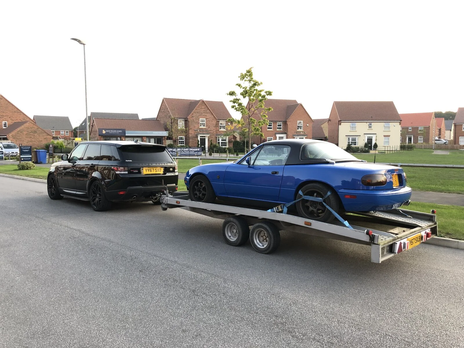

Yes I know I should have strapped the front too, but I forgot the other two straps like a r****d and the car was 3 hours away!

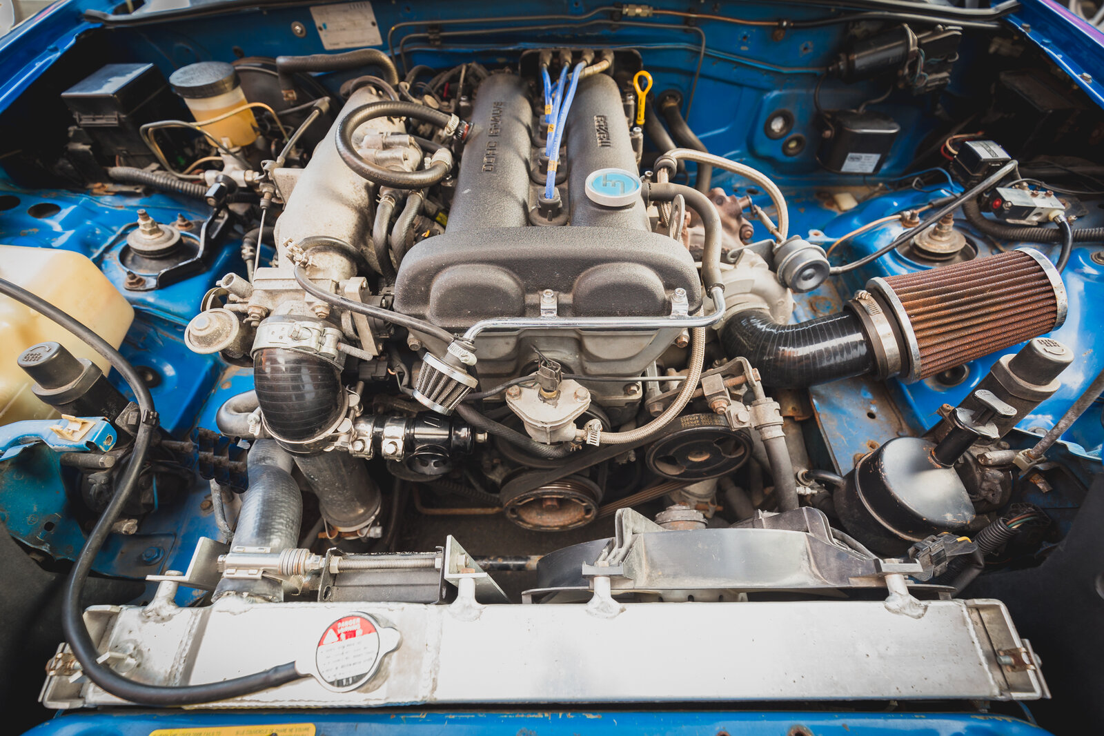

Whats been done to the engine? Forged internals or stock?
Is it the 1.6 or 1.8?
Stock 1.6
TD04 Turbo
480cc injectors
MS2 Ecu
280lb/ft rated clutch
Nothing fancy.
I'd be tempted to put a Holset HE221on it, some 750cc injectors, chinese rods and keep upping the boost till the clutch slips.
Holding 250lb/ft to the limiter would give about 330bhp.
You've seen Compressor Racing have the HE211W and HE221W for sale currently?
The 211 should spool a touch quicker and make the power you need.

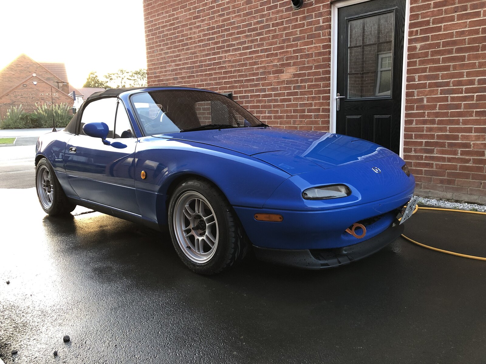

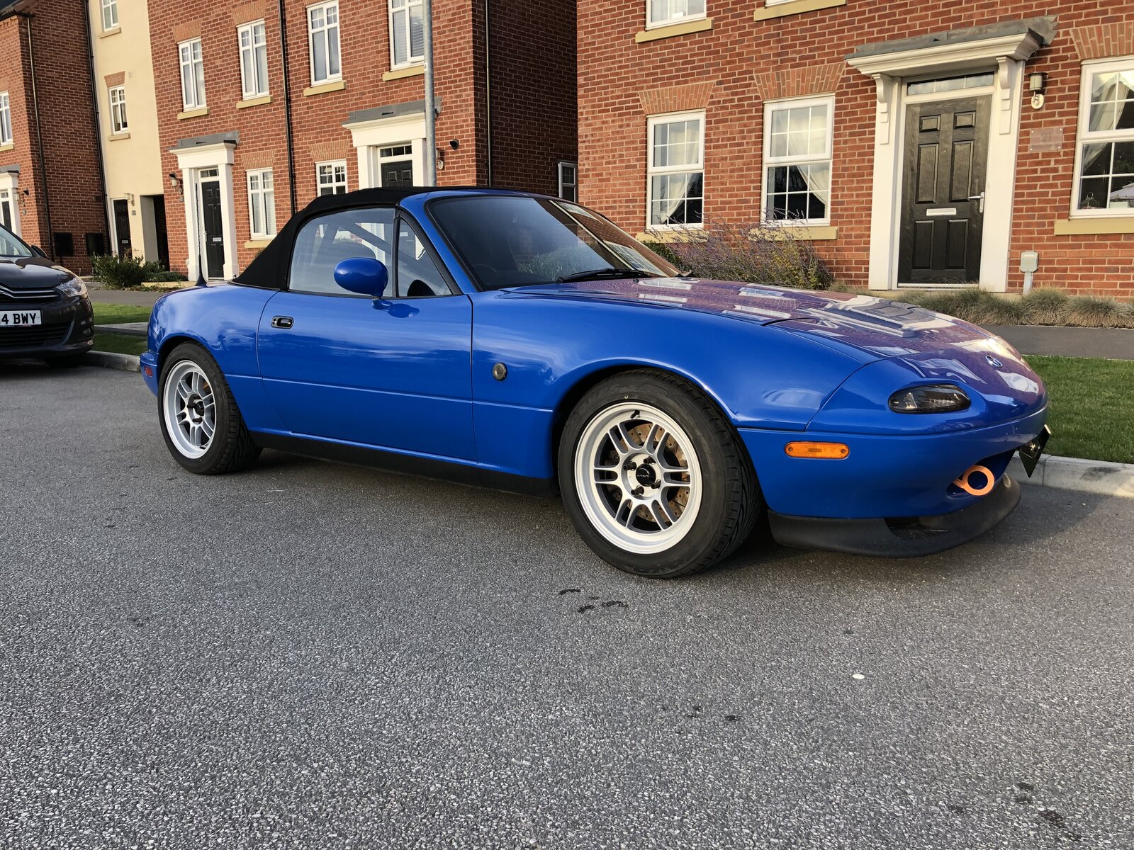

Do like those (genuine?)
I quite like the orange tow eye, goes with the corner reflectors!
Waitey
  Alpina D3, AC Cobra
Oh s**t.
No they aren’t RFP1’s, sack putting £1k wheels on this.
They are Ultralite F1’s. Which are about 0.2kg heavier than a RFP1 and probs not as strong.
Ultralites seem to be hated with the JDM lot. No one seems to understand they’ve been making wheels in England for 50 years!
Euan94
  Volvo C30
Oh s**t.
Fair enough, I wouldn’t be spending £1k on wheels that might end up in the gravel. I’d assumed they were cheap Chinese stuff but they don’t sound like a bad option to be honest. Everyday’s a school day!

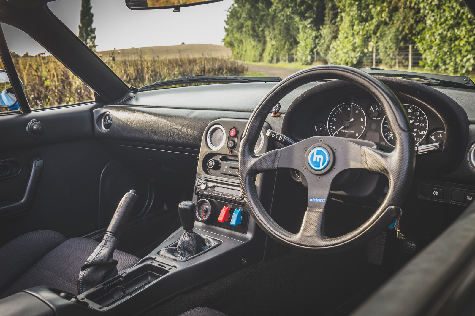

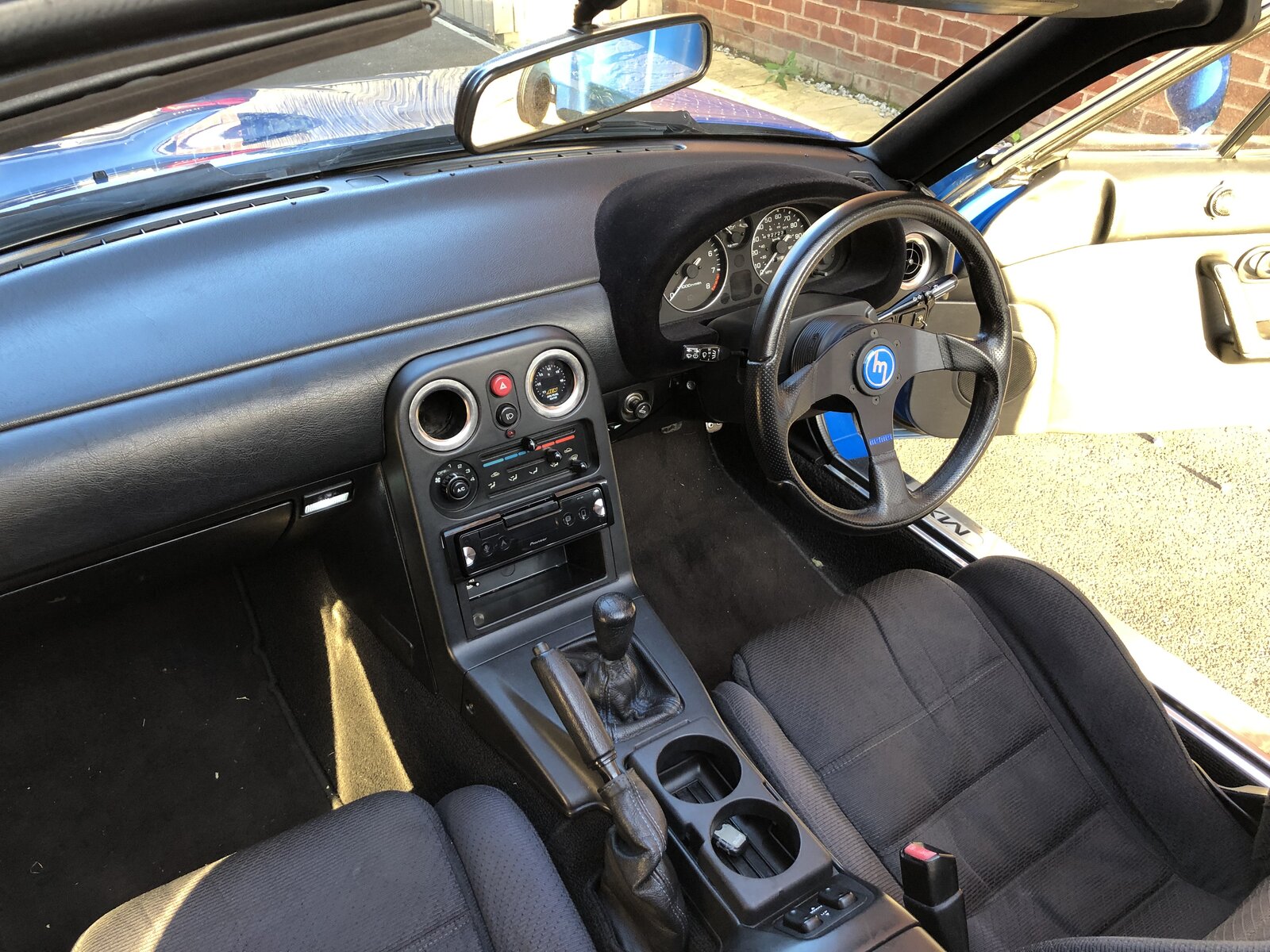

This thing is fantastic. Using it as a daily atm.
Little things I've done.
Moved the clutch pedal downwards so its more comfortable.
Rebuilt the shifting mechanism in the gearbox
Tidies some of the wiring.
Some amber side repeaters came today so I'll get those on it.
Just need to take all the extra gauges out from the inside now.
Waitey
  Alpina D3, AC Cobra
Just waiting on the paint, so I can re paint the engine bay.
Also do a single din cubby hole to replace the horrid switch panel.
Trying to find a subtle bluetooth headunit too to replace the horrid sony thing.
Waitey
  Alpina D3, AC Cobra
Amber side repeaters fitted and the interior has had all the gauges and random switches removed bar the AFR gauge.
I properly love this thing. Esp now with the new Pioneer head unit which uses the iPhone as its screen. Really neat ideal, integrates maps and hands free too.
