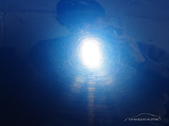

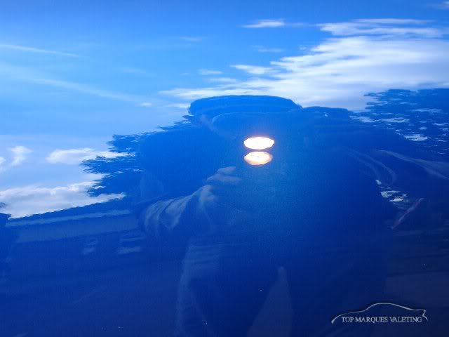

If you can do a complete car in an hour I will pay you £50hr rate.............gotta pass the brinkmann test thou ;)
Before
After
gonna do mine with rotary this wekend so will a spray of megs quick detail remove the holograms or will it take abit more effort
Will take more than a spritz of QD to remove rotary holograms!
They are actually marks left in the paint by the machines pad.
Want a job?
Before
After
im gonna have to start taking some geek pics of my mad mopping skills. the gaffers gonna be wondering wtf im doing though
n could be cause im tired, but that top pic looks metalic and the bottom pic high solid? wrong before n after pics? unless you mopped all the metallic away? lol
They are both from the drivers door of a Mini Cooper S I did........granted one pic is taken in the workshop and the other outside.
I hope I didnt polish away all the metallic'ness lol:o
