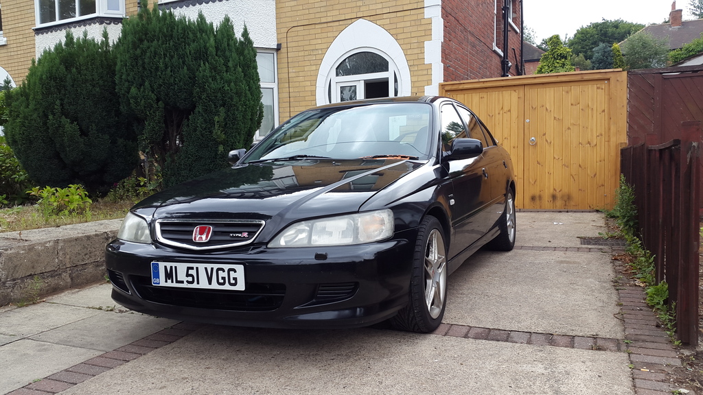

Gone for some vtec y0!
16v_paddy
  Valvers & 172 Cup

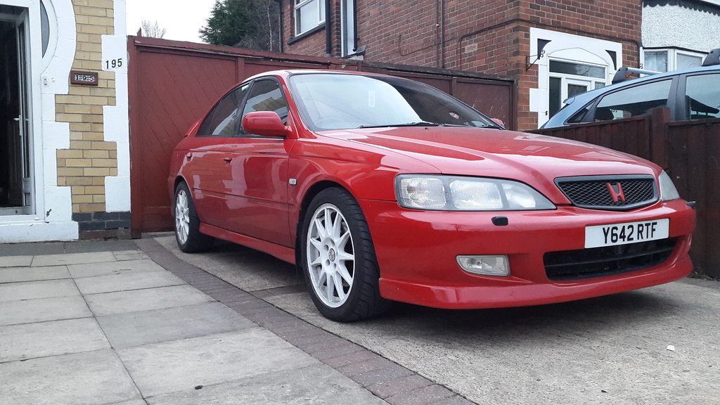

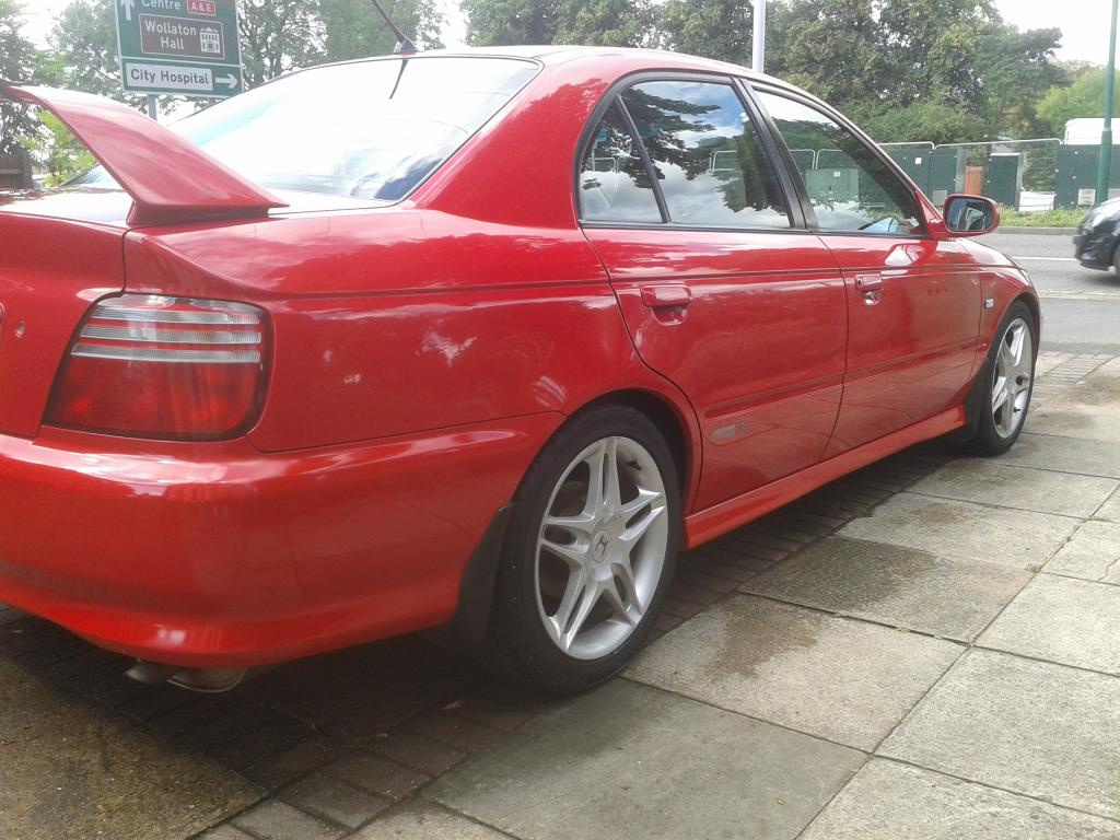

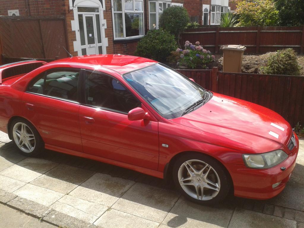

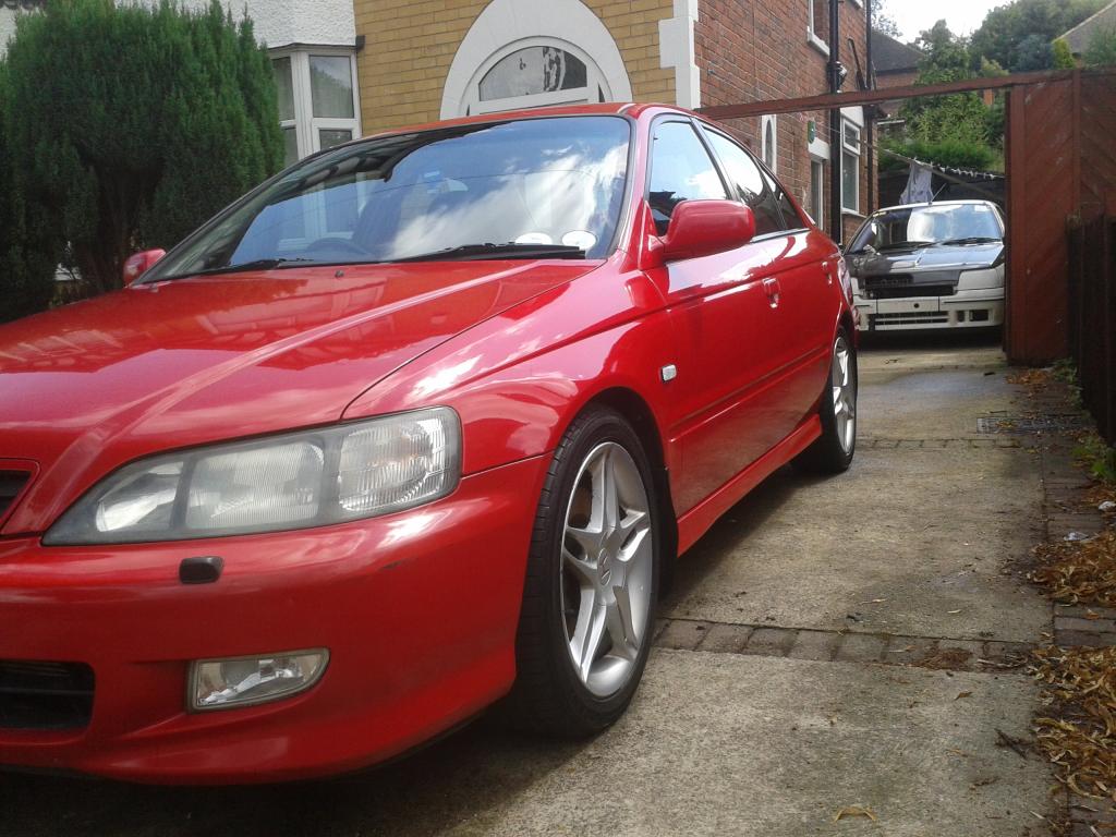

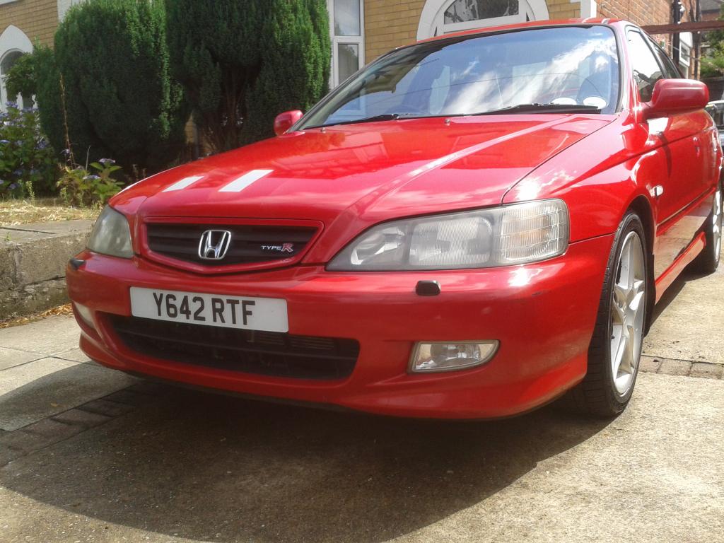

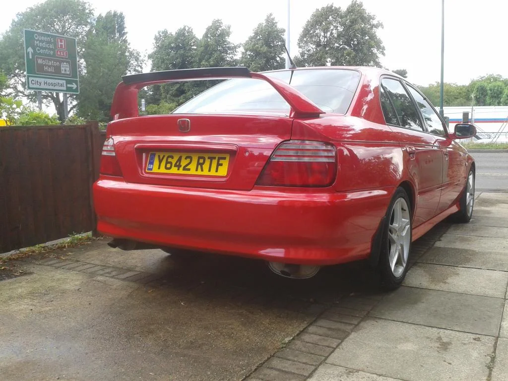

I've been after 1 of these for a while now & this 1 came up for sale at a price I couldn't afford to say no to.
Picked it up over the weekend & it has a few unusual goodies on it like a bose stereo & climate control from the type v, it's also got leather door cards, electric rear windows and remote boot opening.
Also came with 2 sets of spare wheels, 1 standard set with bridgestone semi slicks & some prelude (I think) wheels with winter tyres. It's mechanically rock solid & was meticulously looked after by the guy I bought it from, who also fitted all the non standard toys.
Drove it home & took the scenic route along the snakes pass
It's supposed to be my boring daily hack but I plan on sorting out all the cosmetic bits & fitting a nicer exhaust etc but that's after I've got the Clio fixed & back out on track with more power and a gripper diff :evil:

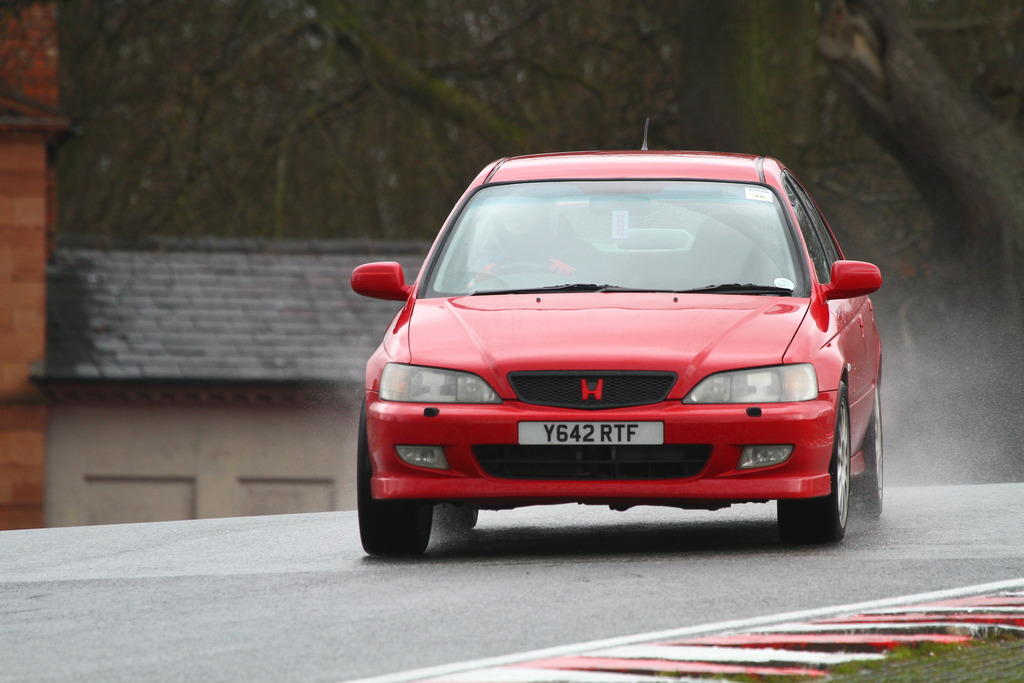

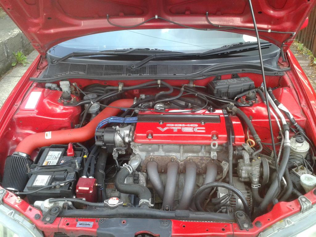

Looking back on my short stint of ATR ownership so far, I've done quite a fair bit to it so I thought it'd be worth collating it together
How it all started, with a bit of a scabby front end but mechanically good
Several months of pretty much hassle free motoring passed with only fitting new brakes at the back and having to do the lower ball joints to then be faced with the exhaust falling off a week before a trackday :evil:/>/> which forced me to get a new 1 made up sooner than I had planned for

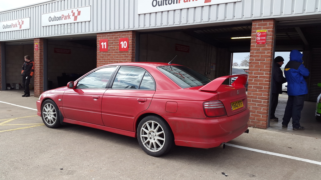

Had an enjoyable day at Bedford in November
Unfortunately the day after the trackday the clutch shat itself but it had to wait as the car was booked in to have all the paintwork sorted out. Bonnet, wings, mirrors were done along with both bumpers having pre style lips fitted :D/>/> There's still a couple of other bits that need doing but I couldn't afford to get them done because of the exhaust problem :roll:/>/>

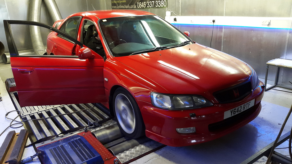

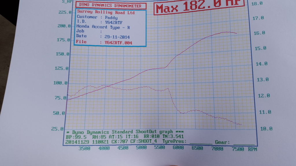

I then had a bit of a disappointing day at Surrey Rolling Road :(/>/>
Cause of the pig rich fuelling was the K&N cone filter being clogged up with crap from the front end being painted :oops:/>/> I binned it & got a Ram Air filter instead then logged the AFR's & they're back into the 13's so should make decent power next time I get it on the rollers
All that followed by a day at Cadwell Park at the beginning of December

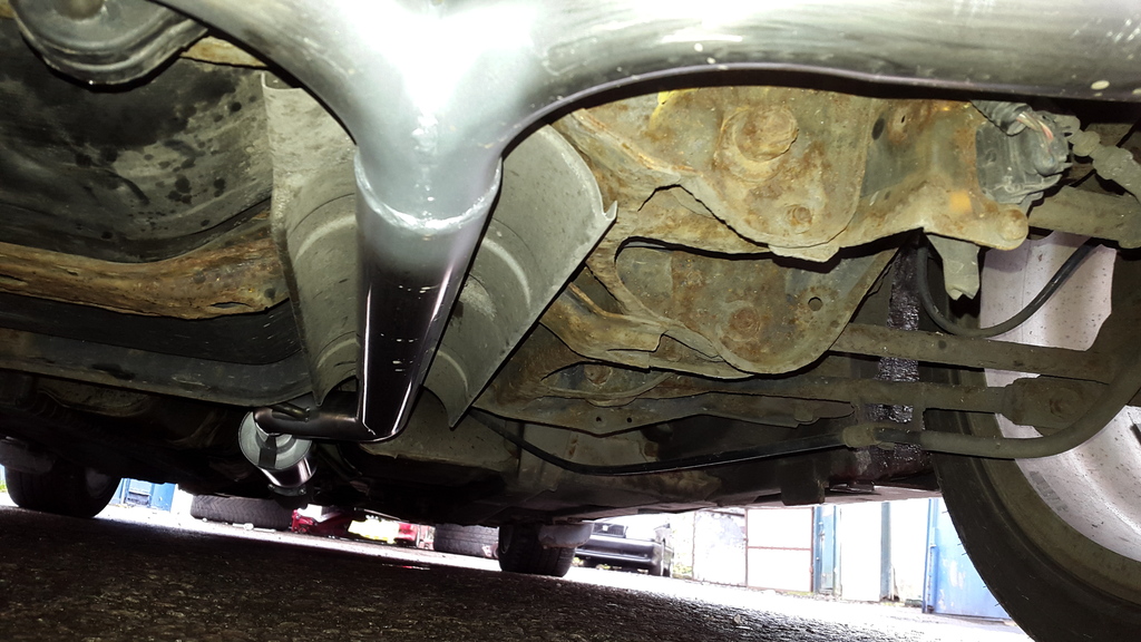

December and it's usual weather meant that the winter shoes were then fitted, winter tyres & LSD are a revelation in the snow & I was able to drive anywhere at pretty much normal speeds in the snow :D/>
Into the new year (well March to be exact) thanks to a fellow ATR owner I know from a Volvo forum I got a set of RSR's & fitted them to the track wheels I've had for bloody ages

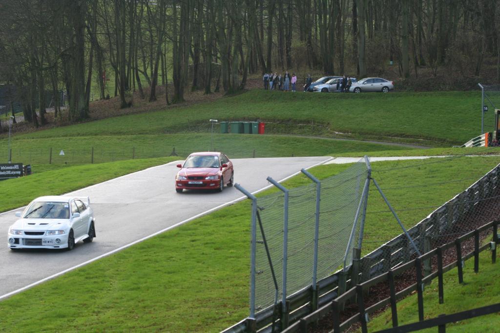

Then did my 1st trackday of the year
Overtaking a Caterham y0!

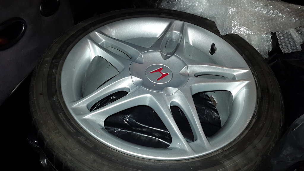

and to round off the update I've had my standard wheels refurbished
The car needs a bit of tlc in the form of new brakes up front & a bloody good clean after Oulton so I'll fit the fresh wheels then but now all of my efforts need to go into getting my proper track car fixed & back out to play

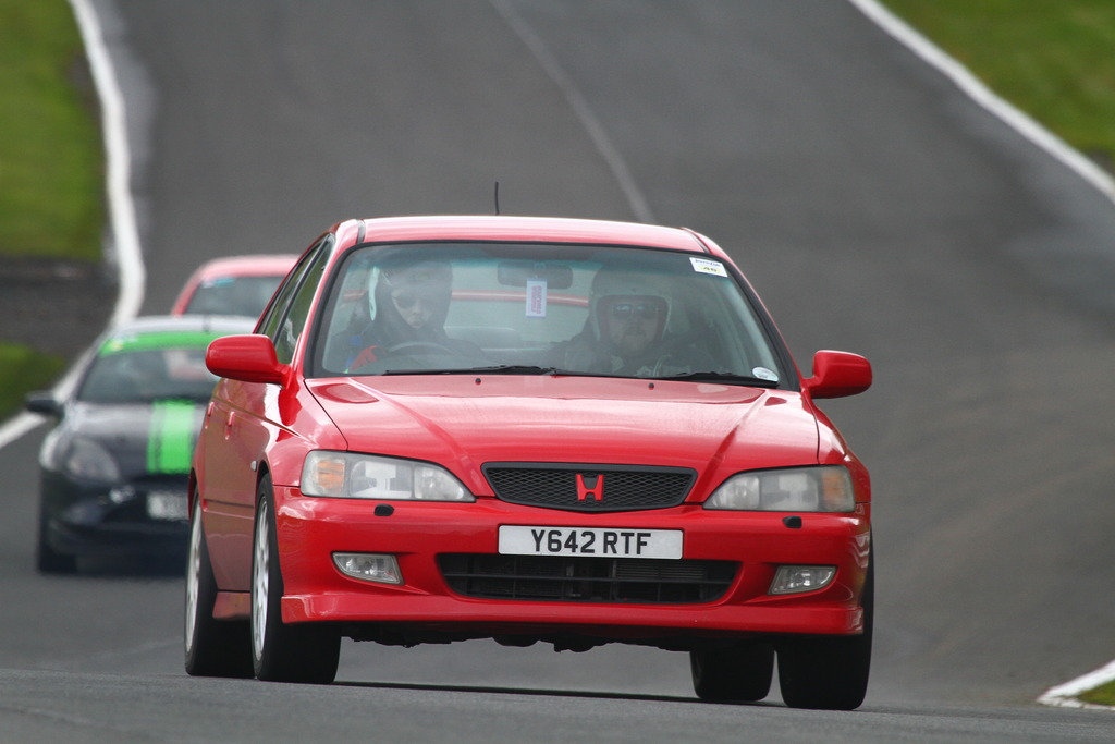

Time for a little update.
I failed to get my track car ready for a trackday at Castle Combe back in June so ended up taking the ATR. Because 2 of my semi slick tyres were buggered I eneded up taking just 2, fitting them to the front and putting my most worn Potenzas on the back and all I can say is that I was finally happy with how the car handles.
That little bit more grip up front compared to the back made all the difference making the back end of the car move around a bit more & I loved it

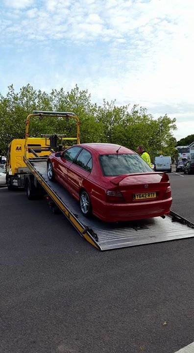

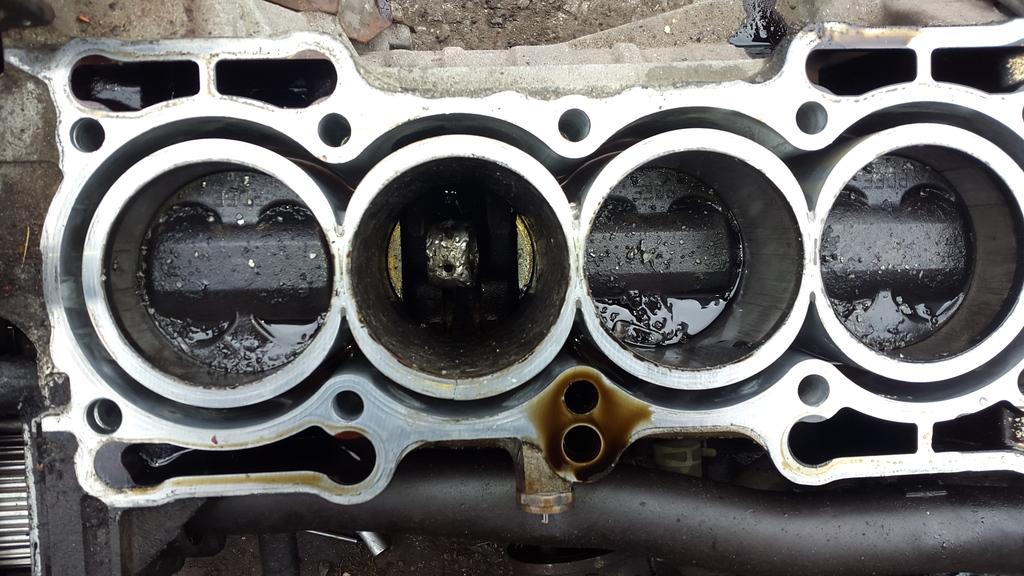

Unfortunately around lunchtime things went south rather quickly
That cloud of smoke was the engine letting go. Very odd circumstances as well, for those of you familiar with Combe, it happened at Folly. I was flat out in 4th gear & starting to make the turn when there was a loud crunch followed by what can only be best described as though I'd put my foot on the clutch and with my foot hard to the floor the engine then revved it's nuts off & cut out.
I managed to get the car just past Quarry & pulled up on the grass, right next to a massive Honda advertising board of all bloody things and to top it off it took ages before they red flagged the session to recover me so had to suffer the humiliation of 1 particular former ATR owner driving past me 5 times pointing, laughing & calling me a wanker or variations of it although to be fair to him, on the 5th time around he just shrugged his shoulders as he'd run out of ideas.

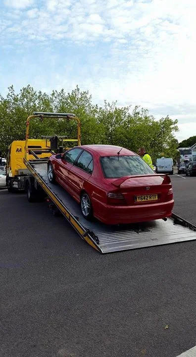

Got a tow back to the Hotel I was staying at & called the AA. I knew it was fecked long before they showed up, the engine wasn't seized as such but would only turn so far before locking solid. The AA man said snapped cambelt. The way it went also made me decide not to piss about & go for a replacement engine and box.
Got the car home & dumped it in my lockup, took the cam over off just on the off chance the AA man was right but the belt was still intact so it got dumped whilst I got some overtime in to pay for everything

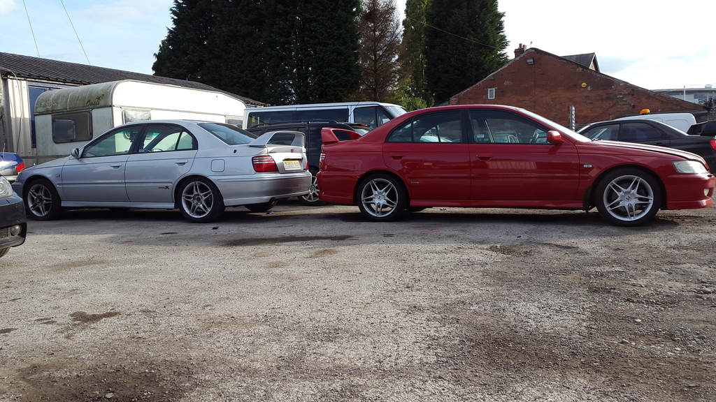

Nothing much got done through most of August as I was awaiting delivery of goodies for the new lump. The main wait was for a delivery of a balance shaft delete kit & manual tensioner from H-Tune. It took a while as they were waiting for their 1st batch of stock from Kaizenspeed to make it's way here from the states. Also got myself a lightweight flywheel

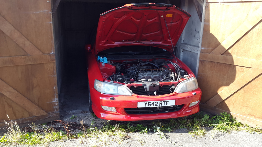

So last weekend, the car saw daylight for the 1st time in almost 3 months & I got it moved to my mates workshop to start ripping the engine out

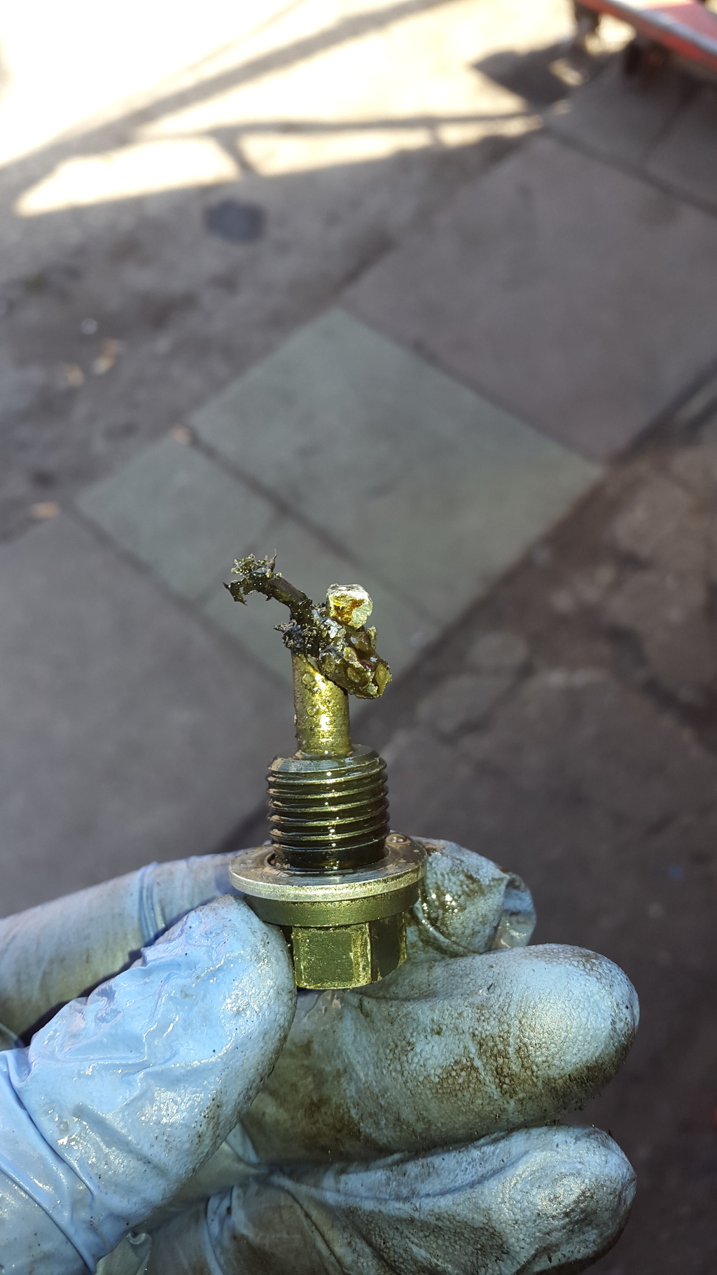

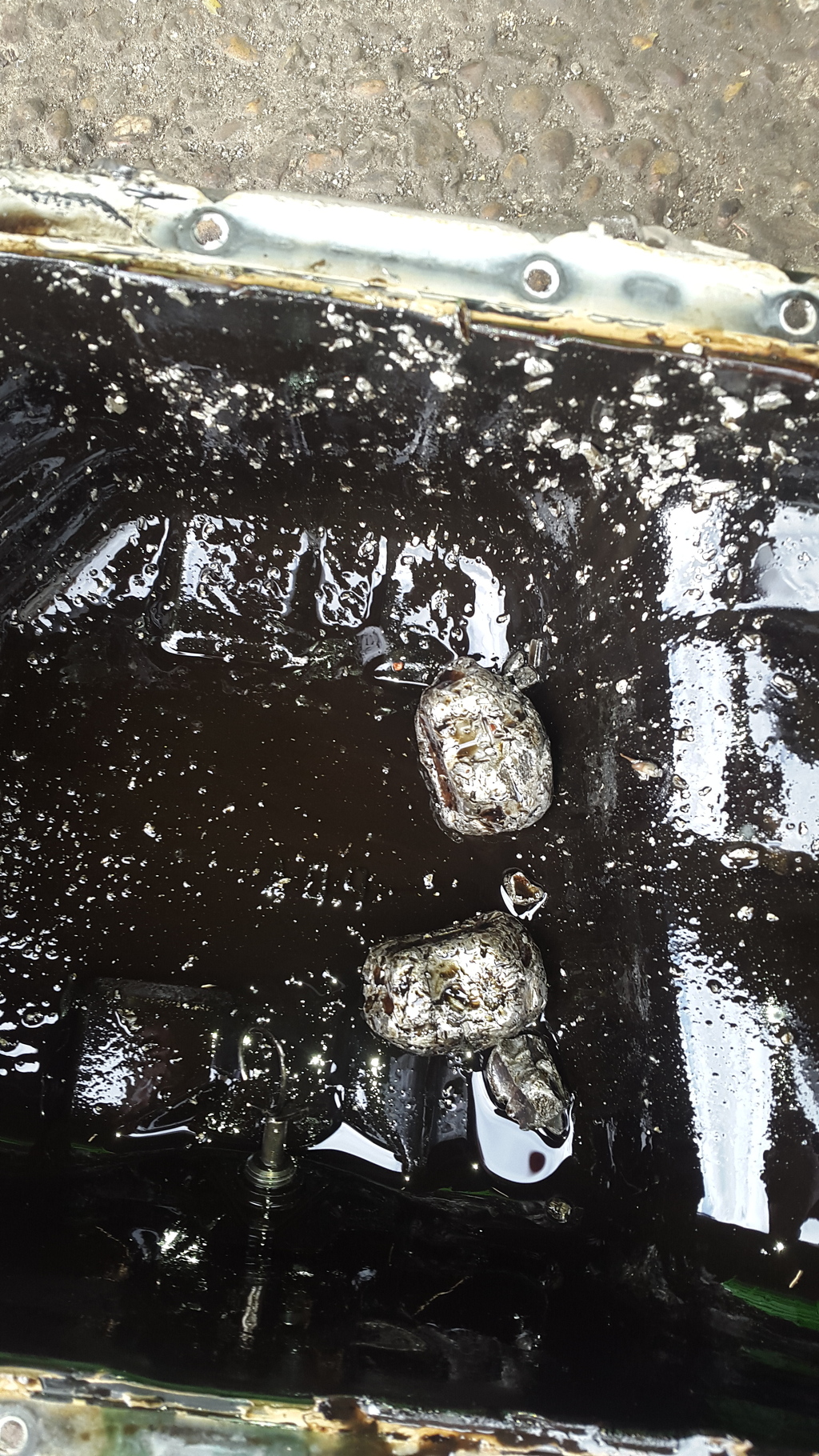

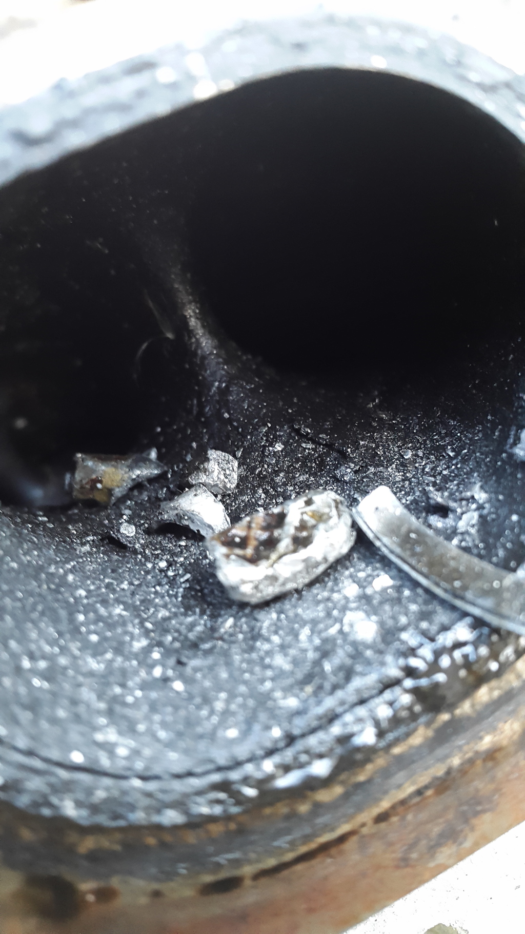

1st job was to drop all the fluids. My car has a magnetic sump plug & when I undone it I was greeted by quite a lot of water which seemed odd at the time, then came the oil followed by a bit of light being shed upon what damage I'd done

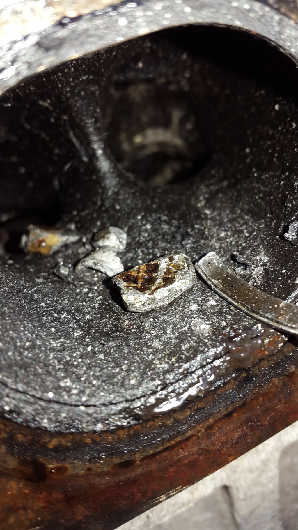

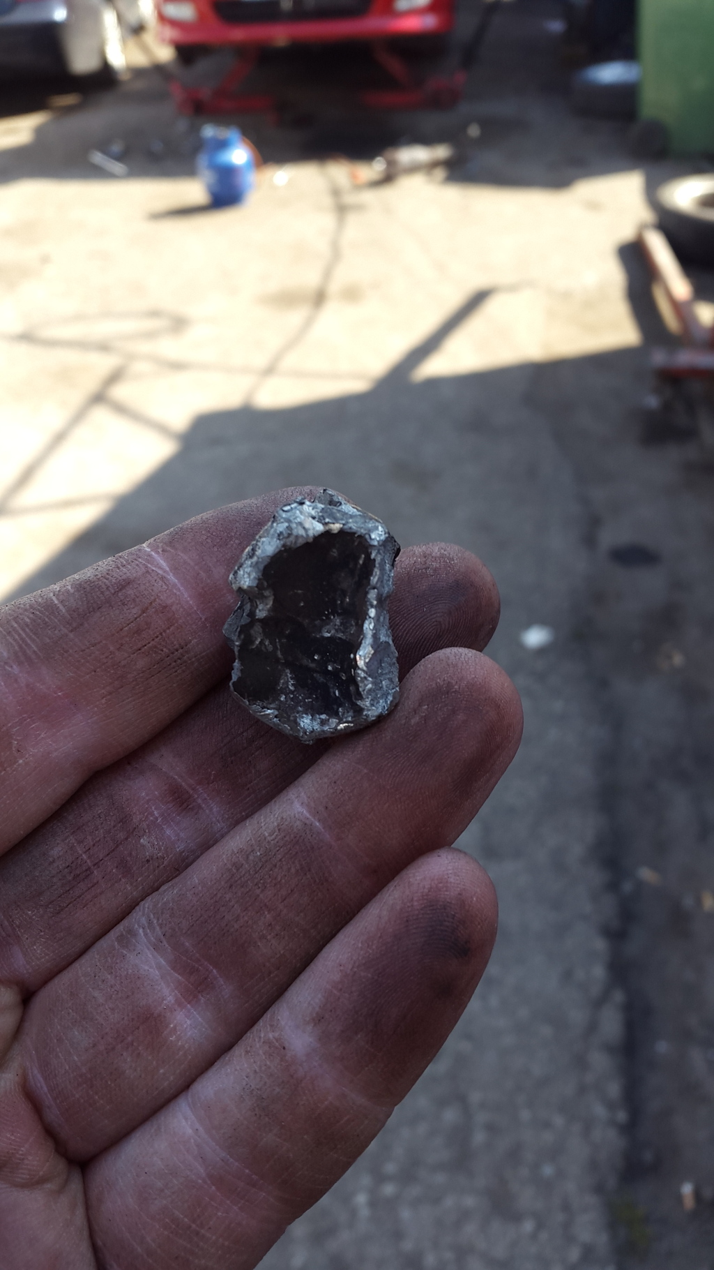

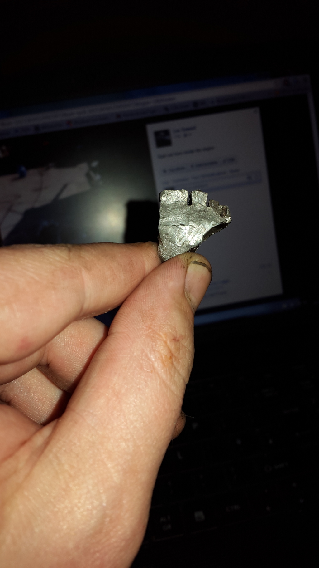

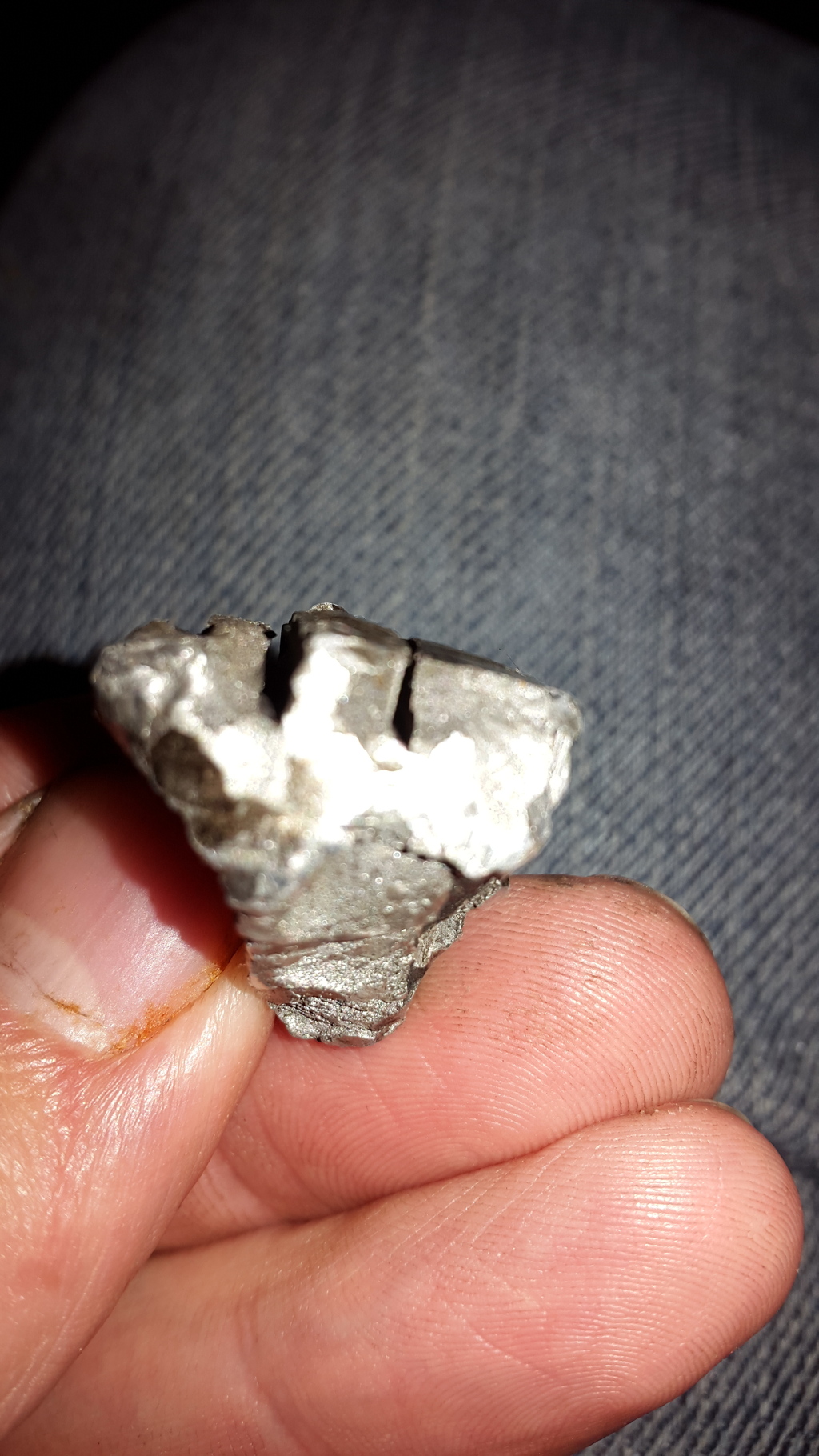

Once I'd got the downpipe off, I crawled out from underneath the car, grabbed the downpipe & heard something rattling inside & I thought oh balls I've dropped a bolt in there

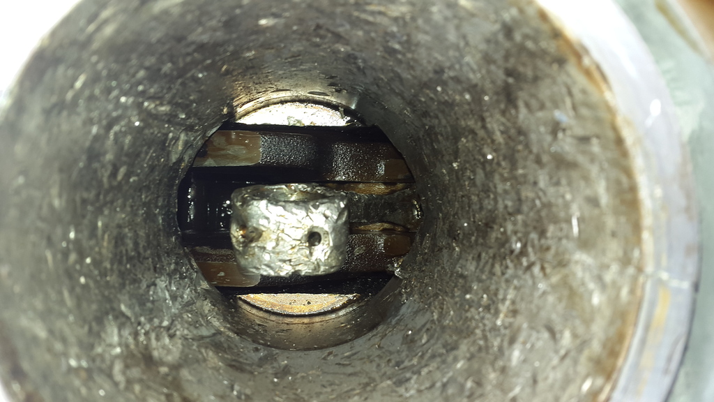

Tipped it over to be greeted with this
Closer inspection of the grooves here shows this was part of a piston had been spat out of the exhaust port

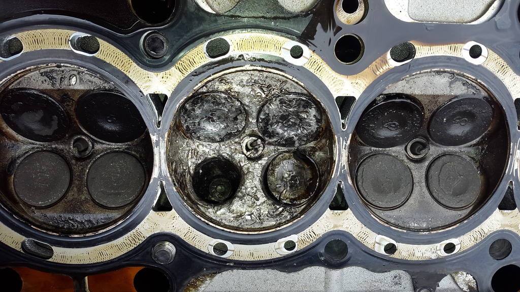

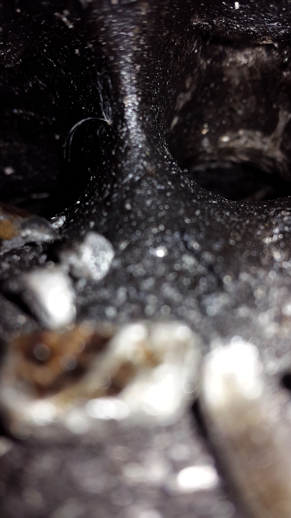

Whipped off the exhaust manifold to get a better look inside
Om nom nom nom nom nom nom said the engine to the exhaust valve

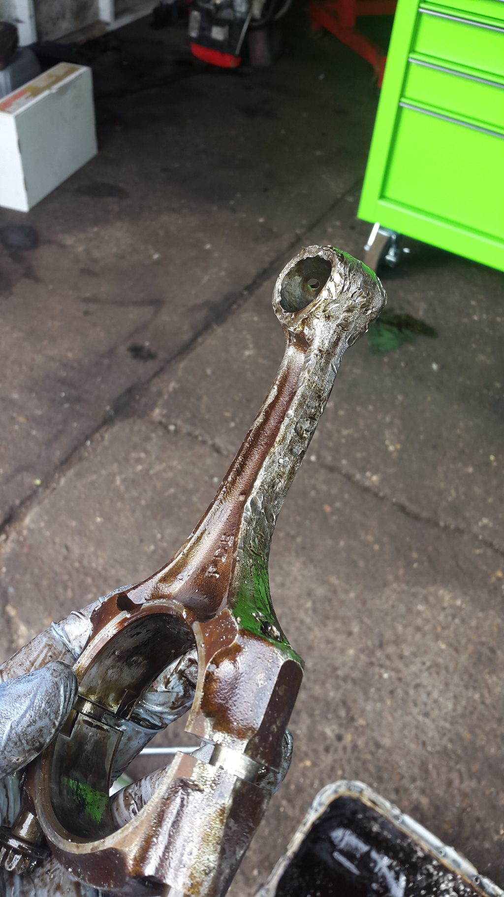

16v_paddy
  Valvers & 172 Cup
Head off

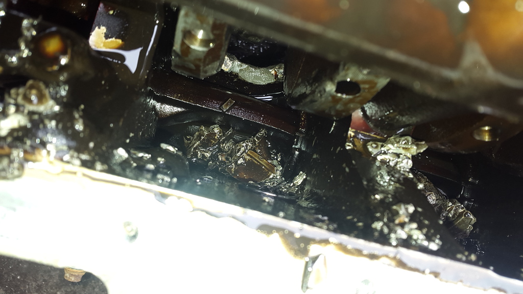

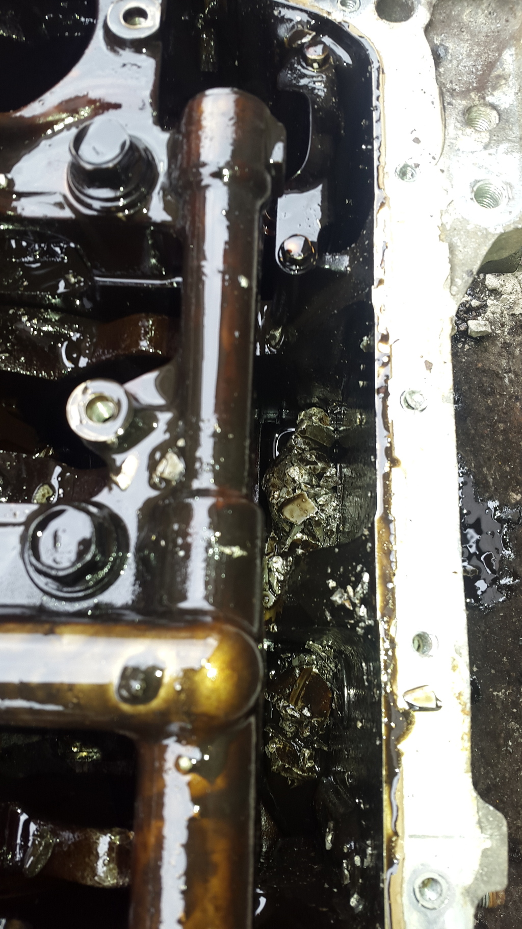

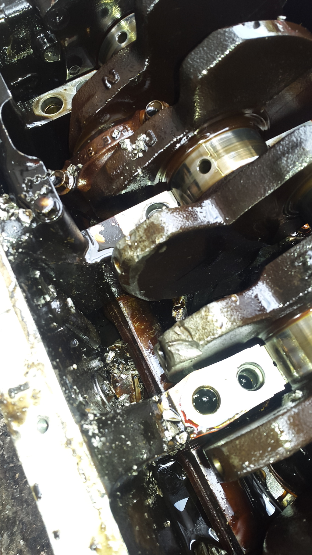

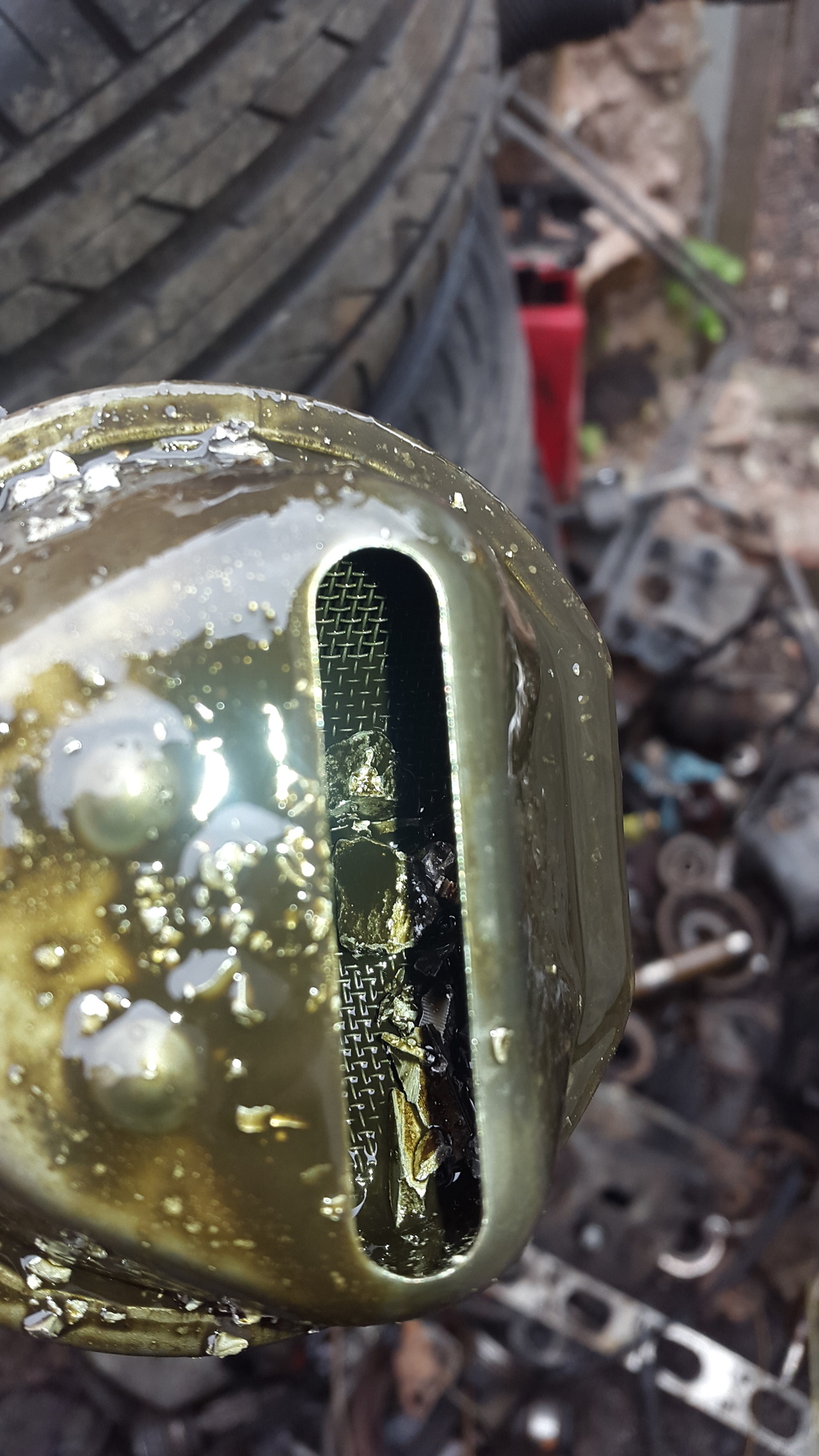

Thankfully the mesh filter in the oil pickup did it's job & stopped any piston debris from getting into the rest of the engine & causing any more damage

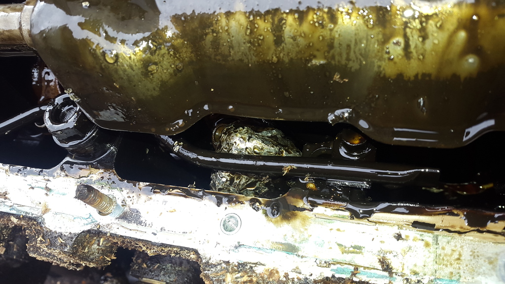

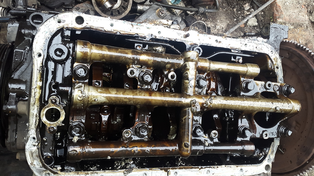

Sump off

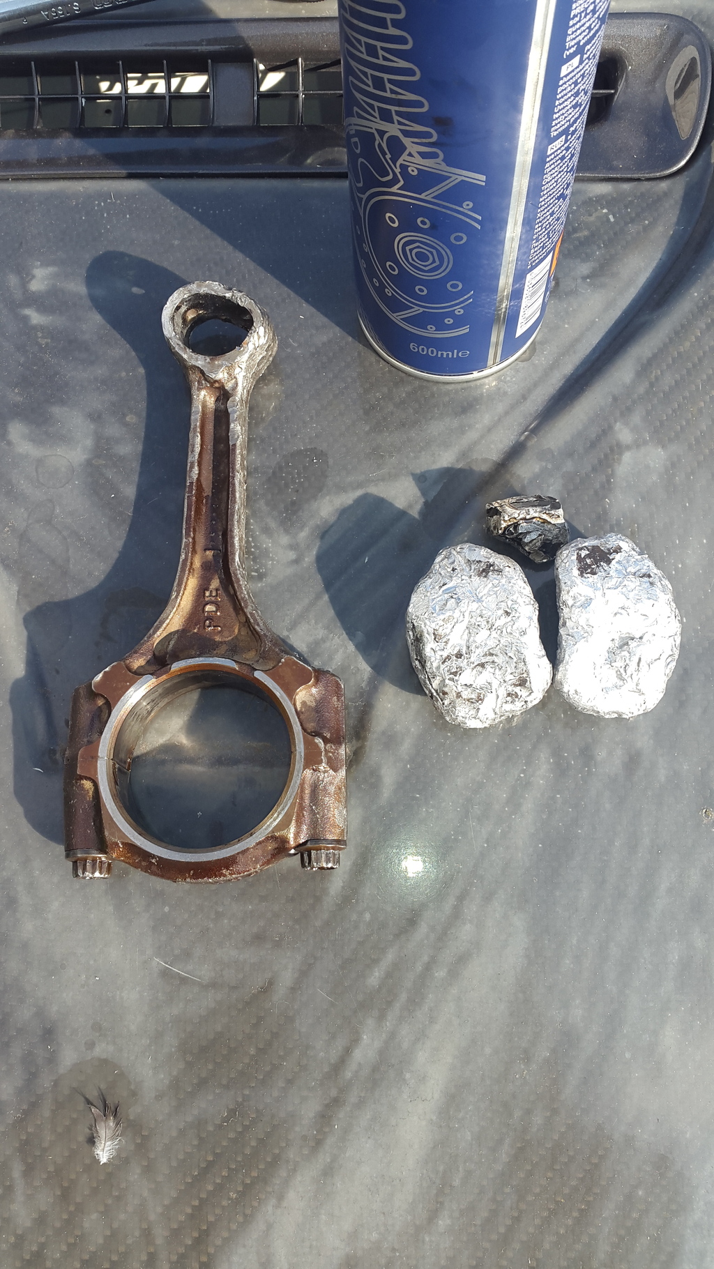

The only 3 pieces left of what was once a piston & 1 of those big lumps was wedged between the block & crank which solves the mystery of why it would only turn over so far & lock solid
Another bit of dead engine memoribilia to add to the shelf of engine death in my garage. Honda supposedly managed to build umpteel million VTEC units without major failure until I get into them, I'm quite proud of how much damage I managed to do especially as it did it whilst the car was being driven properly
