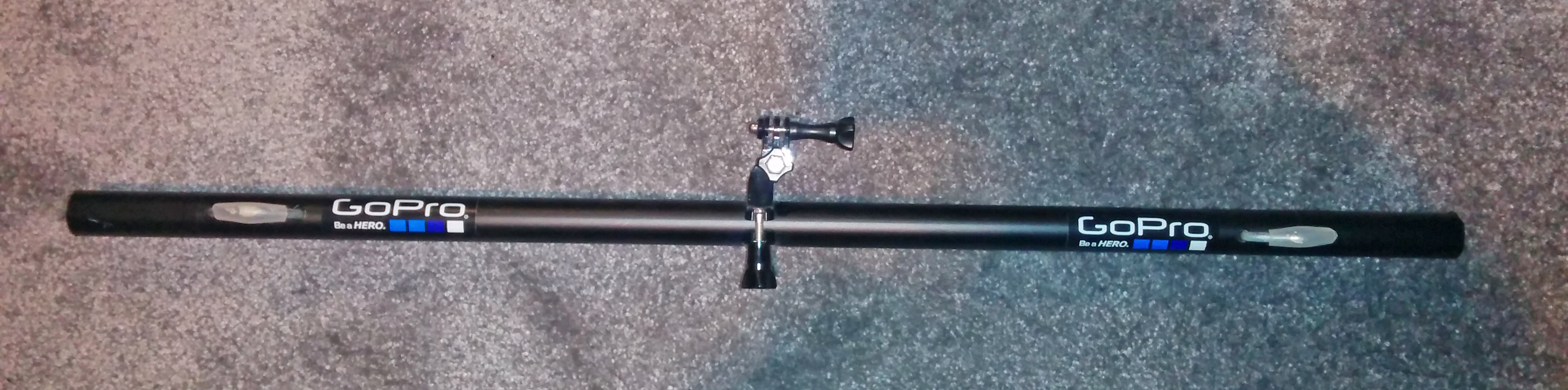

I use the u-bolts to clamp around the two headrest posts, with two holes on each side going through the 25mm round bar and wingnuts to secure it.
I think it's a lot more stable than the headrest posts slotting through the bar itself.

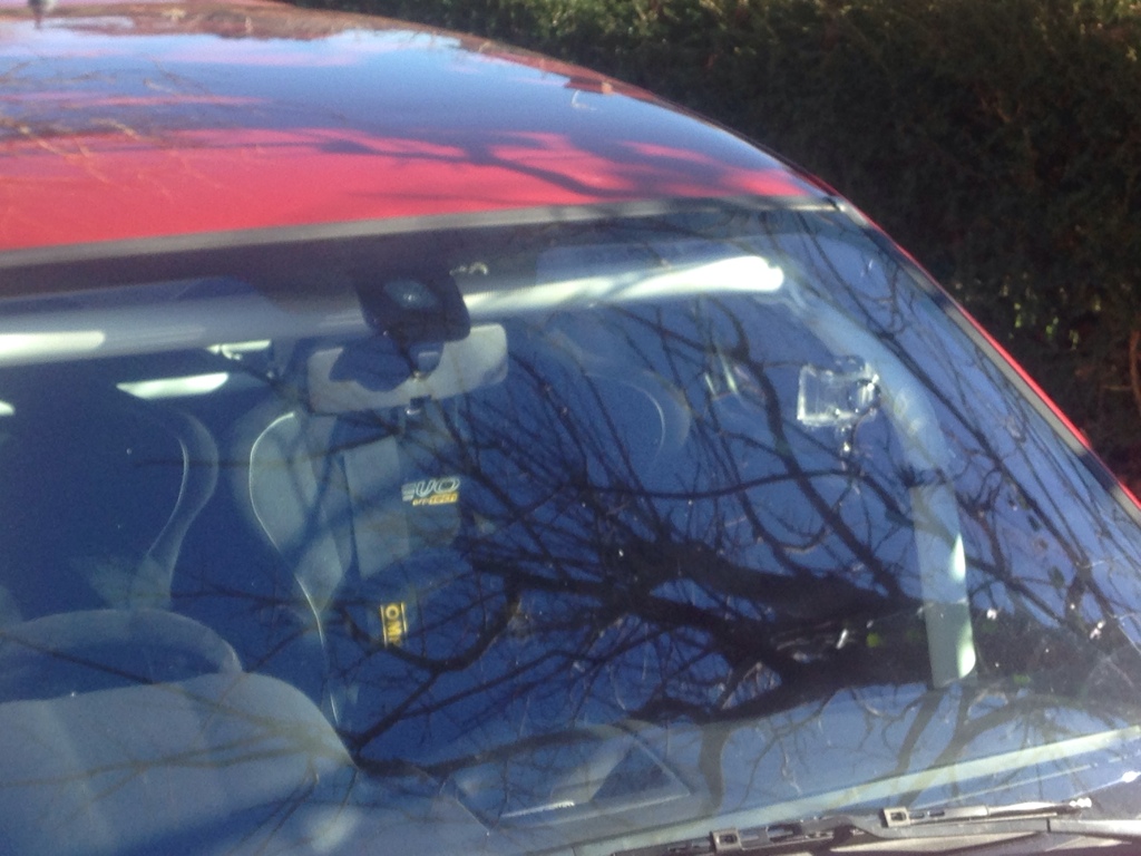

This was mine as of today;
I'll see what the video looks like tomorrow, then move if necessary.

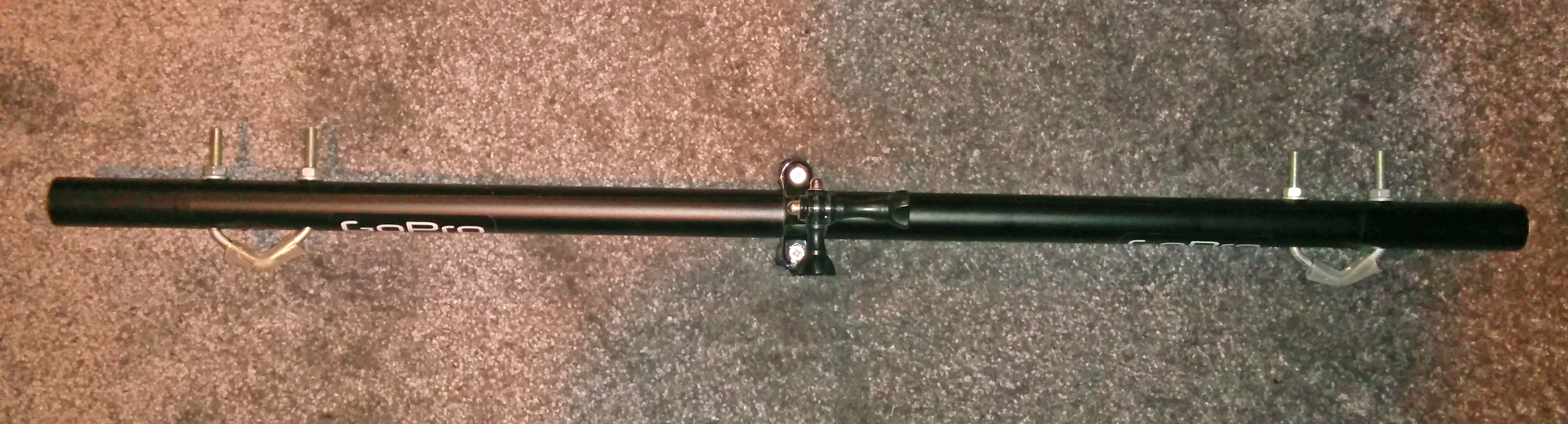

This is my bar mount. That help?
It mounts between the two seats using one headrest post off each, but the same could be used to mount it off one seat using both it's headrest posts.

@JamesBryan I was going to build something similar but I hit a bit of a stumbling block with the u-bolts, they seem to be a nightmare to get hold of locally and there's so many different sizes online (I ended up with a tiny test one which is no use to anyone!) did you just get yours online?
Thanks :)
JamesBryan
Thanks :smile:
I actually got them off my mates dad, Paul.
They were ones which are used to clamp TV aerial poles to the wall.
Mine are 50mm wide by 70mm long if that helps. The width could be smaller if you wanted though.
