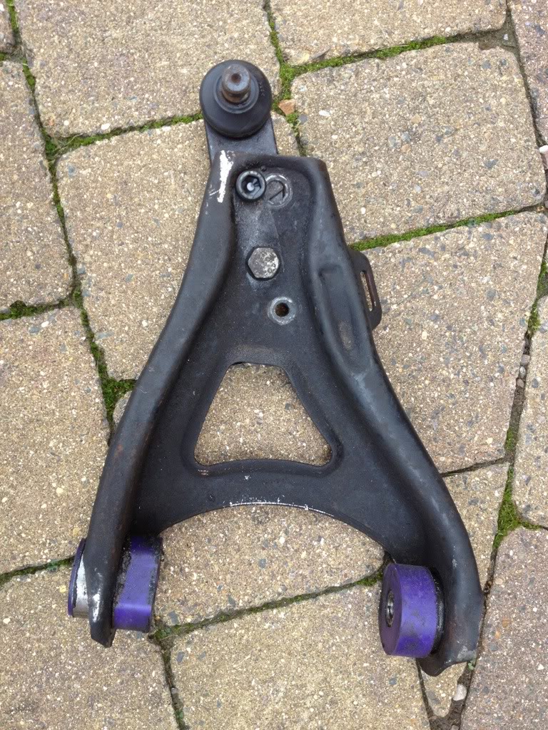

Got caster yo

I noticed a massive improvement with the AST top mounts fitted running full castor. Although i dont think they gave as much castor as you have there!

For going shopping it obviously won't help, but for 'spirited' road driving it's a nice mod
For mainly road use though I would just go cup arms and then not have to worry about making clearance to stop rubbing etc.
What do you have to do to stop scrubbing?

Interesting. Having a set of spare arms around i was going to try this on the weekend but the weather was too good to waste. Out of interest how much weight has this added to the steering and if you have accelerated hard out of a slow corner how much snap is there now through the wheel?

Steering is heavier but only a little as obviously its power steering so not hard work either way.
It doesn't seem to pull around anymore when accelerating off roundabouts etc but if your aren't on the gas and let go of the wheel it has a strong self centreing action. Limited amount of testing so far due to only using it briefly on the road, will know more in a couple weeks as planning to do Bedford and silver stone in it.

Sounds good, you checked to see how much more camber this is giving you on lock? I should expect you would have a fair bit of negative camber on the outside wheel now, should work really well on track and possibly make the car much more stable in the fast stuff with you really being able to load the front end when cornering.

The camber difference when you turn the wheel is really noticeable yes. The inside wheel almost goes positive by the looks of it in fact.

What is it scrubbing on was what I meant to ask? Isit something as simple as the arch liner or more then that?
Just the plastic that surrounds the driveshaft.

I think this is an interesting thread, I know touring cars ran massive castor to fix some of the inherent problems with Fwd.

Last night was the first time I got to take my car round some twistys i know well, since fitting the cup wishbones. The difference is amazing. The steering feels so pin sharp and the turn in is awesome.
Considering you can get a set of Cup wishbones from RenSpares for £35 delivered, I think this mod is a no brainer!

Agreed, for a really easy mod without all the faffing about we did on mine, just bolting on a set of secondhand cup wishbones to a phase 1 (or even a non cup phase 2 TBH) is a great way to get a large portion of the gains for utterly no effort and very minimal cost.
Can you order me a up a set of new cup wishbones for my Mrs 172 though when you are next at renault, as I'd sooner have new standard bushes on that car than polybush it as its a daily first and foremost and only a trackday car second, but I'd still like the extra caster ahead of our ring trip in six weeks and Ive got some time free next week I can fit them and get it tracked etc.

How did you decide on where to position the outer hole? Did you simply push the hole as far forward as possible in line with the original then elongate the inner hole to accommodate this?

Slightly to much for the chassis, going to need to move it back slightly as its hitting too much on the inner wings. More than can really be ground or hammered out the way.
