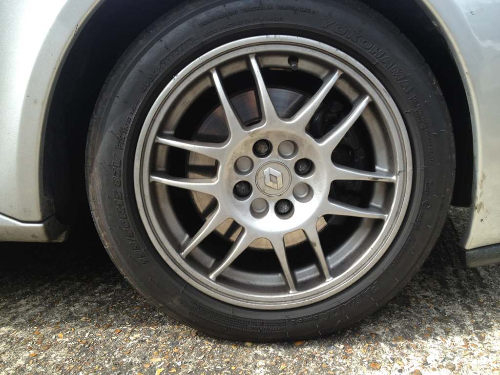

Do you have any pics of side wheel view, would like to see how far forward the wheel goes. I take it Mike has no rubbing issues Chip ?

Roughly speaking its about 2 degrees extra for the cup wishbones and another 2 degrees for the way that I did it.
We havent had them both on the same car though and obviously things like front versus rear ride height etc effects the figures.
The problem with the ones I did is a lack of clearance, but if you are cutting out the excess weight on a racer, you'll no doubt not mind that, so I would go with doing it that way.

Nice idea, not sure how much caster I'll be able to get with my strut towers but if I need/want more something along the lines of what you've done is defo the way to go.
Where exactly was it catching? bracket at the edge of the wing/bumper or just rubbing on the inner wheel arch in general?
Rubbing on the inner wheel arch in general at the front (liner is already removed, I mean on the metal work)
You can hammer back a few of the bits it catches on, but ultimately the whole lot would need cutting out if you want lots of caster and to run very low.

Without looking through the entire thread, have you done anything to your bumper brackets, as mine on standard caster, but lowered on generic coilovers around 45mm causes rubbing on hard turns on track?
