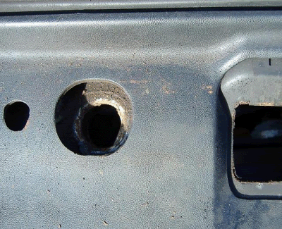

look for that bit^ (just under the grille in the middle where the catch goes into, then there are 2 x 10mm bolts to loosen so you can adjust the position of that bit so the catch sits properly in it
you are looking for this:
the part above is underneath that part of the grille

Wll I put washed in between panel and catch. Bonnet now flush. But still don't pop open unless some 1 pulls bonnet
definitely mis-aligned
This mate
Like I said adjust that bit, best way is to loosen the bolts so the part moves freely (but keep the bolts in) then drop your bonnet shut, it will self locate, pop your bonnet, tighten bolts, and check to see if its working properly
Then if needs be make fine adjustments until the bonnet pops up when you pull the lever, but stays shut when you shut it
