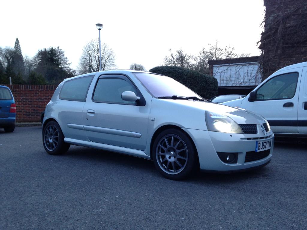

Cor those wheels look good!
I have to say I'm ruddy chuffed with them. Must resist putting them on until the weather gets better!
Best DCI ever, period!!

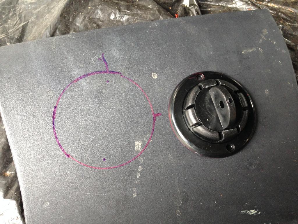

Decided to have a break from coursework for the afternoon and managed to get a couple of bits done on the car. First was to fix the horn which turned out to be a fuse.

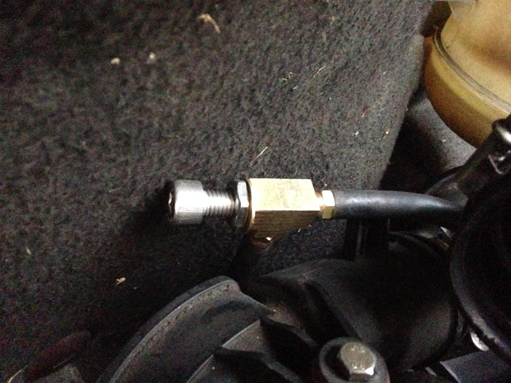

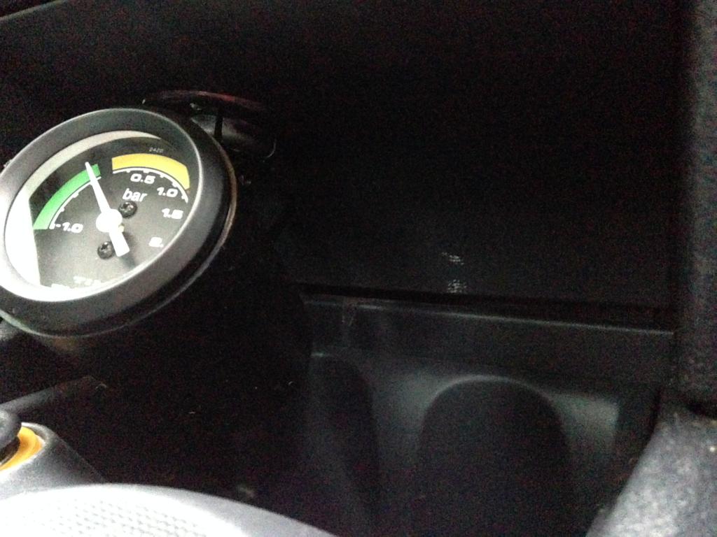

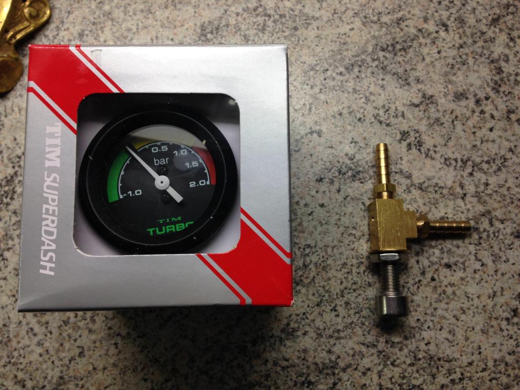

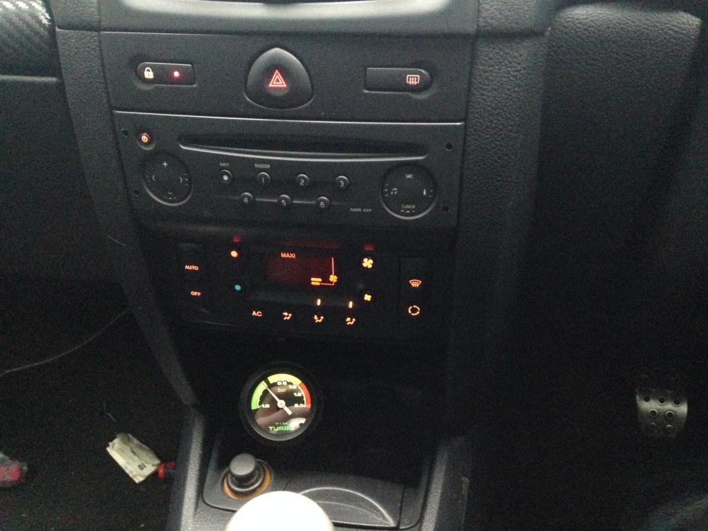

Next was the boost bits I got earlier on in the week. In the video showing the car over boosting you can see the gauge isn't mounted properly so I went about fitting it like this. Worked very well, especially the little rivets although I need to move it over just a touch so I can get in my "cup of tea" flask

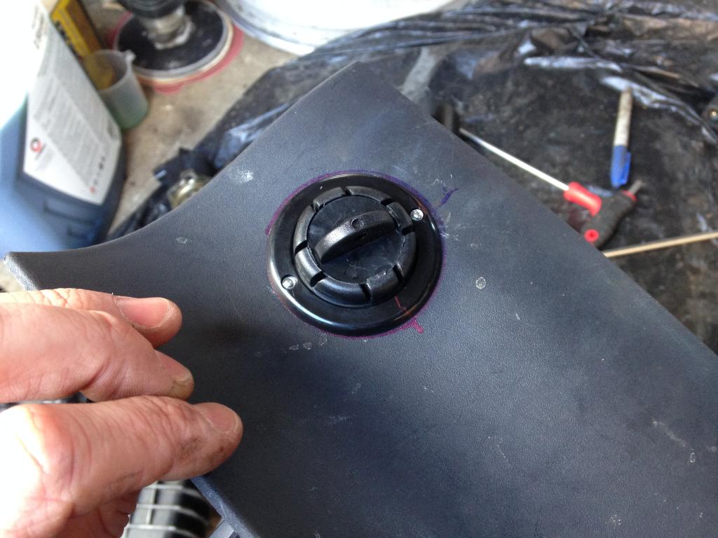

After the gauge was done I moved onto the boost controller. Very easy install and set up. Took me about 20 minutes from start to end. After turning the boost down 6 times I got it to about 1.2 bar without the "oh crap" coil light coming on. No idea if it's faster as I haven't driven it properly yet but time will tell :)

you'll regret the gauage that side lol! i have my egt guage there and its not visable easy when im in 3rd or 5th ....
It's actually absolutely fine because it's not at the bottom of the cup holder. Had thought about that before driving; the german in me (that's a lie). The only section that's a little obscured is where 2 bar is and I hope I won't be getting there soon! During the boost adjustment the 1.5 bar made for a healthy dose of black smoke ;)
I hate coming in here and knowing I can never go sport rep without custom driveshafts :( I do have more power though :smirk:
Quite like the boost gauge down there out the way.

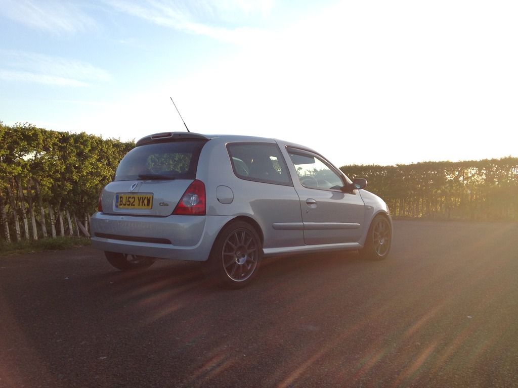

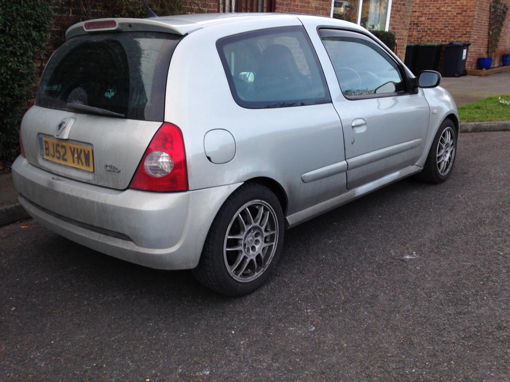

One little sneak preview of what summer will hold. I got the trusty wash and wax out today and BOOM twenty minutes later it was all scrubbed up.
I then decided to put on 2 of the speedlines to see what they're going to look like. Well I'll let the photos speak for themselves. Reckon they look bloomin' lush.
Wheels make a huge difference.
Wanna come wash my car? Its much worse than yours lol
Yeah they do don't they. Still not going on for a while though unfortunately. The car was worse than it looked and came out worse than it looks! Now it's had a few days on the roads though it's now even worse again :/

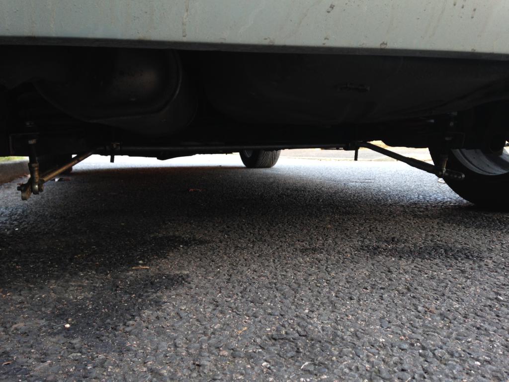

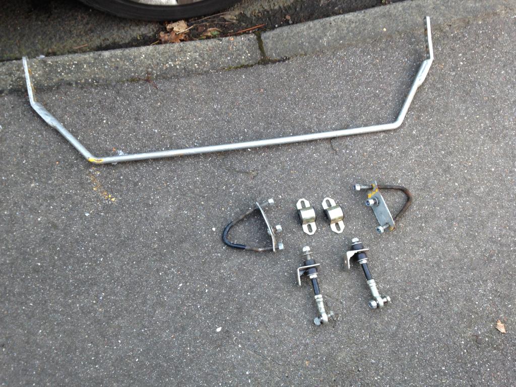

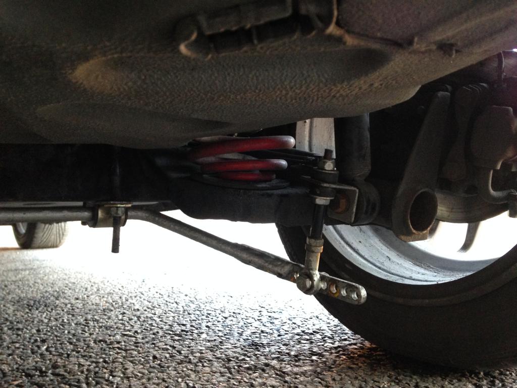

Yesterday I went about fitting the arb I bought from @gudger12345. Have to say it was lovely to fit it knowing all the consumable parts had been refreshed. I'll probably get some boots for the rose joints as I've had them sieze up before with all the road salt. On my 182 I had the same bar on setting 3 so have done the same with this one. Not yet able to fully test it out because the roads are a bit rubbish at the moment but I know it will have made a change for the good.
This is probably the last update for quite a long time as I'm currently looking for a 172 cup/182 summer track car and would rather put some money into that. Of course I'll report back if I get one but my next thing with the DCI is the rolling road day at the start of March.
You have done a splendid job.
Thank you!!
Car looks great on those wheels, isn't the ARB going to catch on speed bumps?! Looks ridiculously low.
Cheers mate. Nah, these ARBs do sit a touch lower than the other ones but they sit quite close to the wheel so don't ever catch anything. Has made the car a lot nicer.

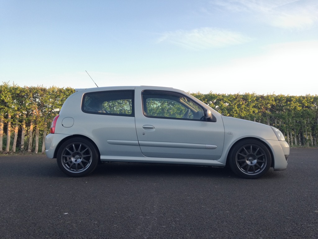

Put the car in summer mode today as the f1s have been on for 6 months now. Turinis do look cool even if I say so myself.

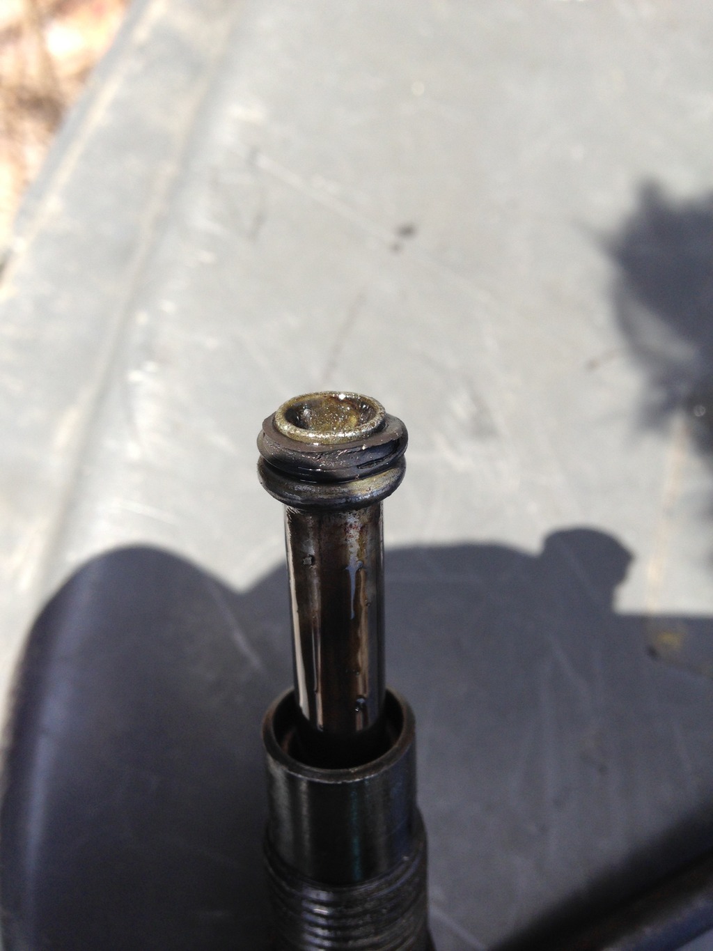

Injector seal broken again

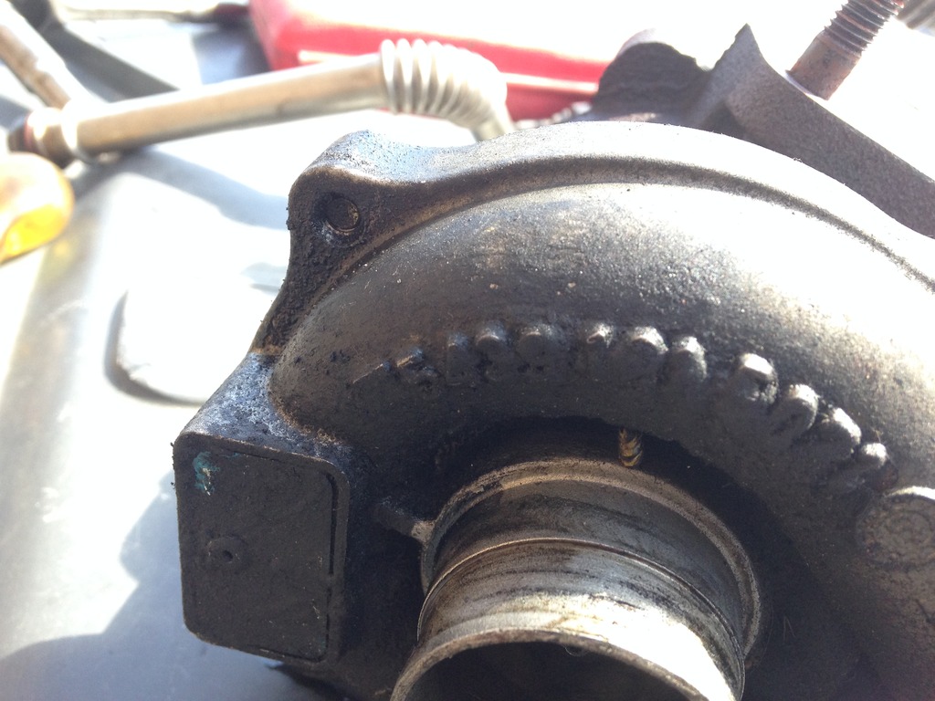

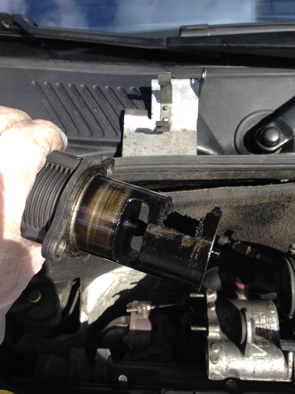

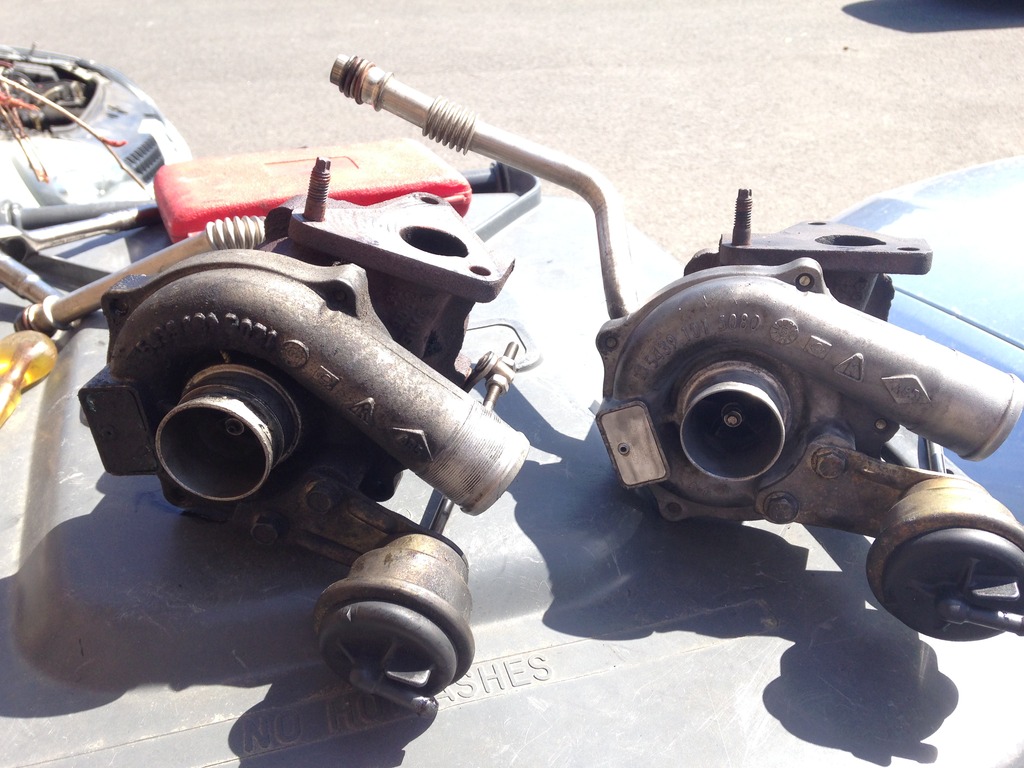

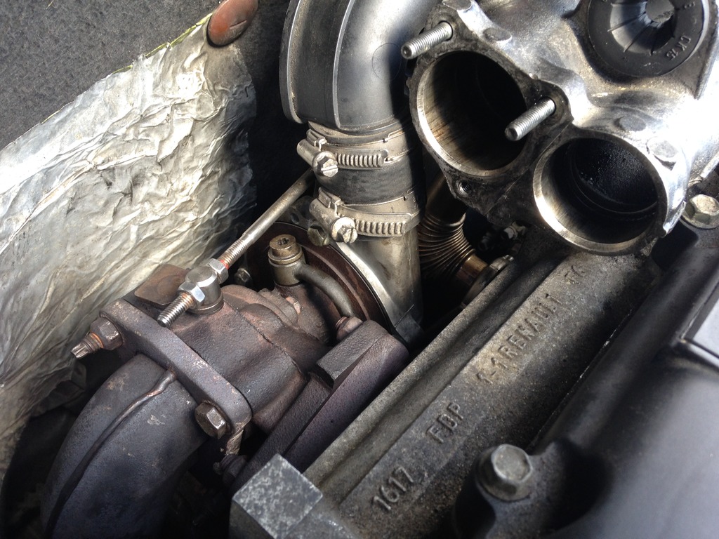

For a while now I've been saying I'll replace my turbo because it's leaking oil like a sieve. I've been having to top up the oil every 2000 miles which has just proved to be a total pain in the bum. About a year ago I bought a rebuild kit from ebay and partially rebuilt a turbo but never finished it after forgetting to scribe a few key things when disassembling. I took a relatively good turbo with only a mild oil leak from the DCI 80 I broke a few months ago so decided to rebuild that one and do it as best I could this time.
I knew the turbo had to be done now as my oil change is coming up in 500 miles, the cloud of smoke from the back had been getting bigger recently and I've got a 3000 mile european holiday in the summer so wanted some shakedown time.
Oil all over the EGR valve
Recoditioned turbo vs mullered one. You can see the leak!
In situ

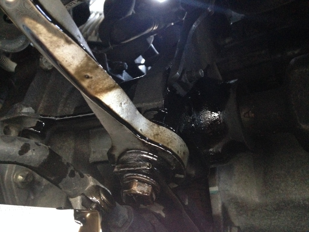

Got the car all back together then disaster struck. I started the car, gave it a rev and could hear the core wasn't 100% balanced despite my best efforts to mark the spinny bits. Worse to come. I drove the car up the road and back down only to find a HUGE puddle of oil pooring from the car and a long line of oil all the way up the road. A quick text to Alex and we established the oil feed at the cylinder head end was leaking like the titanic.
All thanks to this little thing having a split in
Luckily my buddy had a set of o rings and we found a replacement so I am now back on the road but due to the wizzing noise I'm still going to get a new turbo with a Melett core to save hassle. This time around I'll clean the intercooler out to prevent the oil burn off smoke I'm currently getting!

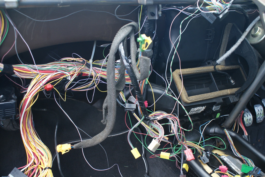

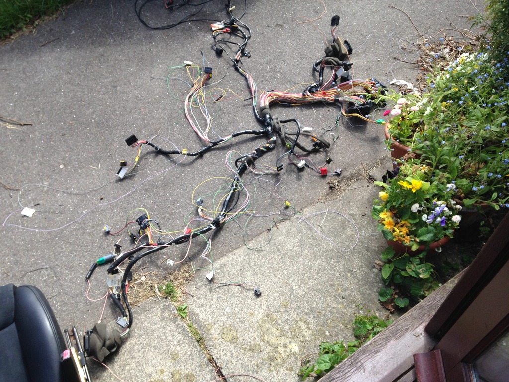

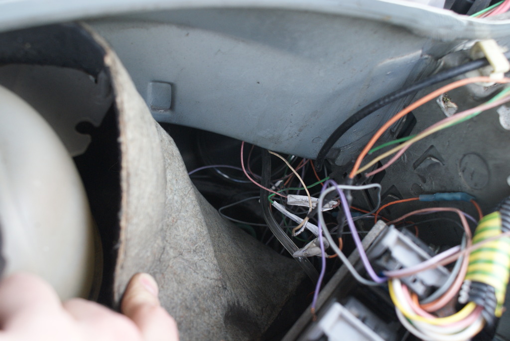

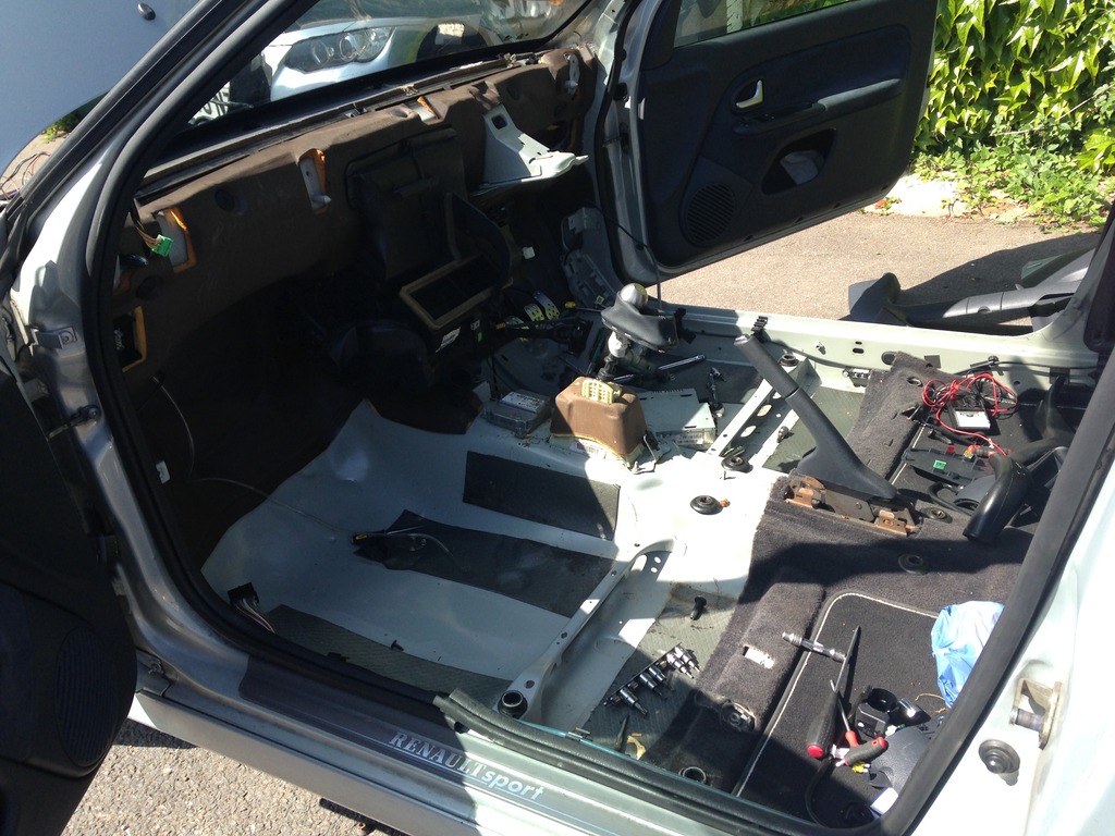

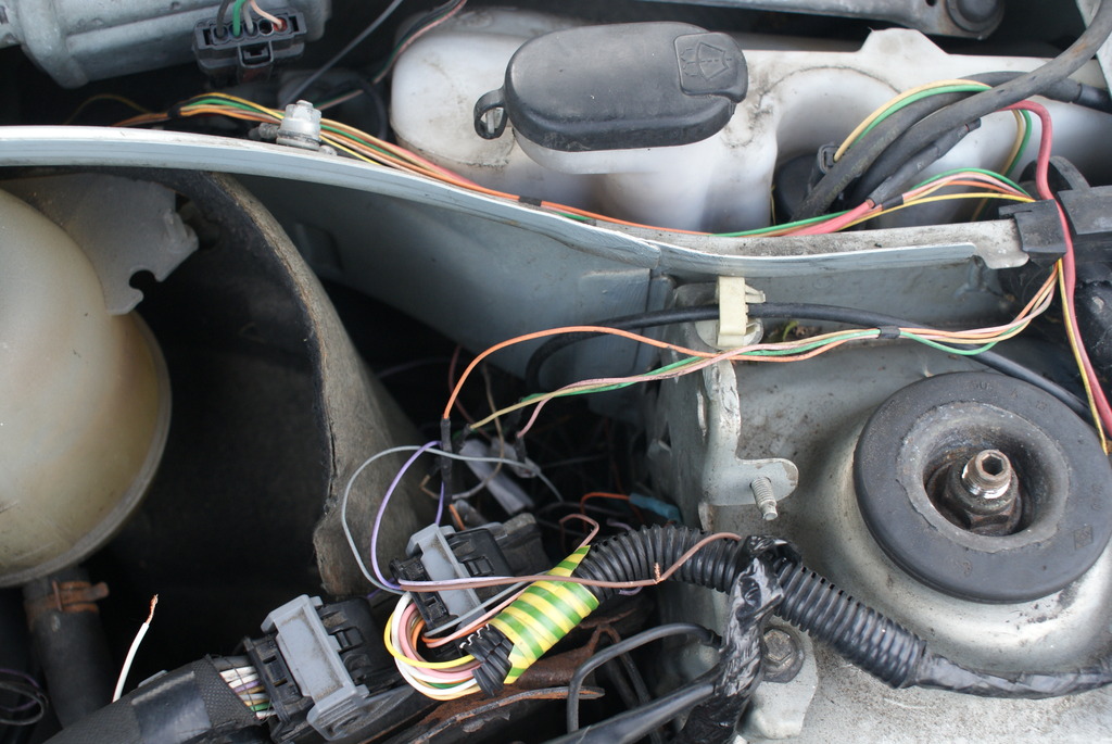

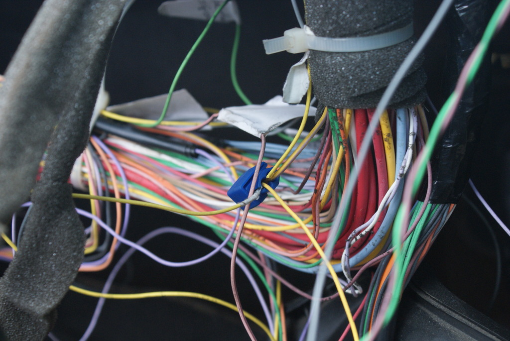

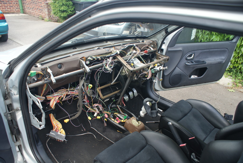

First job was to sort out the awful wiring when I rushed putting the climate control in. @AlexW this looks like your handy work :wink: I'll let the pictures talk from here but you can see it was an absolutely awful job I'd done with splice connectors and feeding all the wires through the bonnet release grommet. It's all sorted now and integrated into the loom through the r107 bulkhead connector.

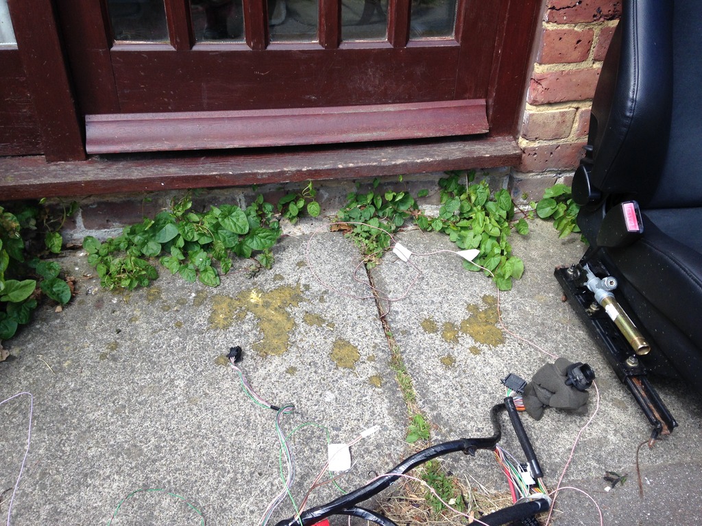

Decided to take the whole dash loom out to sort it out. Unfortunately the car has rear seatbelt pretensioners so nearly the whole interior had to come out to remove the loom.
Biggest bird dump ever nearly got me on the head
Never have I had so many comments from passers by saying "that looks like a nightmare", "rather you than me" etc etc
I ended up integrating the cruise control, rain sensor, clutch switch, update list radio display and climate control. Thankfully it now all works perfectly although I still can't get my A/C compressor to kick in. Some gas will help I'm sure.

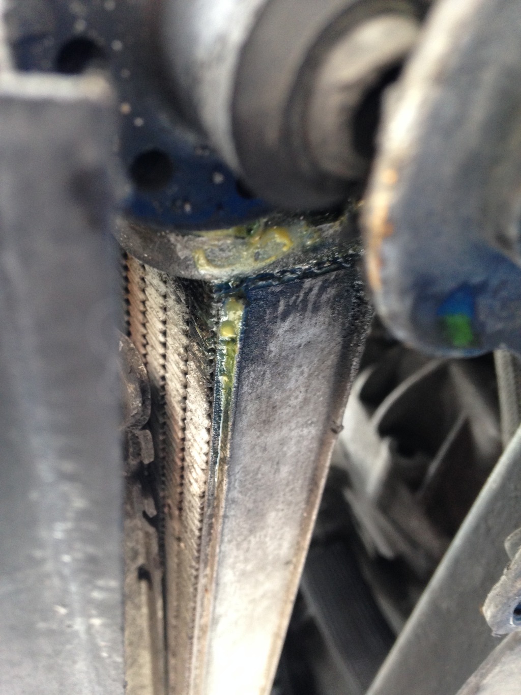

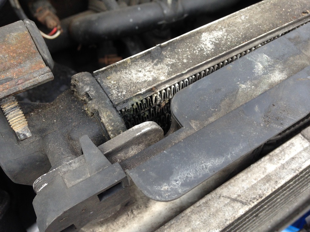

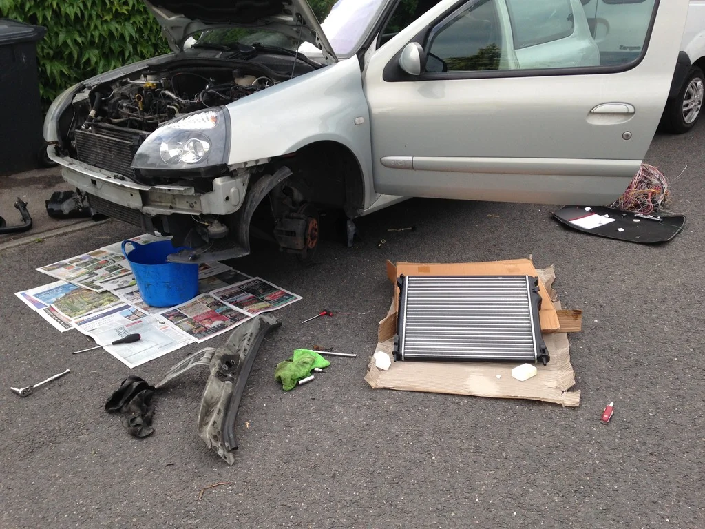

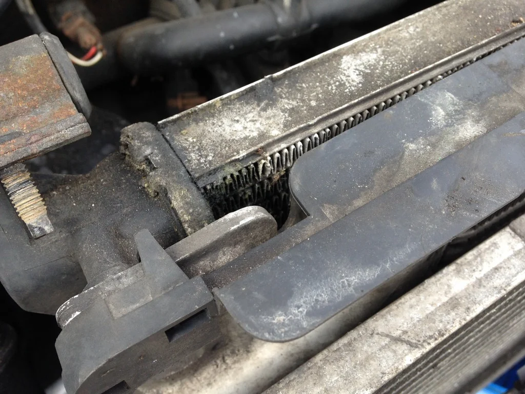

Next came the rad which had been leaking for absolutely ages. It came with an 80 intercooler I had bought a while back but had pin holes everywhere. The new rad is jolly good for £28 inc delivery. Lots of fresh type D as there was hardly any in the car......
This was less than a half an hour job which was rather satisfying.

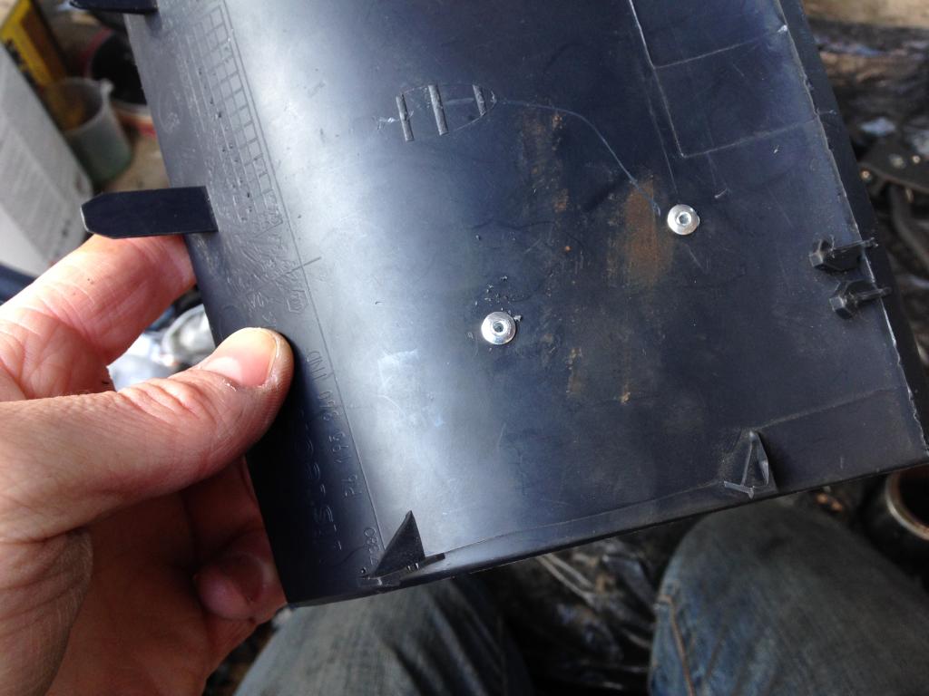

I'd been getting grief from the turinis since I had them refurbed. The wheel bolts would come loose ever couple of thousand mile because there was paint on the mounting surface. Wire brushed that off.

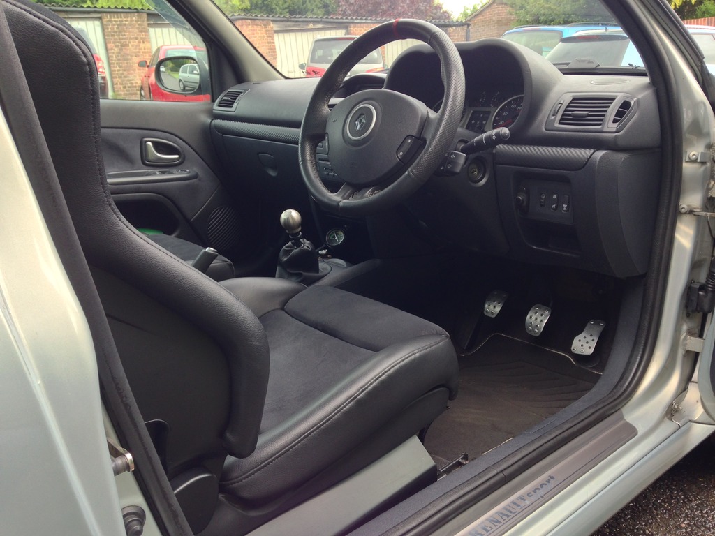

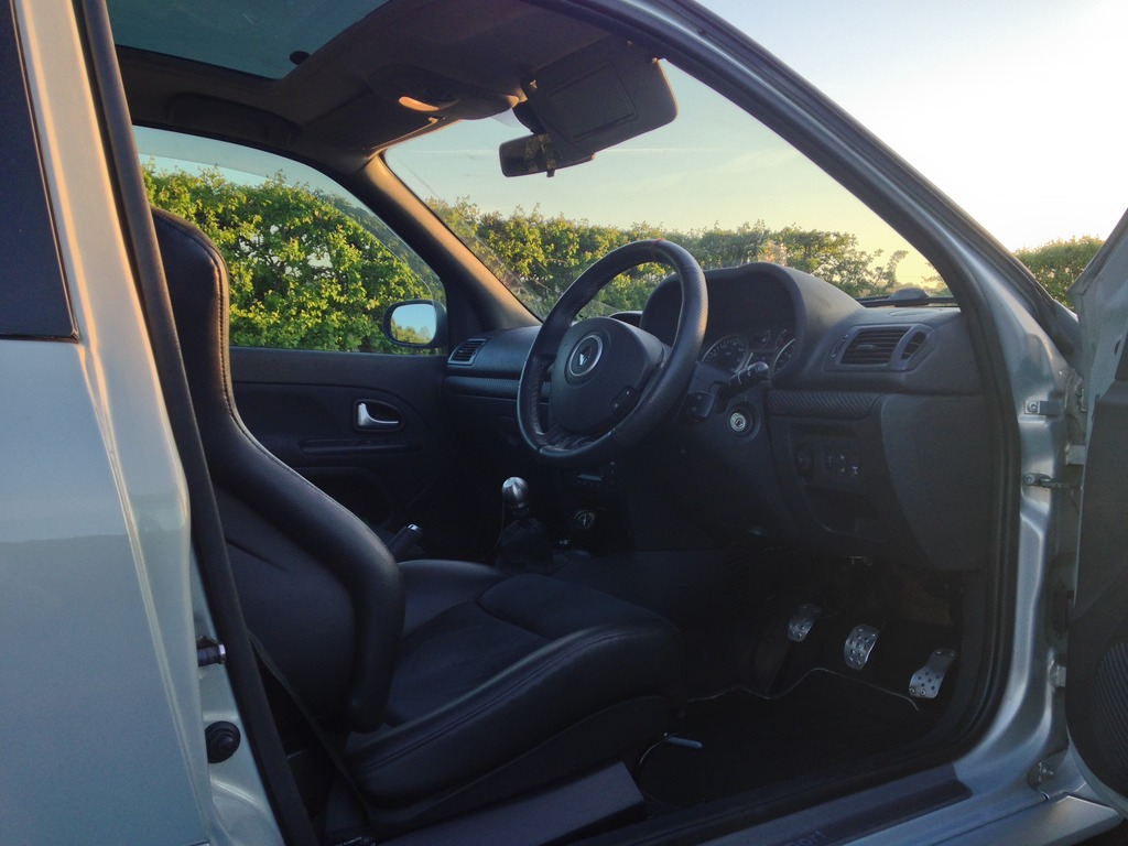

A quick scrub and wipe down with valet pro APC and it was once again a very pleasant place to be.

My wiring is pukka thank you very much lol.
