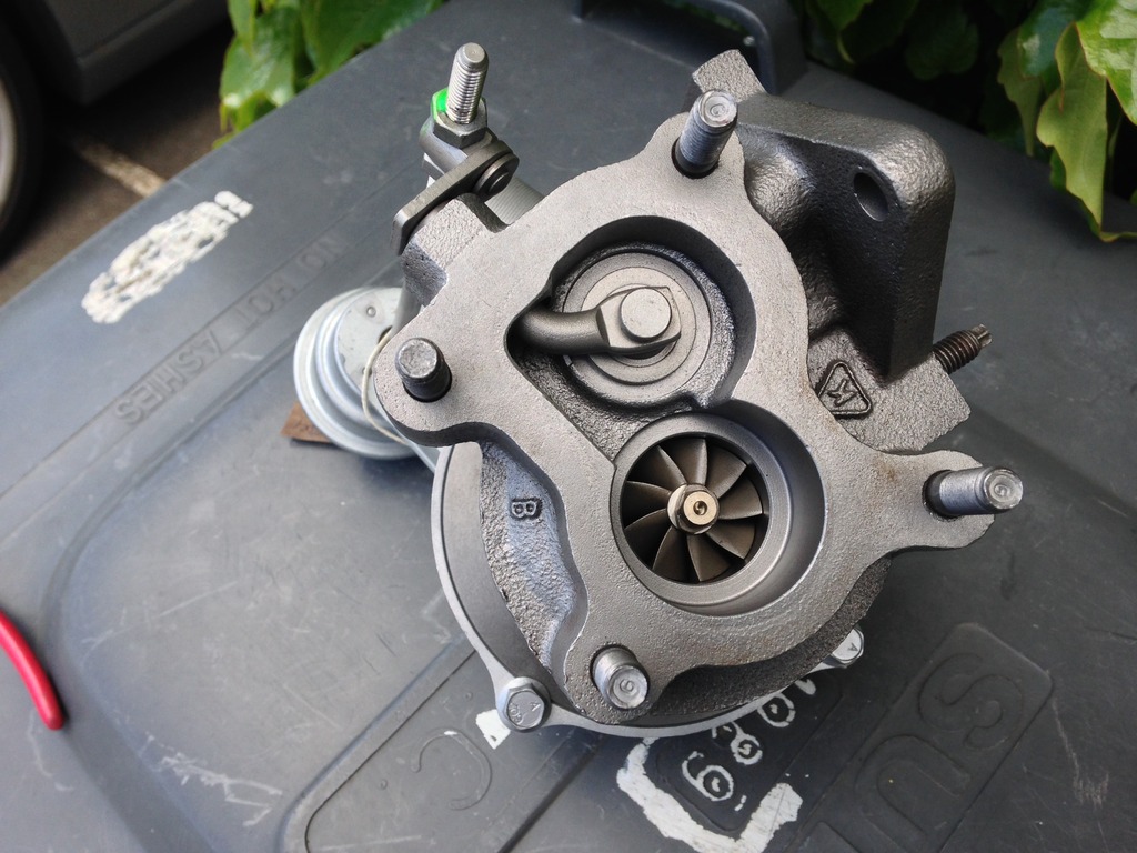

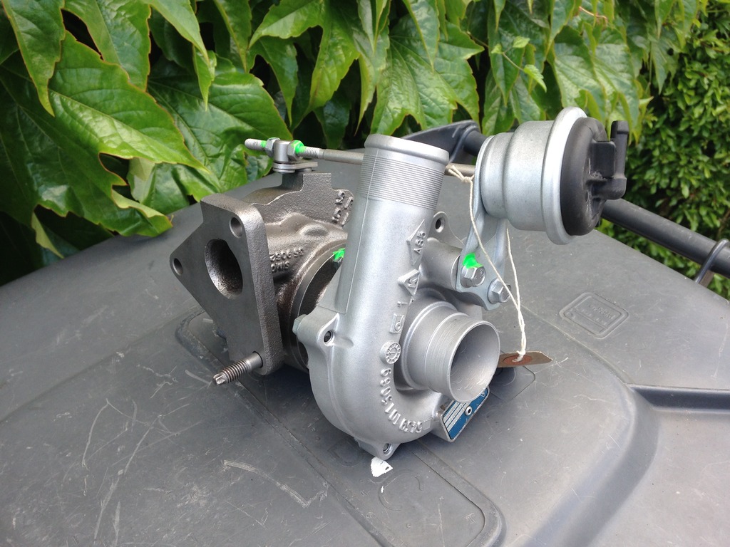

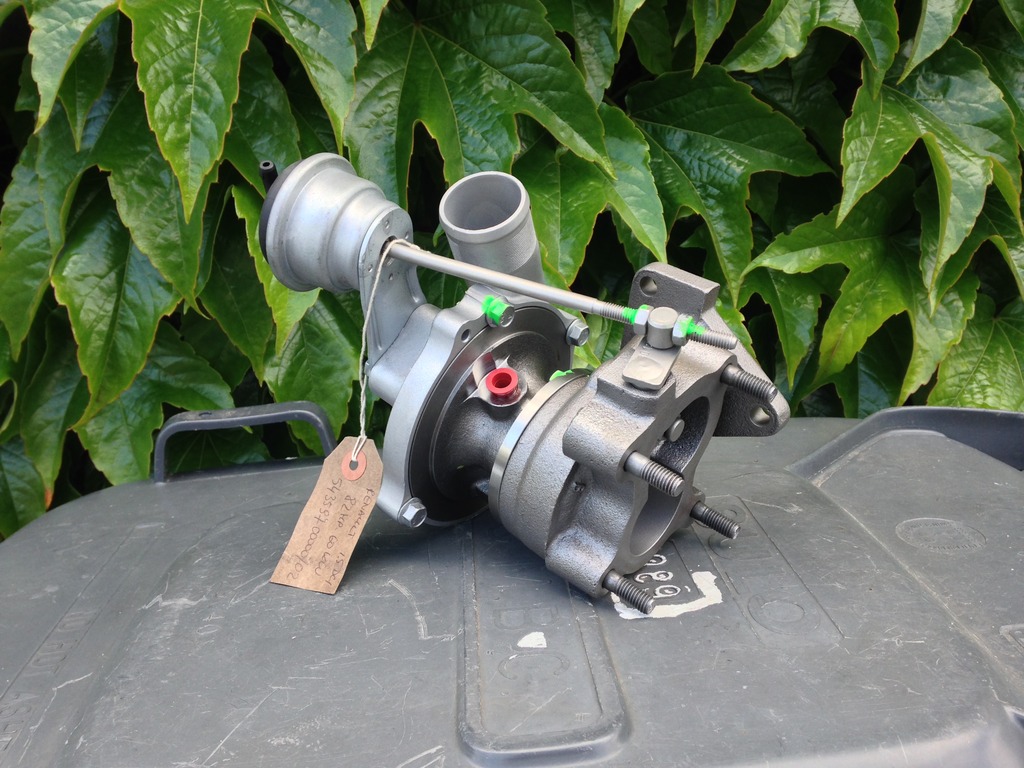

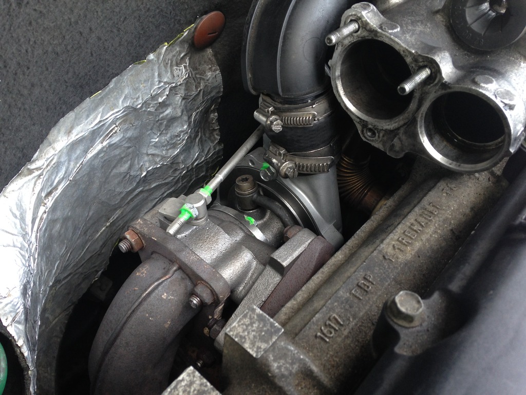

Over the past week I've done three jobs on the car with one being slightly more exciting than the other two. Firstly I fitted the new turbo completely ignoring their fitting instructions which were clearly written to ensure they never had to pay out on warranty. My favorite part was "change the strainer on the oil pump".....no.
What a piece of art the turbo was though, such a wonderful piece of engineering.
You could see the refurb turbo was leaking far less than the one it replaced even though it was still not balanced properly.
There are plenty of boring photos in between but in short it took about two hours and I found a loose bolt on the exhaust. The source of my knocking noise.
New snail in.

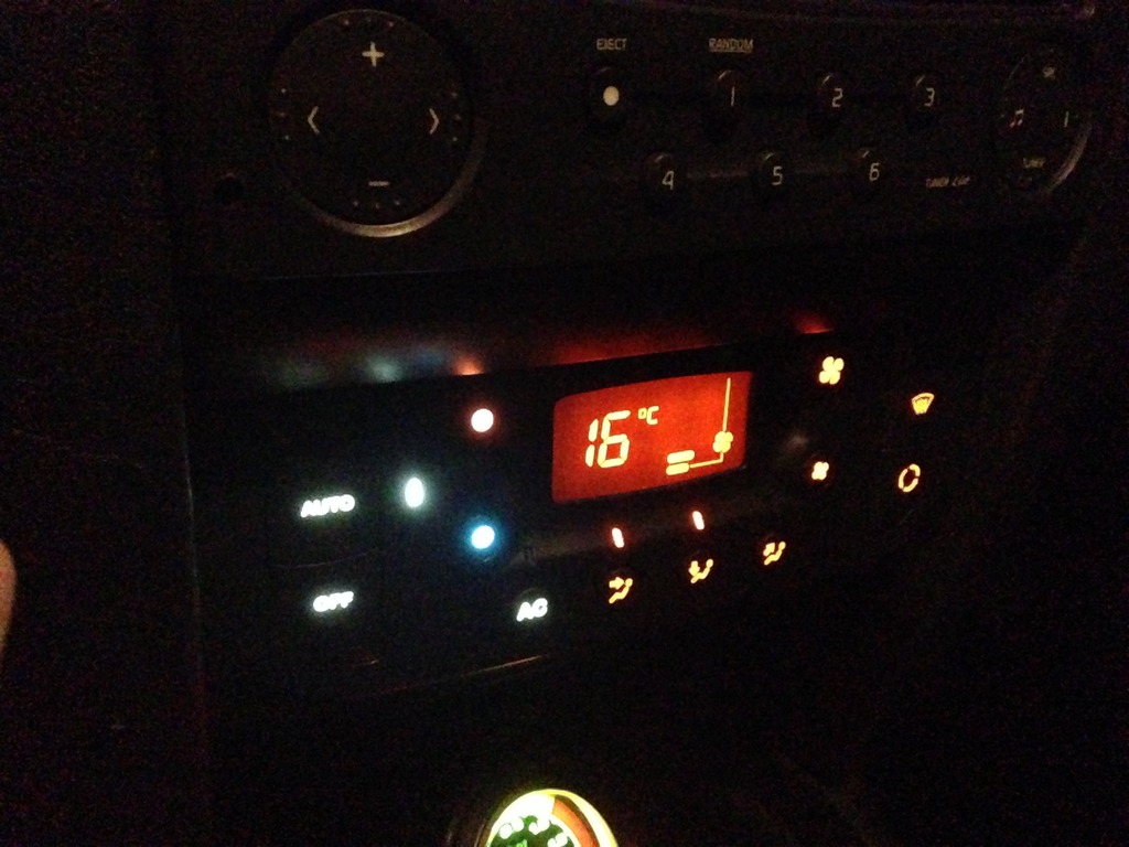

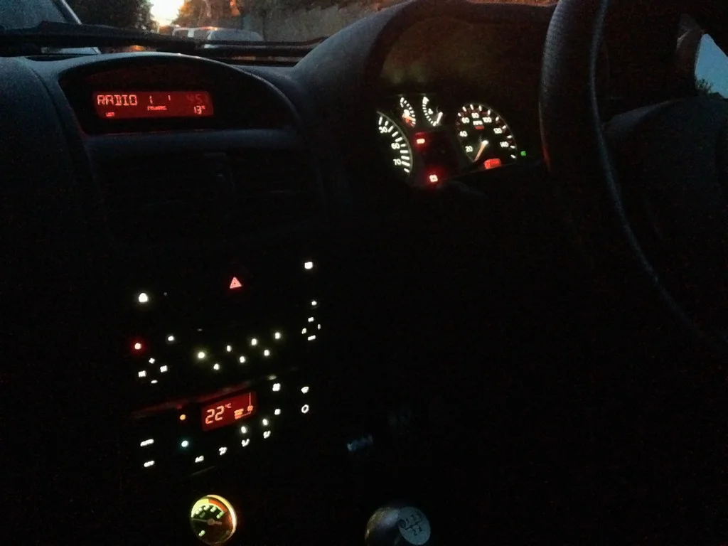

Next job was the best one. I did my clocks white and red ages ago but had never done the rest of the bits to go with it. Loads of SMDs and LEDs later it was done. Took flipping ages with 28 SMDs in the climate control unit. Looks cool though and the car feels more modern. I am thinking about changing the LEDs on the climate to red, the ones which indicate which function is pressed as it should look a little more OEM. I did the climate panel, window switches, radio, clock display and cruise control switch.
Part way through climate panel
Few pics of it complete.
Last but not least the AC is done so now ALL the functions on the car are working properly :D only £19 from groupon which consisted of an A/C clean, vac test, recharge and UV dye in the system, bargain! I was very surprised it worked as the A/C condensor is from a DCI 80, slightly bent and the pipe work is a bit of a mish mash to say the least. Time will tell if it holds pressure though although the vac test didn't indicate anything bad. As long as it lasts our holiday I'm happy.

ah, found london turbos CHRA's to be weak tbh, might of just been me but the one i swapped into a a old turbo for a friend, complained it whistled abit to much after 2k miles, took it off and london turbos found thrust pad damage... could be look of the draw tho.
those toyosport ones aint bad ( jap made )
one thing id advise, throw that shitty little rub pipe away on the charge housing exit to boost lines, its prone to split. get a nice one off ebay :smile:
Win tho as you have a later spec KP35 ! slight difference in CHRA housing..

I should have explained better! the CHRA they supply is chinese but the rebuild turbos they do are a different CHRA which is why I got the whole unit. You can actually buy the decent CHRA from them separately although they don't list it on ebay. Odd I know but I triple checked before I bought.
Yeah toyosport I'm rating thanks to @AlexW

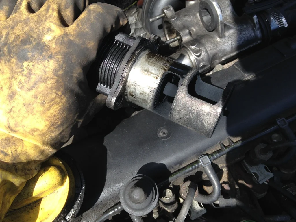

I'll put up a holiday thread in General Chat but to cut a long story short we travelled to Slovenia over two days, on the way there staying in Nuremburg and on the way back in Frankfurt. We had our first hint of trouble was on the first day what were were travelling through roadworks at 50mph in fifth, a/c on and going up a hill I put my pedal to the metal as the speedlimit ended and the dash stated flashing, typical when the fuel system can't cope with the demands. Next we had the same problems in the mountains; our chalet was at the top of a 5km 14% gradient hill with some hairpins requiring first gear and a heavy dose of revs to get up, the fan kicked in! I've never heard that on my car before so I knew it was working rather hard. Oil consumption was the next problem. The car went through a litre on the way and another litre on the way back and from what I can see it's coming out of the cylinder head breather and going into the low pressure side air intake. Finally the last problem we had was on the way home, the turbo actuator got stuck open so there was noooo boost :( a quick tinker with the spanners saw the boost back and no problems since. Sounds like a lot of problems but really they're rather minor bar the fuel system which just confirmed my fears over the last 10k.

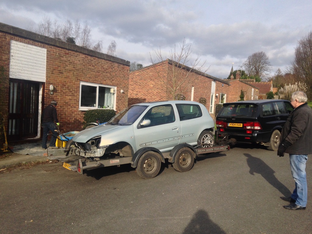

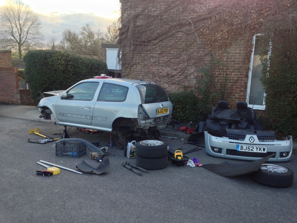

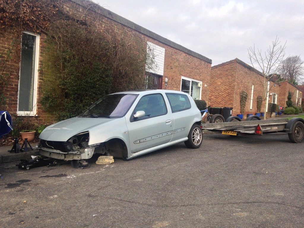

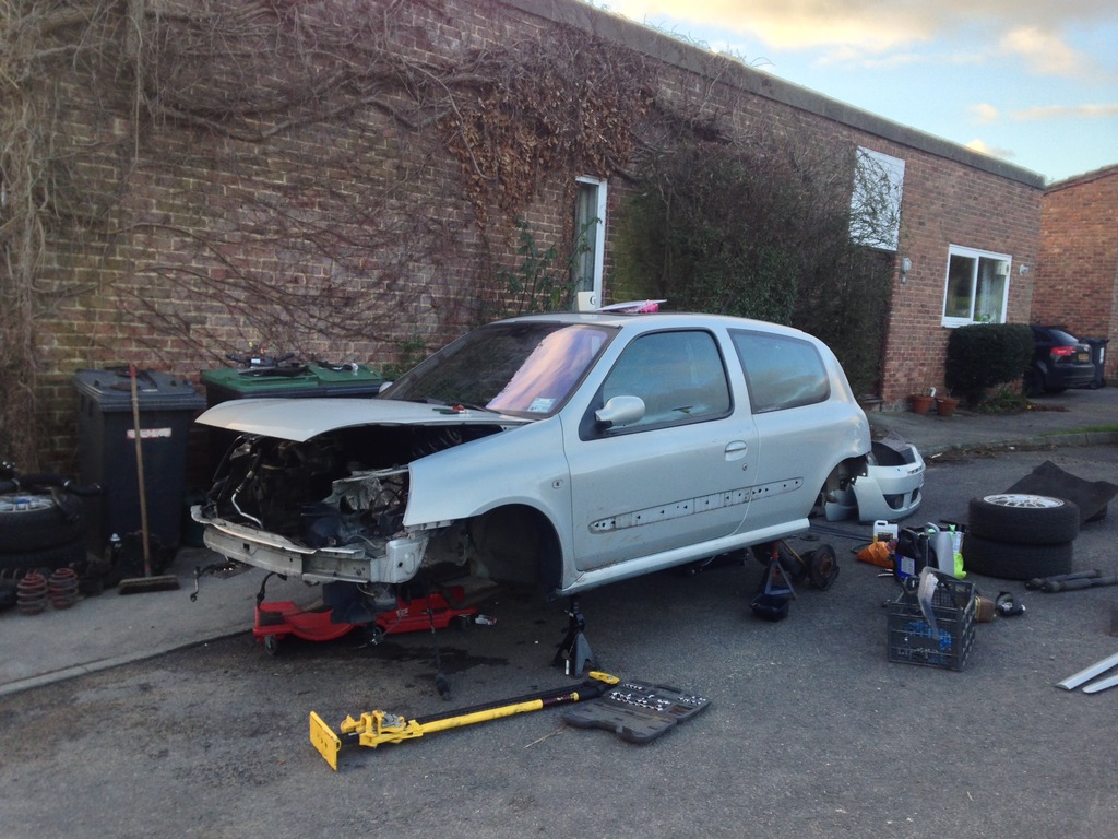

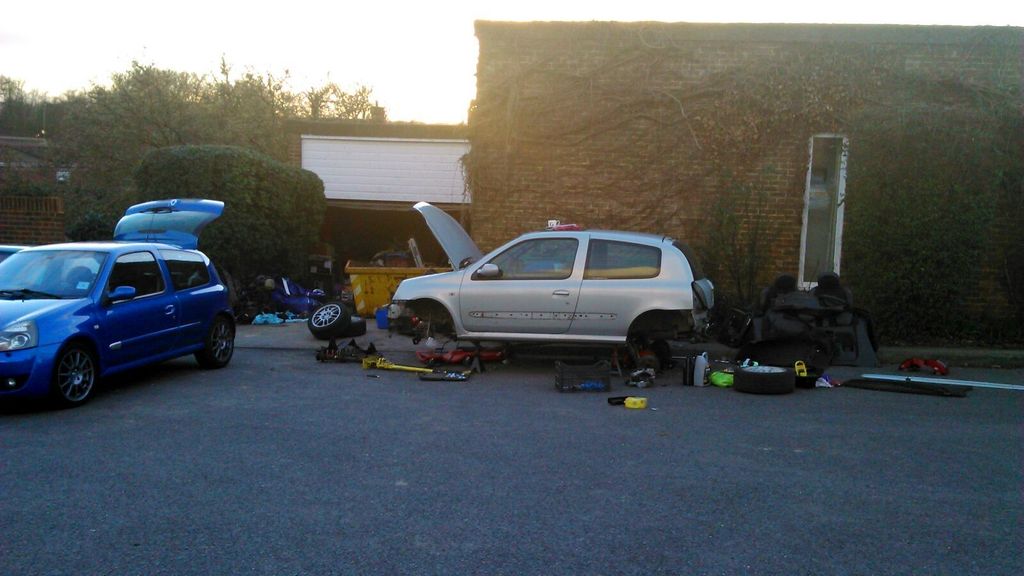

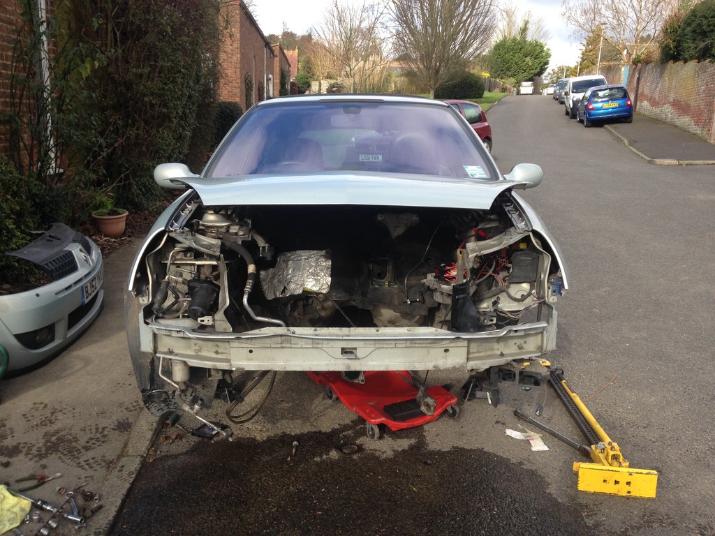

So what a sad week it's been. The car wasn't getting any interest from the advert on ebay so I decided to break it for spares and took the plunge of stripping it on Monday.
12 hours later everything was off and Claude was destined for the scrappies. This morning we got the shell on a trailer after lots of swearing.
I've done 52k in this car, spend far too much money on it but thoroughly enjoyed all those miles and trips all over the place. For anyone reading wondering if they should rep their car I'd say do it! I've learnt an absolute shed load swapping all the parts over, playing with the turbo and changing all the wiring and I'd do it all again. The car was perfect for my needs, went round corners brilliantly and cost barely anything to run. The fuel pump failure and engine burning oil meant it just wasn't economical to repair. It's drunk 20 litres of oil in the last 5k.
I've now moved on to a temporary 182 before getting something a little more grown up and German in a few months time. Last piccies of Claude!
