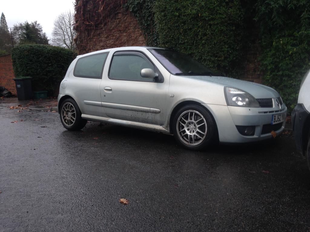

Back needs some serious spacing as it's lost at the moment. You've got 15mm rear hub spacers haven't you? did it rub without rolling because I'll do it this weekend if it doesn't :D
  Many.
I have 10mm with 1 degree Neg camber, and I still get rubbing, with 195/45 tyres, assuming its the same height as mine.
I had 2degree camber before, had no rubbing.
Will have to find some time!
I'm screwed then! I've got 205/45. Will put the 195/50/15s on and see if that gives more clearance.

Just an FYI Graham, I'm running 15mm rear spacers on 182 hubs (so the widest ones) with 195 tyres. I've "rolled" my arches (read: battered with a hammer to get then out the way). I only really get rubbing if I have 2 people in the back, so I just try and not take passengers lol.
I'd have thought 10mm with some camber would've been fine. Does yours rub a lot AlexW ?
I'd have thought 10mm with some camber would've been fine. Does yours rub a lot @AlexW ?
Is yours as low as mine? TBH Graham may get away with it, with his 4X4 height!
I too have 182 hubs too (from Grahams old car!), Mine rubs on the bumper now, I have arch liners fitted too.
Pretty sure it rubs near constantly with two passengers/fattys, but not taken many people recently.

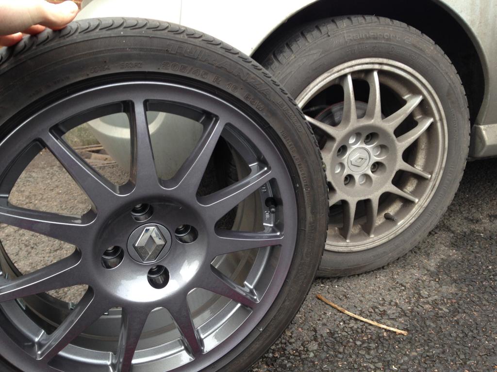

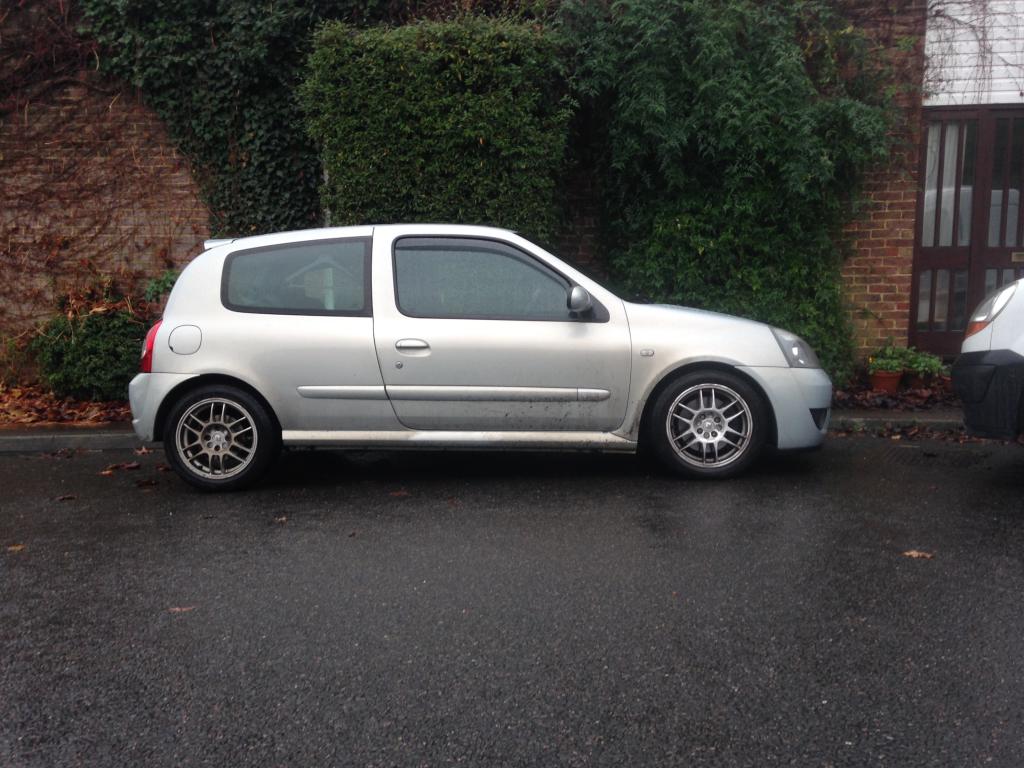

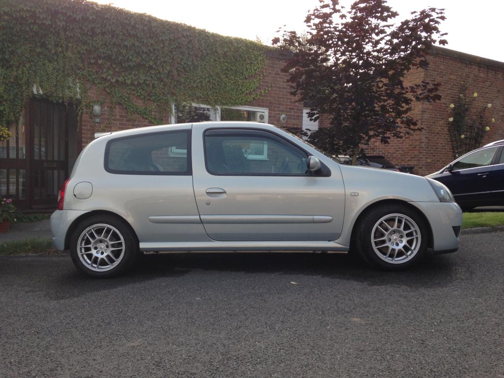

Swapped the wheels over to the oz f1's from the ph1 I just broke. The paint finish is in terrible condition because of the age but they still look good once cleaned and should give a nicer ride. Plus the additional 5mm offset looks much better.

OZ's need to be gunmetal and stop being a poof and get it lowered more ;) or get some turinis.

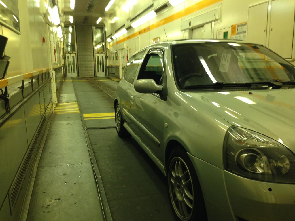

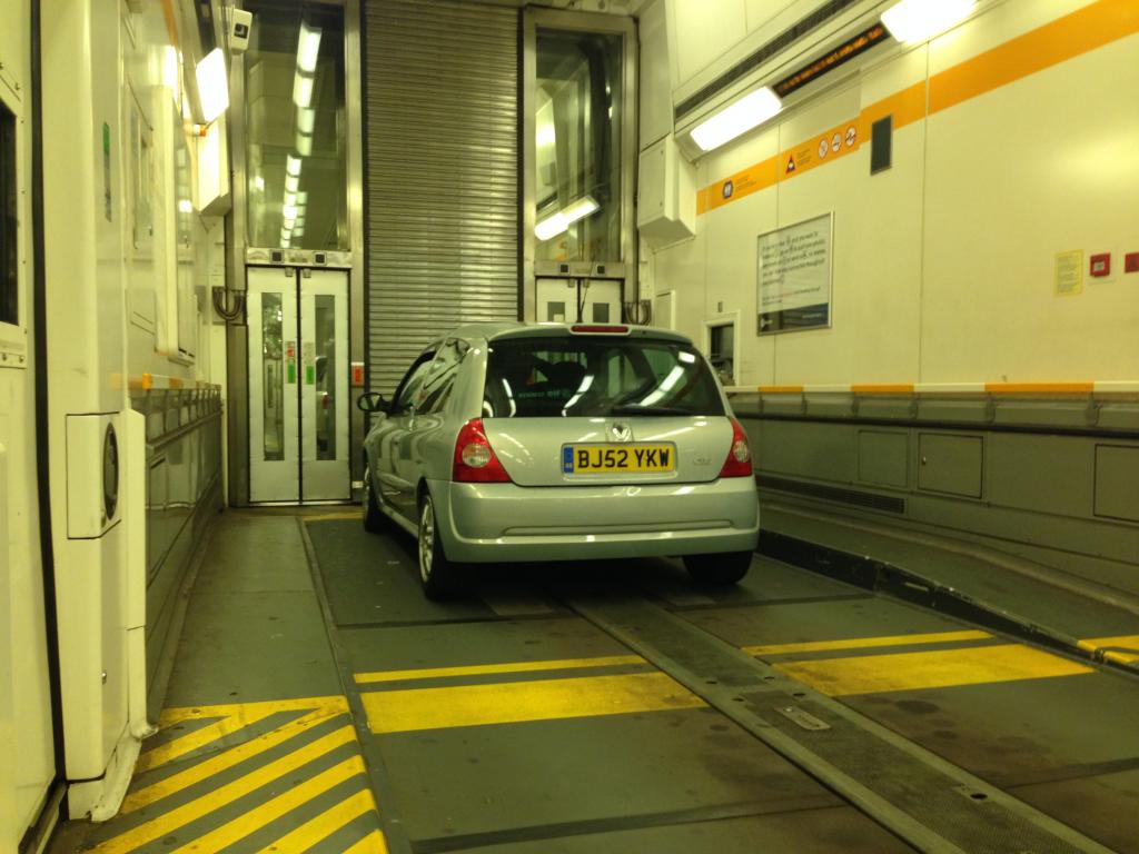

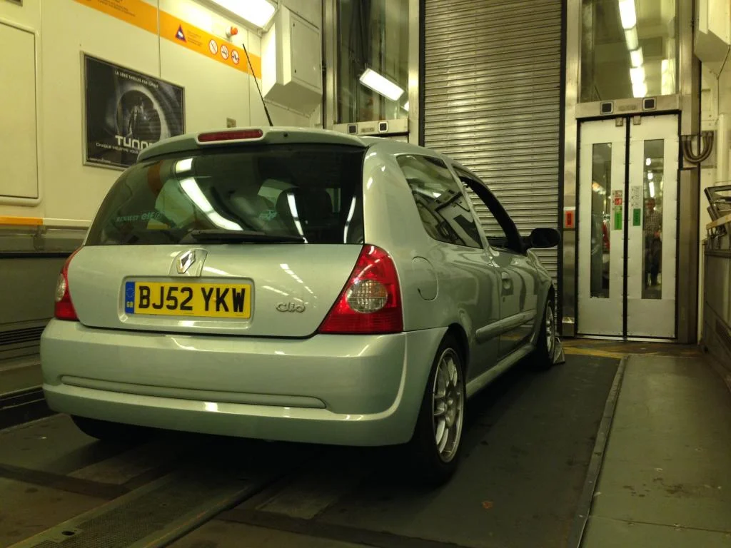

Last but not least I took the Clio to Belgium yesterday and noticed a couple of problems. The whole car felt stupidly vague on the motorway, something I've never felt before but I had to keep adjusting the steering. Need to sort that ASAP. It's also time for an oil change as I had to spend 17 EUR on a top up :/ and the wheel bearing on the o/s is a little too noisy for my liking now.
Good points though. I got to almost replicate the avatar photo I have but with current Clio so I'll update that soon.
On the way back we also got a whole coach sized euro tunnel for our selves. Not bad considering the ET was complimentary after our last years 12 hour delays :)

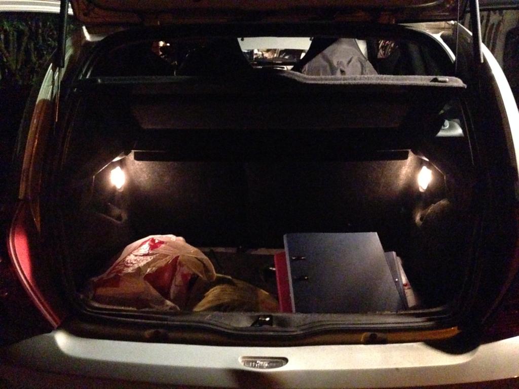

Now have dual boot lights which is much better
Finally got a proper climate resistor as I've been without a fan all summer!

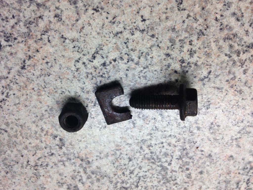

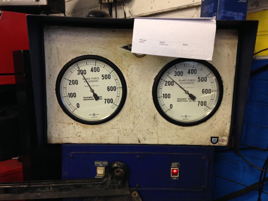

Brakes on the front are off balance which I have no idea how to remedy.

Sitting nicely on the sportlines! Are both your calipers completely free? Only thing I can think of causing uneven braking force would be the caliper sticking slightly.

Both calipers were rebuilt in april. Sliders are totally free. Pistons seem to be free and I exercised them in and out a few times with no issues. Think I will rebuild them with new pistons and seals again and then go from there. It's pretty dangerous at the mo. Keep nearly ending up in the hedge!

Braking problem fixed, the outer ARB bracket had snapped off leaving this stub of what it once was.

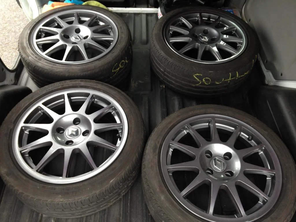

Car is getting pretty filthy now because of the salty roads but I'm still on a high from the arb fix. Decided to finally get my Turinis refurbished for summer after they'd sat in the garage for ages waiting for me to attempt to paint them. Time efficiency won in the end so I dropped them at at Spit and Polish the other day as it's only down the road.
No results yet but they'll be done by the weekend hopefully. I've gone for the granite they use on 16 spoke AMG alloys as I didn't want them too dark.

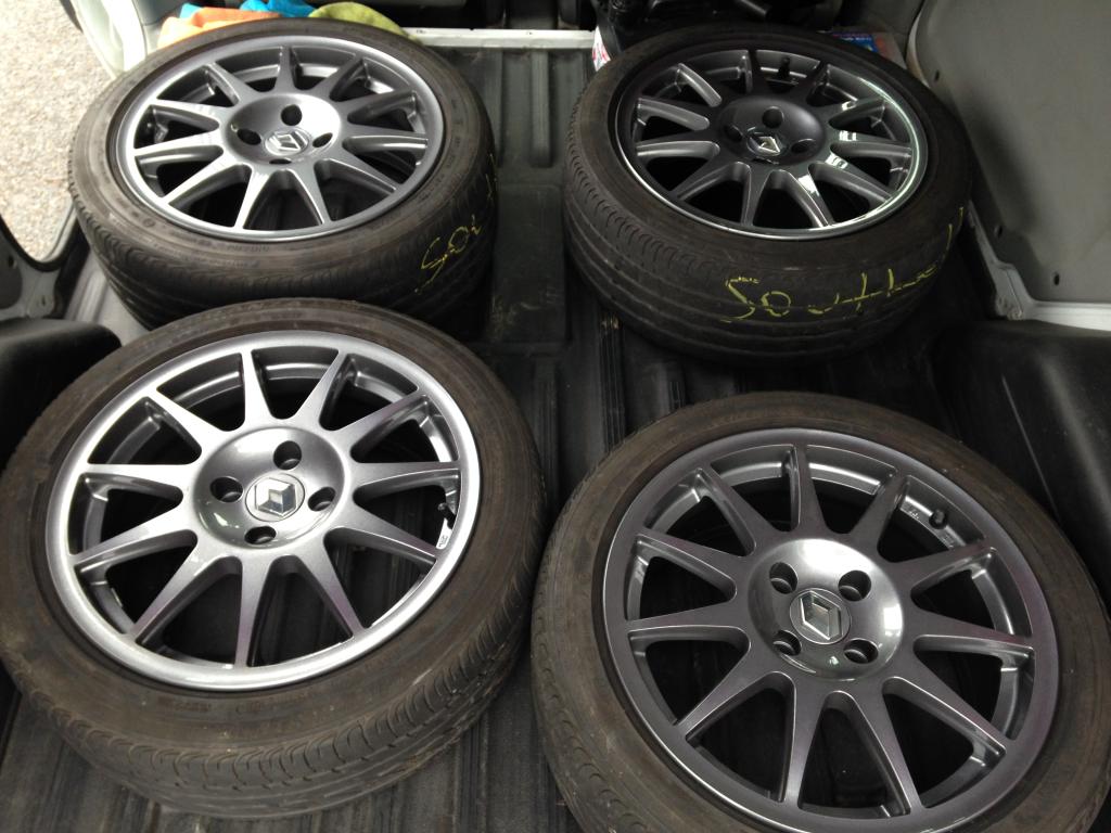

Wheels are done, getting them picked up tomorrow hopefully.
No problem there is a few of mine on here some where ,but I haven't got any recent ones,now got a sport grill ,silver bullets and a cup splitter which i need to fit .
Bet you can't wait to get your wheels back would love a set of turinis for mine :smiley:

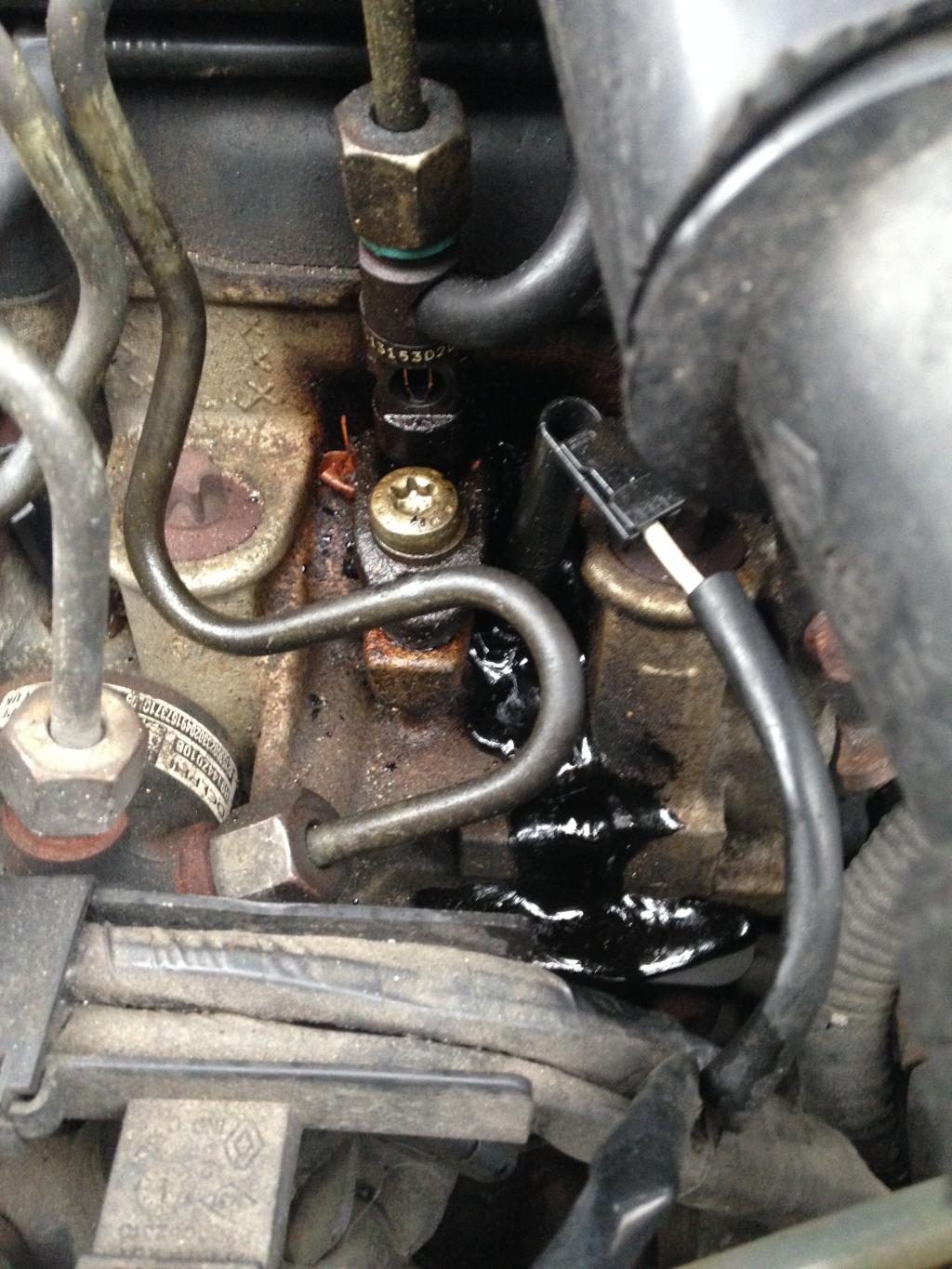

Couple of jobs on the car today

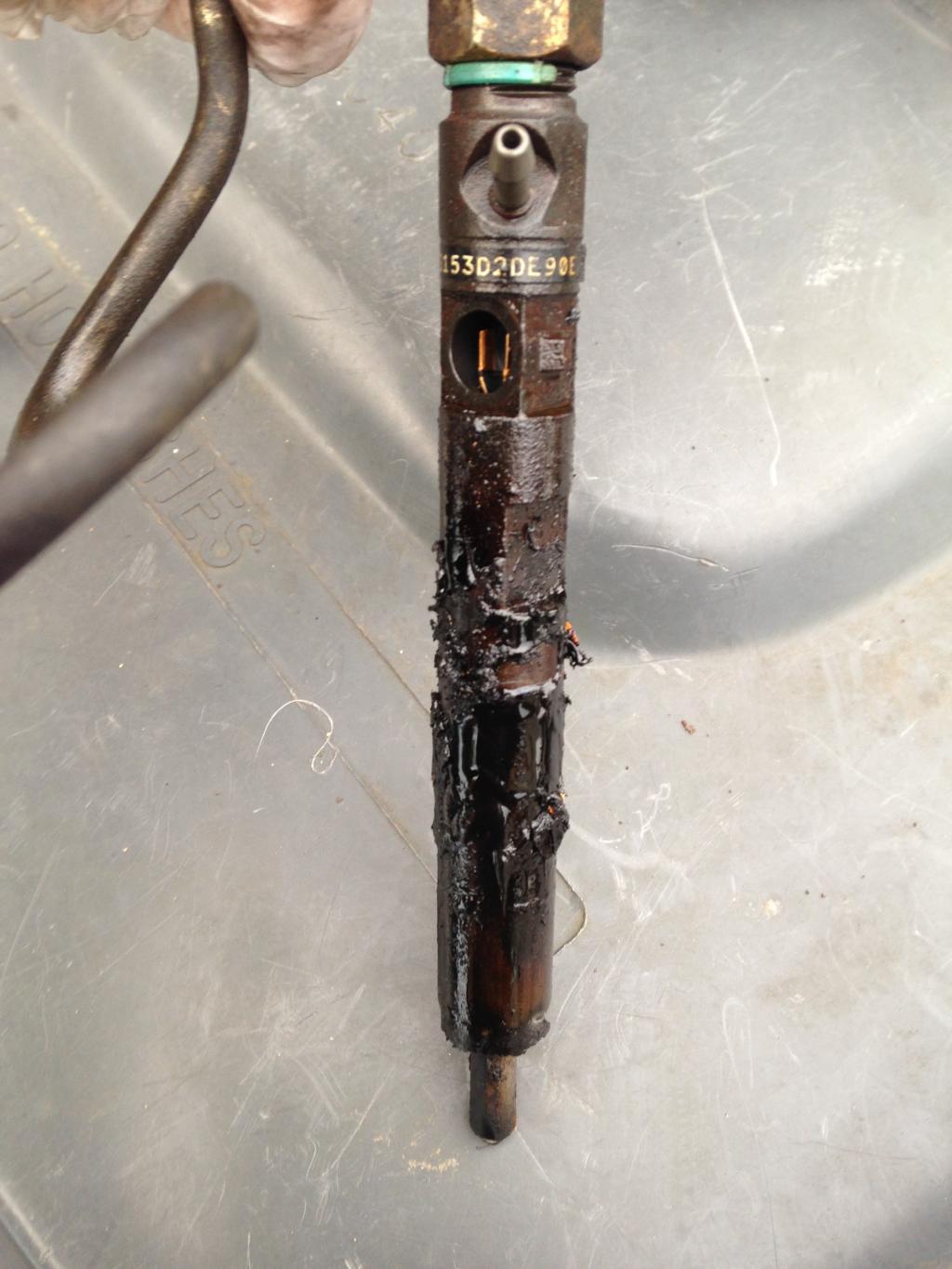

One of the injectors was leaking so I replaced the copper washer. Had been leaking for quite some time as you can see. I also tried to adjust the turbo actuator but one of the nuts was stuck so I wasn't able to unfortunately. Egr valve swapped for a spare as my current was jamming up.

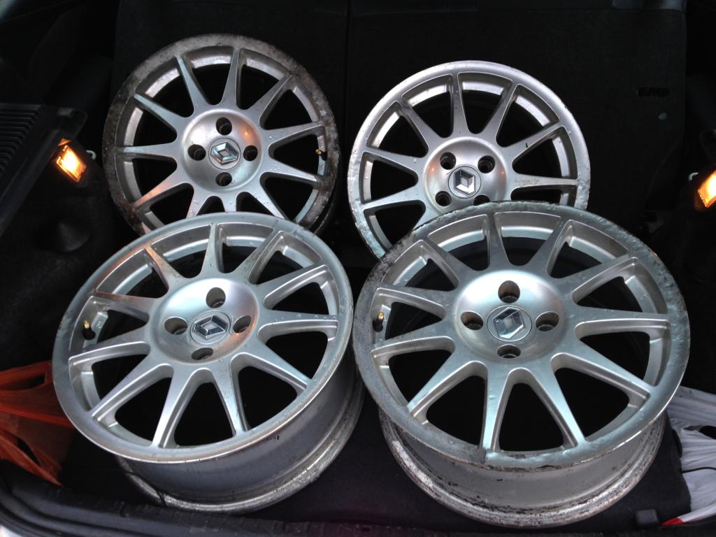

Got the alloys back and am very pleased with how they turned out. Will put them on when the weather gets a little better.
Replacing the injector seal has made the car run quite a bit better which is good and the egr valve cured the intermittent no boost problem.

Dr HMS Derv Destroyer
  MK1DTi/vivaro/corsa
dont go mad on adjusting the wastegate on te turbo. those poxy kp35's dont like being tweaked to far without uprated thrust pads.
