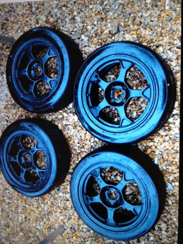

New 15" track wheels bought :D just need to sort out some track tires ,then decide if im going ot keep my 16's as road wheels with normal tires or sell the Turinis with 888's fitted.

Good choice, don't get much better wheels for cost/weight/cooling balance than 1.2's.

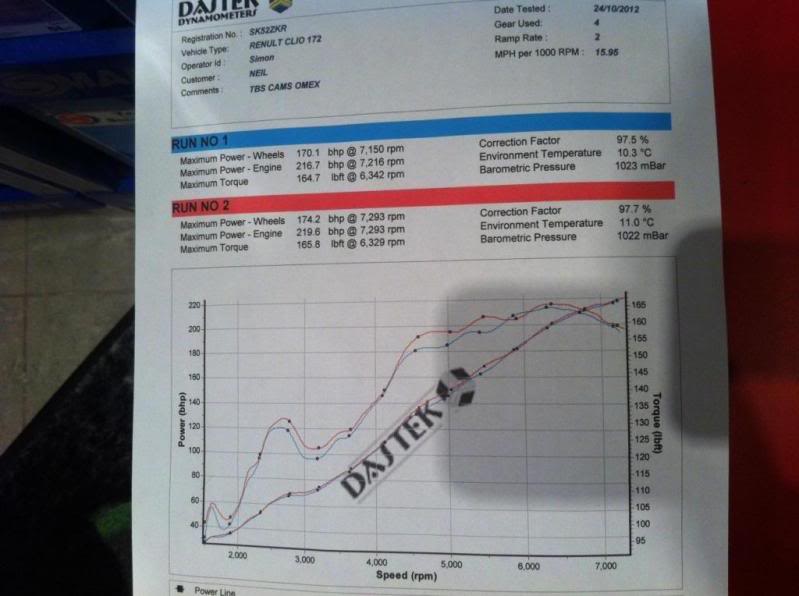

Just had an update from my mapper he is waiting for ramp space to fit the ARP's so only reving to 7100 rpm, but has done some mapping up to that point and power is still rising and showing 176.6 ATW. Not wanting to get into the whole rolling road debate thing but its on the same rollers that the initial run was done on before the cams and bodies and showing 20bhp up ATW.

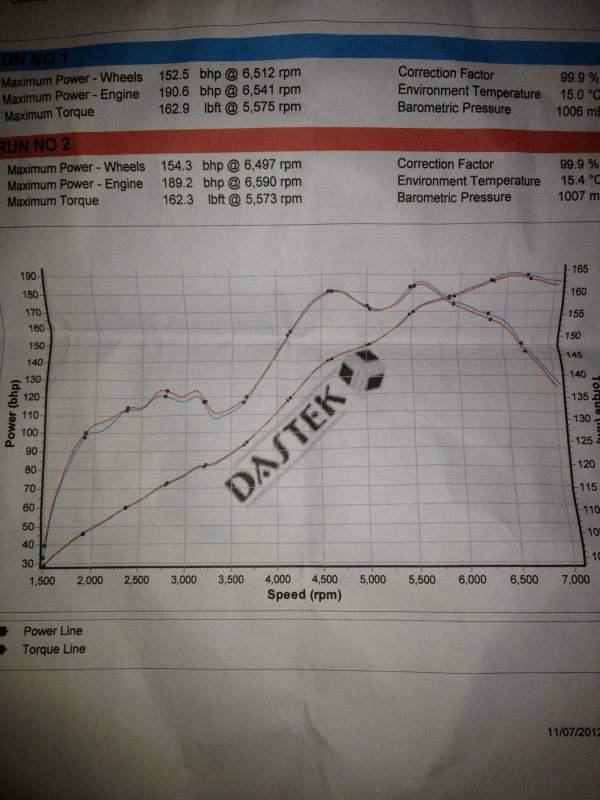

Got emailed a work in progress power print out , so here it is compared to my old spec. The ARP's are now in so will be reving to 7500-7600 RPM , and more mapping to smooth out the delivery.
I did think about a jump from 90mm to 110mm trumpets to increase torque , but as it running a standard box and clutch this may just add extra cost for unreliable gains ?
Old spec
Work in progress map
  Cup In bits
Re: Road/Track 172
Good power figure Neil but you have lost torque throughout the rev range, bit of a strange one.
neil a
Re: Road/Track 172
Yip I noticed that and have emailed Simon about a possible change to trumpet size, torque is down everywhere until 5K where it then holds much better from then on. This is just a work in progress map so will probably change a bit even without changing parts.

Final power output was 174.8 bhp at the wheels and 166.1 lbft , I picked the car up tonight and love the way it goes it just revs so much more freely than before.

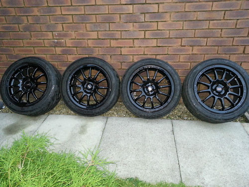

Also bought these to use as track wheels with 888's or Ao48's for track then use the 1.2's with Yokos for road and wet
