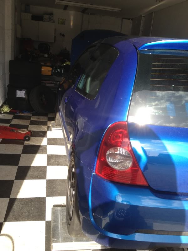

Thought you had sold this as I'd seen no updates! Looks great on track though :) Did you sort out the corner weighting yourself? Hoping to get to the trackday in april with a bit luck, You got any more lined up?
neil a
Re: Road/Track 172
I got a shot of Sitech's corner weight scales to set mine up at home , but they could easily set your car up down at there place in Rosyth.
im hoping to get to as many as possible and try some English tracks aswell, that's my mates 106 behind me in the pics. It's over 30bhp less but an even match as its so light.

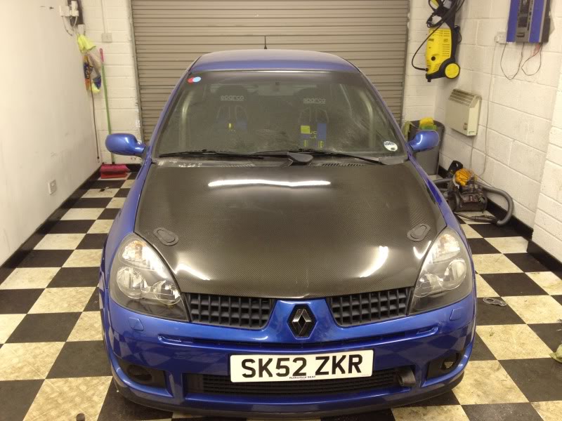

These arrived yesterday :), and should be picking up a carbon bonnet today. Last night I also ordered a full set of windows from Plastic 4 Performance and another set of aero catches. Im going to hold off fitting these until I see if the group buy for FG tailgates goes ahead if not I will get one from HARacing , then all parts can be fitted and painted at once in which colour ????

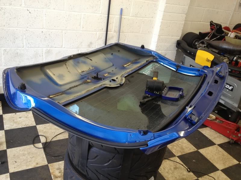

Got a light weight carbon bonnet last week and fitted my aerocatches, I have also gutted my tailgate and may hole saw around the edges aswell. This will just be a temp measure until we see if a tailgate group buy is going ahead with CMC.

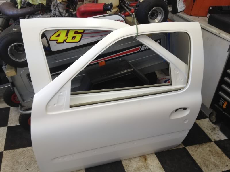

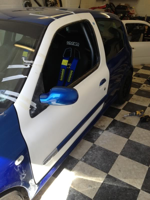

I have now got my aerocatches fitted to the tailgate and today spent some time trial fitting my FG doors before hopefully painting them tomorrow. I have got the drivers door almost fitting perfect but the passengers side one is twisted slightly so harder to line up. I have to say I was really shocked when I removed the original doors just how heavy they are :eek:, hopefully my windows will be here soon from P4P then I can get back out on track.
neil a
Re: Road/Track 172
I just drilled the holes in the outer skin for the 3 original screw fixings and took off all the electrics, I did have to cut off a couple of locating dowels to save drilling more holes in the door than needed

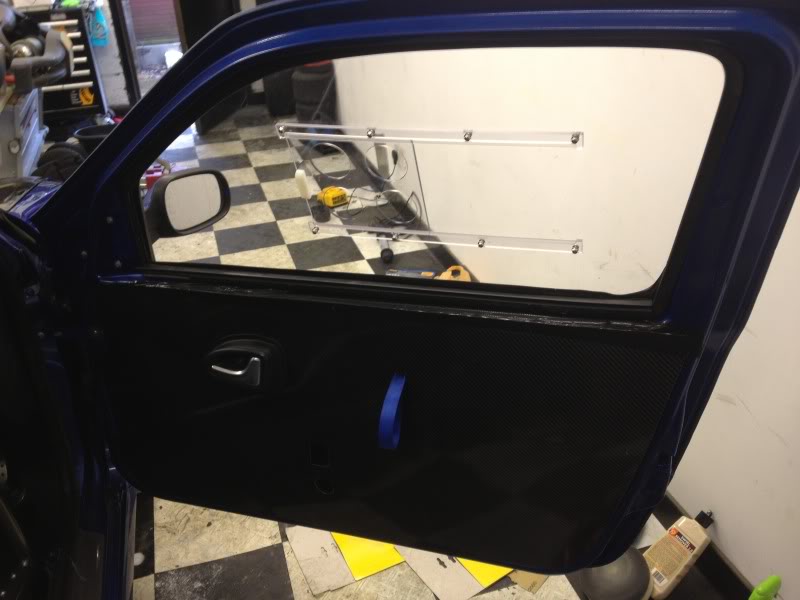

Had a bit of a set back as P4P now say my windows won't be ready untill the 27th ,so I have cancelled the fronts and re ordered them from ACW this time with sliders which should be here this week. This will allow me to get the car water tight and useable.

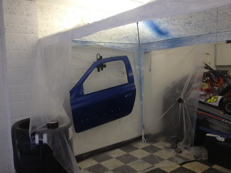

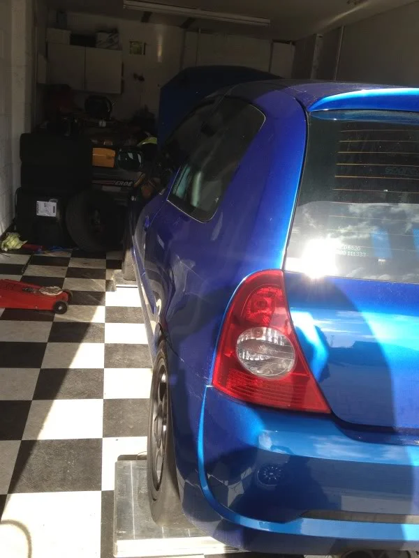

Make shift booth
And fitted , they still need a flat back and polish but not too bad overall considering it was my first attempt at a 3 stage paint.

Top job Neil, I have a bonnet, boot and two doors for you....please.
Did you do inside and out and how did you find them to paint? Did they take a load of paint being porous FG?
neil a
Re: Road/Track 172
I did the inside an out and the base and colour coats wernt bad but have a couple o runs on the laqure. I got the paint from spray store and they advised put a blue base/ coloured primer over the white or it would end up too light.

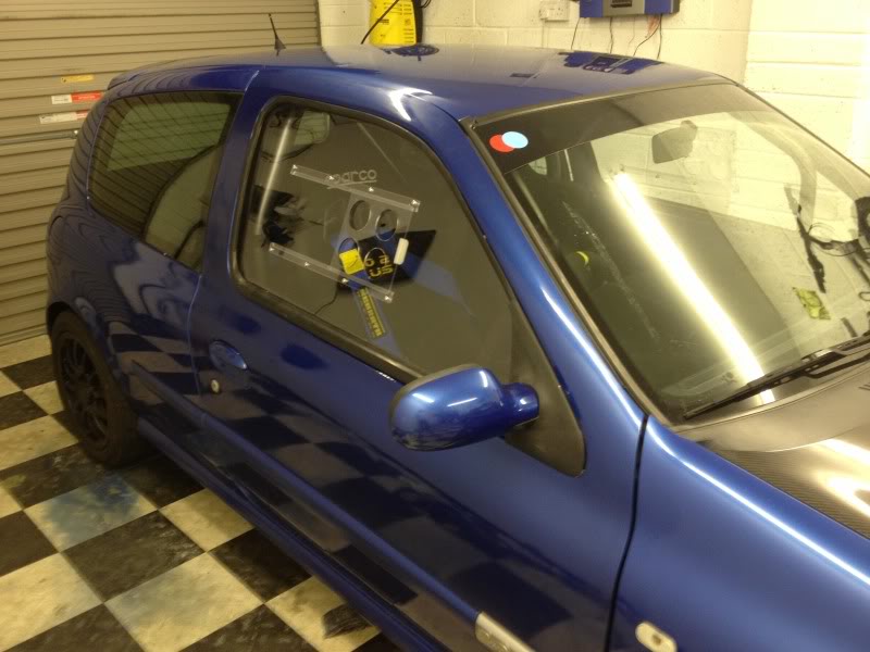

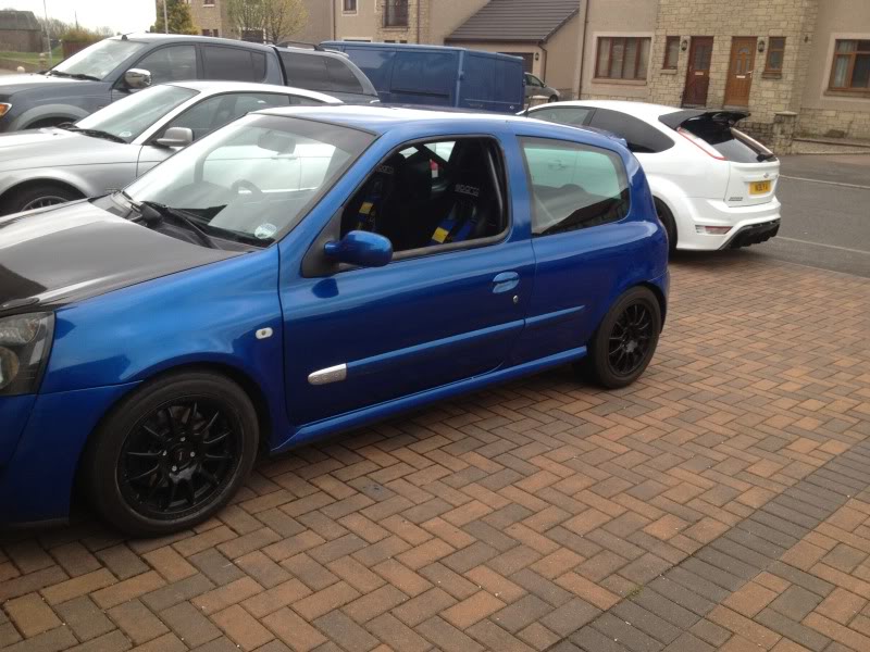

Got my front windows through from acw can't thank them enough for the quick turn around an quality. Just hope my rears come through soon from p4p

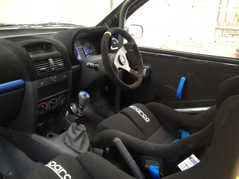

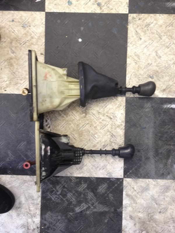

The good news is buy the time I get home the rest of my lexan windows should be here, and I have also bought a yanoo stiff shift and a megane scenic gear stick . Buy mixing the two of these it should hopefully give me a nice shift and better position aswell closer to the wheel.

Picked up this to be fitted with a yanoo stiff shift to try and give a better gear stick position.
Standard 172 V's Megane Scenic
neil a
Re: Road/Track 172
Throw is about the same as standard but without the normal play, the actual position is a lot closer to the wheels and feels loads better to use.

I fitted a yahoo stiff shift into it so I think that's meant to give a 10% shorter throw but due to the longer shift it feels very similar to standard. I got the shift out of a mk1 megane for about £10, the shift position just feels so much better than normal but the test will be on track.

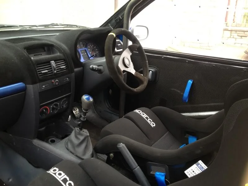

Thought it might have been sold as it was pretty quiet in here. I just re read the thread for some motivation for mine, mine will be very similar inside with the flocked dash, colour and then the ITB's :cool:
