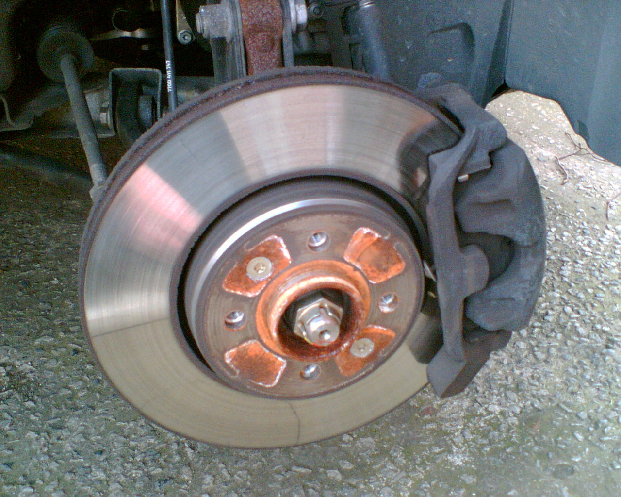

For the last few weeks I've had an intermitent grinding/scraping noise coming from the offside front, sometimes when breaking sometimes when not. So last weekend I took the wheel off and look what I found.....
Can you see it? No? Let's look a little closer...

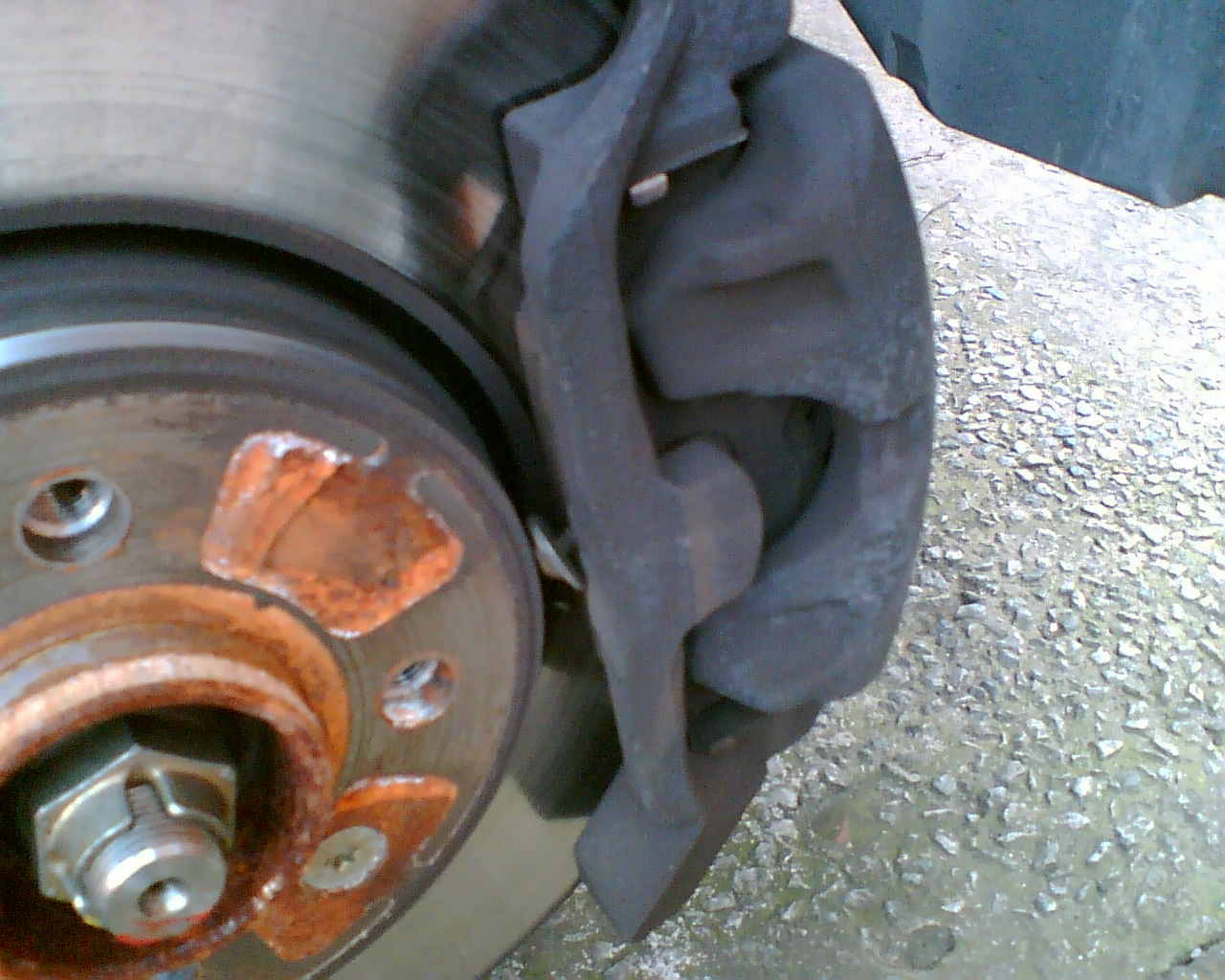

Yes, that's right it's a screw lodged between the caliper and the hub!!!
The only damage done was a slight grinding down of the hub edge - the disk and pads are fine. A lucky escape I think. :eek:
Pictures taken with phone hence crap quality.
Looks like one of the arch liner T20's probably not done up tight, or worked loose and dropped in, could of been worse.
