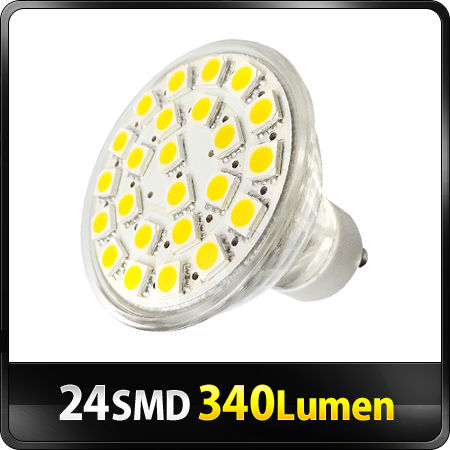

I've got 8 of these in my Kitchen , in 2 banks of 4 spotlights . GU10 24 SMD 3w , 340 lumens , warm white , 120* angle opposed to your standard GU10's which are usually about 38* angle , so no dark areas as they all overlap . I've been using them for over 12 months now with no issues or failures . A few mates have LED GU10's and they don't come close to these for brightness . only £11.98 for 2 delivered .

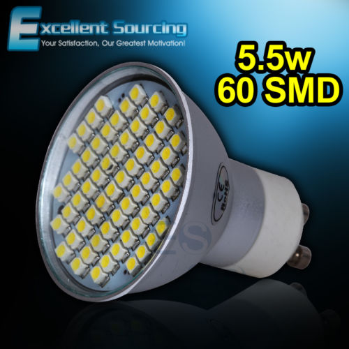

I have tried various leds and just recently bought these.
http://cgi.ebay.co.uk/ws/eBayISAPI.dll?ViewItem&item=301065618286&ssPageName=ADME:X:AAQ:GB:1123
GU10 5.5W - 60SMD Warm White

ALSO - If you go bigger than 5.5W I have noticed they are NON GU10 Sized so will stick out your holder/cup. These are the highest wattage I can find that fit a GU10 and still the same size. Those are equivalent to 50/60W bulbs normally.

This is exactly what I purchased... Had them for a fair few days now.
Really like it, I got cool white, which is a lot brighter white than I expected, but ideal for the kitchen.
Will replace the living room energy saving bulbs with Warm White LED's soon I think.
Nice one . They really are the best I've seen , for brightness and for coverage . Like i said . A fair of my mates have different makes of GU10 leds and none come close to these . The warm white are very bright and white . There's really no need to spend silly amounts of money to get good quality . Glad you're Happy with them :D

Like I said in my first post . I've been using mine for over 12 months now with absolutely no issues , failures ..... and compared some of the led GU10's that I've seen , these win hands down . You don't have to pay top dollar to get top quality . I guess some people just can't accept that :rasp:
