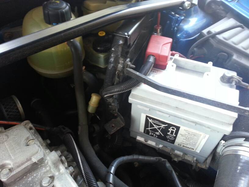

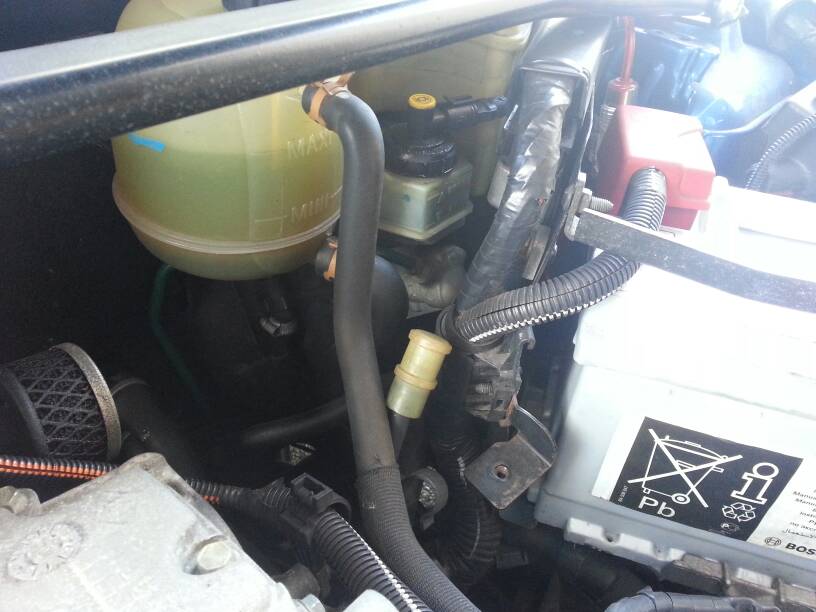

Am i crazy in thinking the mbc could be changed from above?
Just move the battery and ecu out of the way?

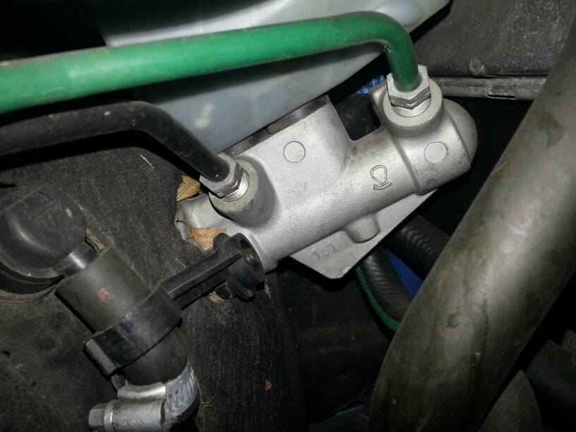

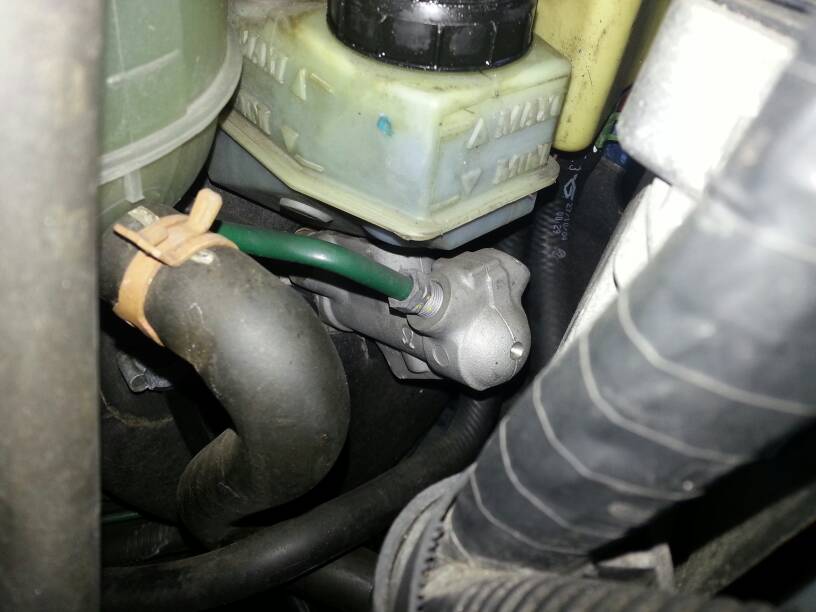

Yes, its secured with two M10 (?) bolts. Easier on your lhd as the engine isn't in the way :)
ddrat and double drat.....
seems the MBC on a LHD car is completely different from a RHD car.....
the flange on a LHD 182 is oriented horizontally and is smaller (and has smaller spacing 'tween the m10 holes)
also the fittings are both M12x1
troed some modification but these wasn't enought meat in the 197 MBD to drill proper holes....
