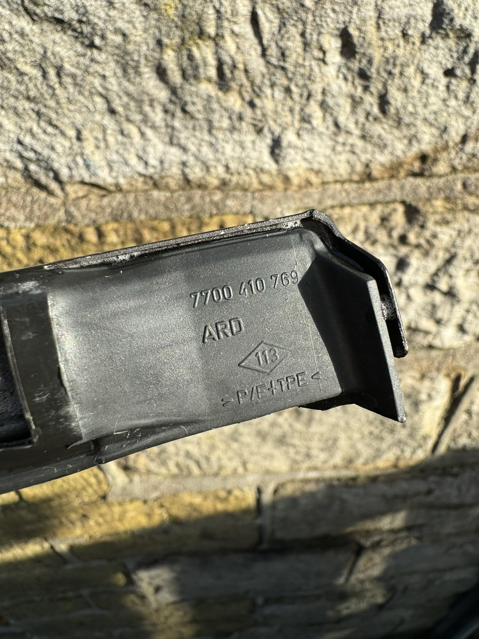

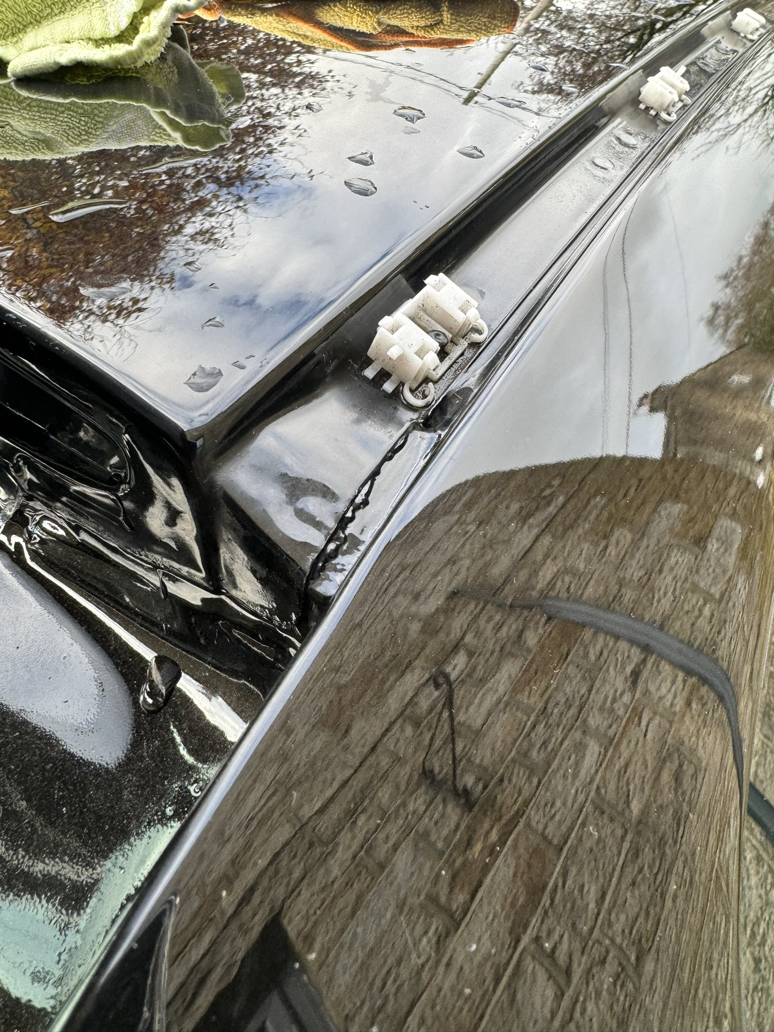

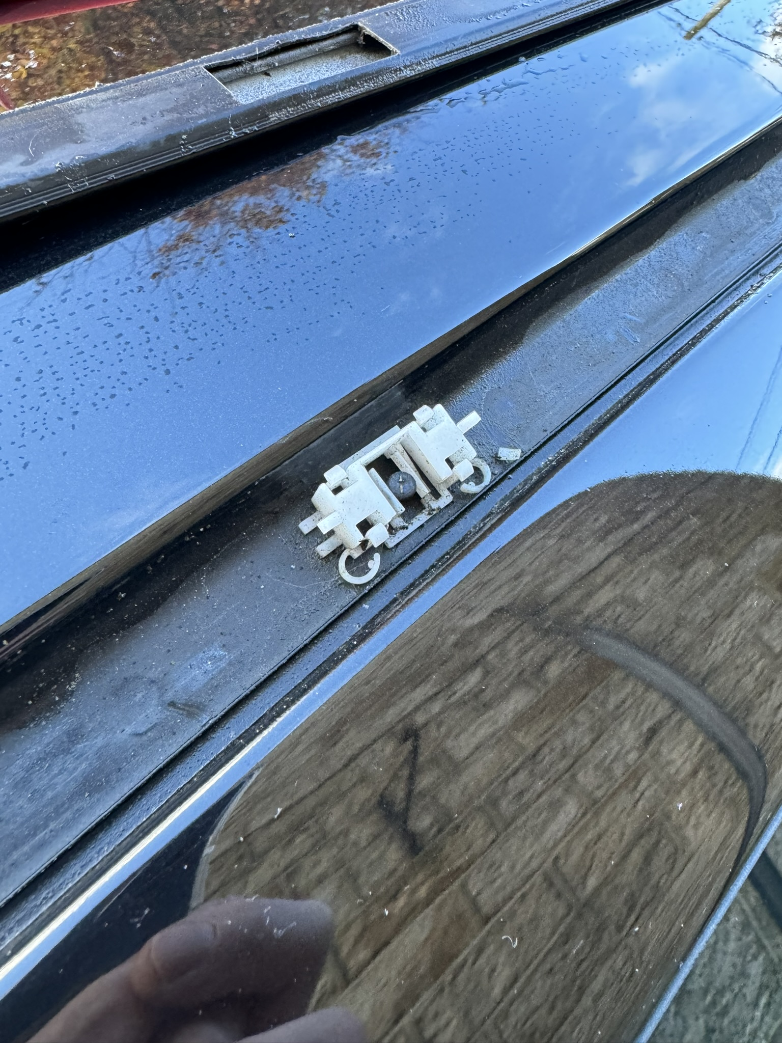

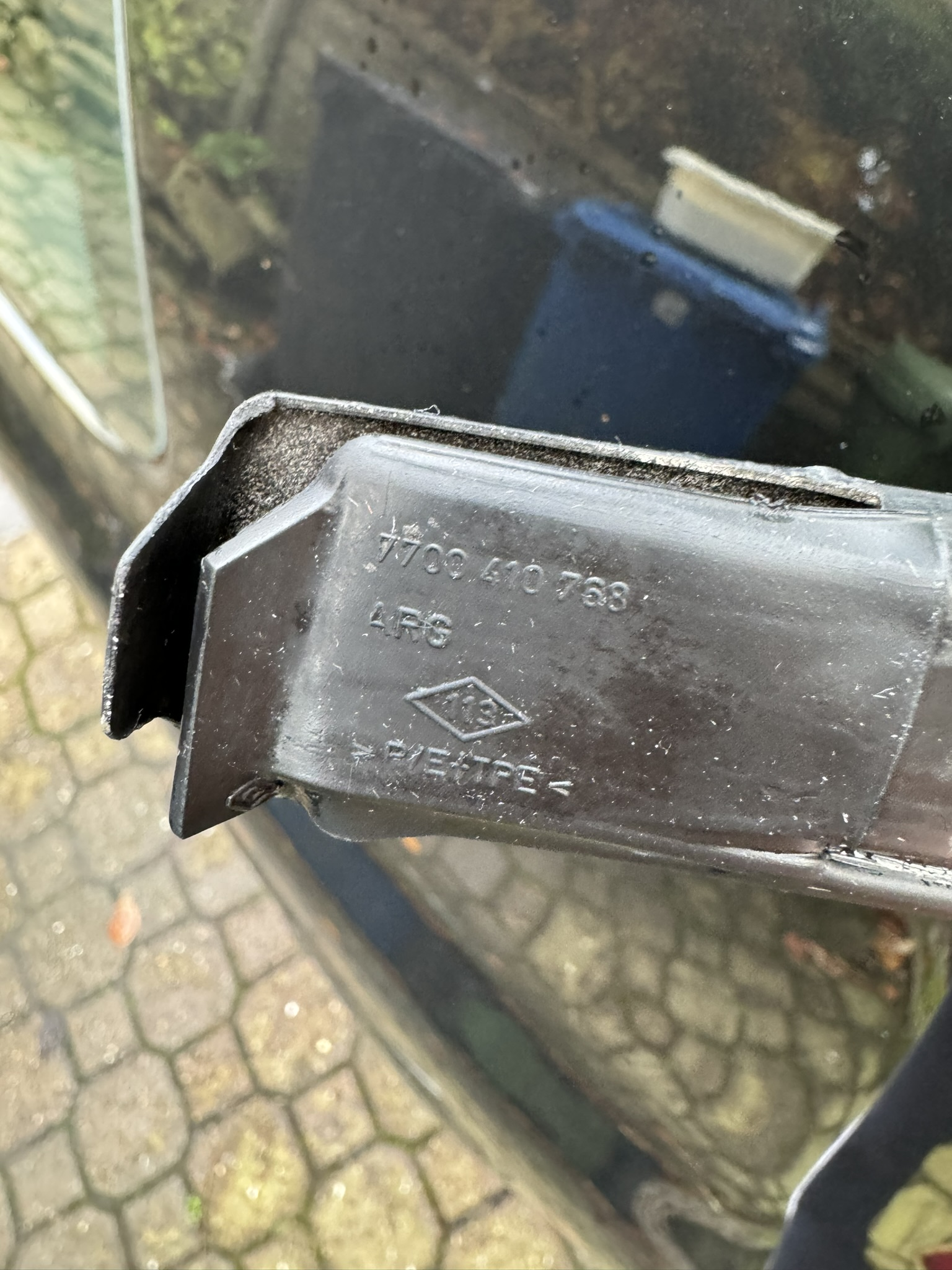

Looks like three clips per side mate, from when I did mine back at the end of 2023.
There's a small lug pin up towards the door end as well. I've added the part number photos of each strip if you needed to source fresh ones too?
Those clips are fragile!!
Oh, nice one! Thank you mate! That's just the info I was after! I think I will be ok for the strips, just the clips I think I might need.
Thank you for the clip link too mate :)
