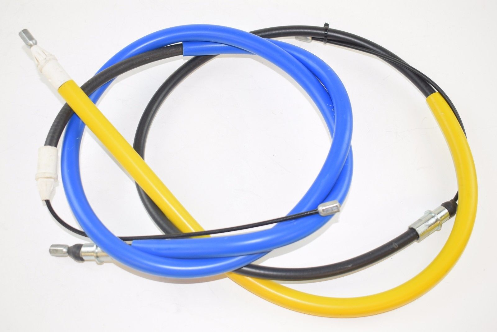

Hi guys, having a major problem finding a handbrake cable that will actually fit my clio 182 (2004).
I've bought 3 now, returned 2. I have the closest fitting one on at the moment with roughly 20 zip ties but they keep stretching.
It's the right hand side.
Could someone please link me to one that will fit pleeease!

I did mine a week or 2 ago. 1 snapped so I fitted a new pair. Did it myself on the driveway with car on axle stands.
Not too bad a job if you dont mind getting your hands dirty, the worst part was the adjuster bolt cant get much of a turn on it due to limited access.
I bought these parts :
http://www.ebay.co.uk/itm/Clio-182-handbrake-cable-RHS-Genuine-Renaultsport-11-/310331342668?pt=UK_CarsParts_Vehicles_CarParts_SM&hash=item4841307f4c#ht_619wt_1163
http://www.ebay.co.uk/itm/Clio-sport-182-handbrake-cable-LHS-Genuine-Renault-11-/310331343078?pt=UK_CarsParts_Vehicles_CarParts_SM&hash=item48413080e6
from the seller in the links above (co operative motor group) and they fitted perfectly they are genuine renault items with the correct part numbers.
I had read on these forums that they stretch slightly after a few weeks so rather than get back under there 2 weeks later to readjust it I set it quite tight 2 or 3 clicks of handbrake to fully on. After a week or two it now takes 4-5 clicks so has stretched and is now as it was before it snapped. Happy days & good luck with it.

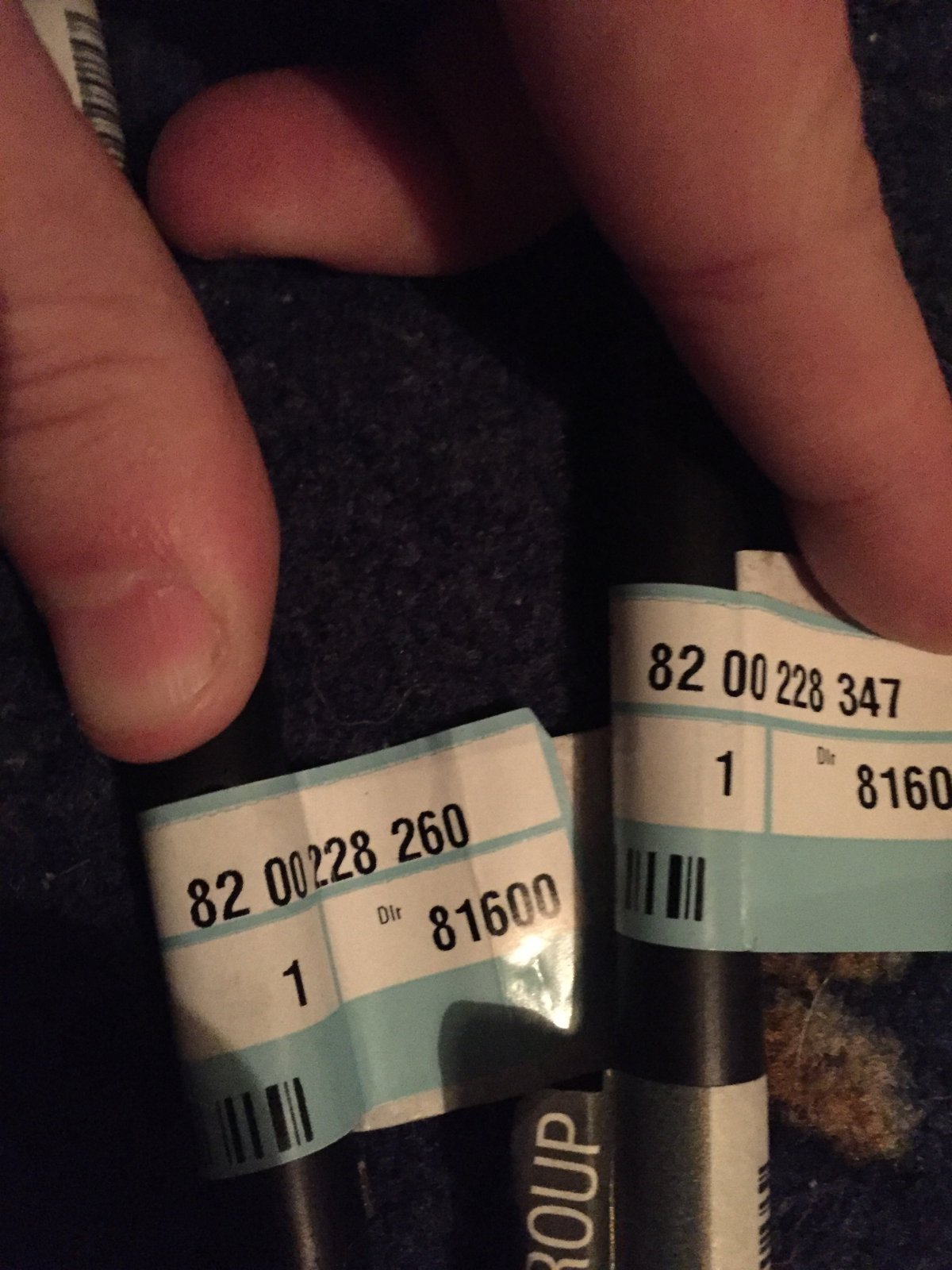

Damn! I need a set also, if you wouldn't mine mate when you receive them can you see if they are the same as the ones from EBay:up:?
Just comparing part numbers? Yeah course!
The bloke on the phone for RPD was pretty certain that the 172 ones and 182 ones are different because of different part numbers, but I trusted @MicKPM haha. No way I was paying £48 per side.

Length and end fittings if you wouldn't mind mate? 1450mm / 1170mm
Davyy
  Clio 172
Yeah, they do have different part numbers on Dialogys *BUT* they do fit okay. The 172 versions are both black cables where the 182 units have blue and yellow covers. #becauseRenault
These are 182 ones but all black, hmm!
@JB21
Part numbers are:
Lengths:
1480mm
1420mm
Davyy
  Clio 172
No idea! I ordered the ones on the link above which definitely state 182, but who knows!

The ones I have in stock at present are also all black... when they're under the car, nobody cares.
npt
  BMW 320d- 172 cup
all handbrake cables are black, they dont come with the coloured covers anymore
