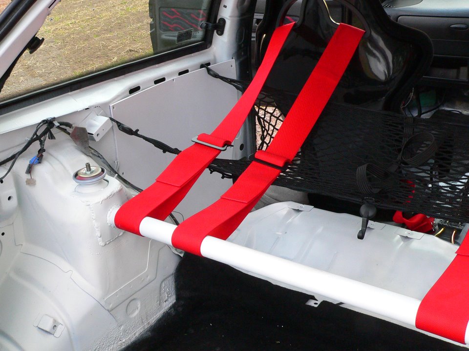

Bit of a bump here but I am thinking of having a bar welded in with spreader plate like the picture Sam posted.
Would 100 x 100 mm 3mm steel plates with standard roll cage tubing welded in by a proper welder be safe and sufficient to mount harnesses?
Using a standard rear brace is not sufficient as a harnesses mounting bar however a weld in one would be if constructed properly Ill get a pictures of a mates to show this.
Wouldn't having just the harness bar like that be hugely dangerous? If you get a strong enough impact to bend the chassis, won't the belts just rip through you, or force you against the seat to the point of crushing you? With no cage to stiffen the inside (or to attach that to), that looks dangerous as hell to me, but maybe I'm wrong :) (and of course not arguing with you, just wondered what others thought) :).

it seems to be done quite a lot. I don't think anybody would really know until they have a big shunt how well it would hold up.
Renault use harnesses in the 275 Trophy R without a cage and that passes tests etc so surely it isn't essential. Longer term plan is to get a cage.
