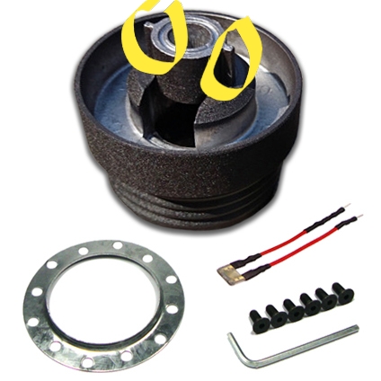

Can't offer any advice about removing the boss other than yank it lol, but with regard to the steering angle sensor, are you sure you have the correct boss? I have an OMP one and it doesn't have the tabs for the steering angle sensor so have bought a momo one instead.

Once you get the boss off the car, have a look to see if it has these two little tabs on the back that engage with the steering angle sensor. If it doesn't, you'll constantly get the warning light as it can't engage with the angle sensor.

As long as its the version with the tabs. If it isn't you'll get a traction control warning light, even if the steering angle sensor is set correctly. Mine was showing the yellow dot, but because my boss didn't have the tabs I got the light.

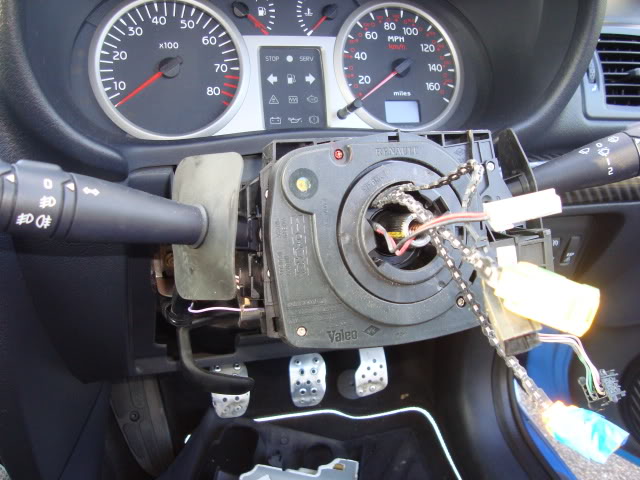

Im 100% theres one and it has no tabs. The tabs arnt needed it just makes for a smoother turn, as the wiring that goes into the boss moves the whole thing, I can guarantee the omp doesnt have this issue, I was under the impression the omp was talked about because it was just an inferior design like the CC plug or something couldn't fit through the hole but there was no issue otherwise.
You can see the wiring here, it moves what the tabs would, theres just a bit play but if its set correctly that shouldnt turn on the lights.
Not quite sure how that would work properly, but if it did for you then happy days. I had exactly the same setup (omp boss and steering angle sensor set correctly) and still had a traction control warning light. Lights went away as soon as I fitted a momo boss with the tabs.
