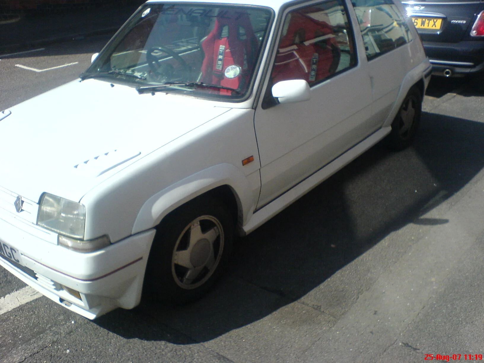

Its amazing the difference a cam makes to the dB actually lol. Got any pics of it, btw I'm on RTOC same name on there as well.
Only this one
Ill get some more 2mo. Standard exterior, stripped out completly inside inc dash. Just a make shift centre console. Purley performance! Just needs a rollcage.
