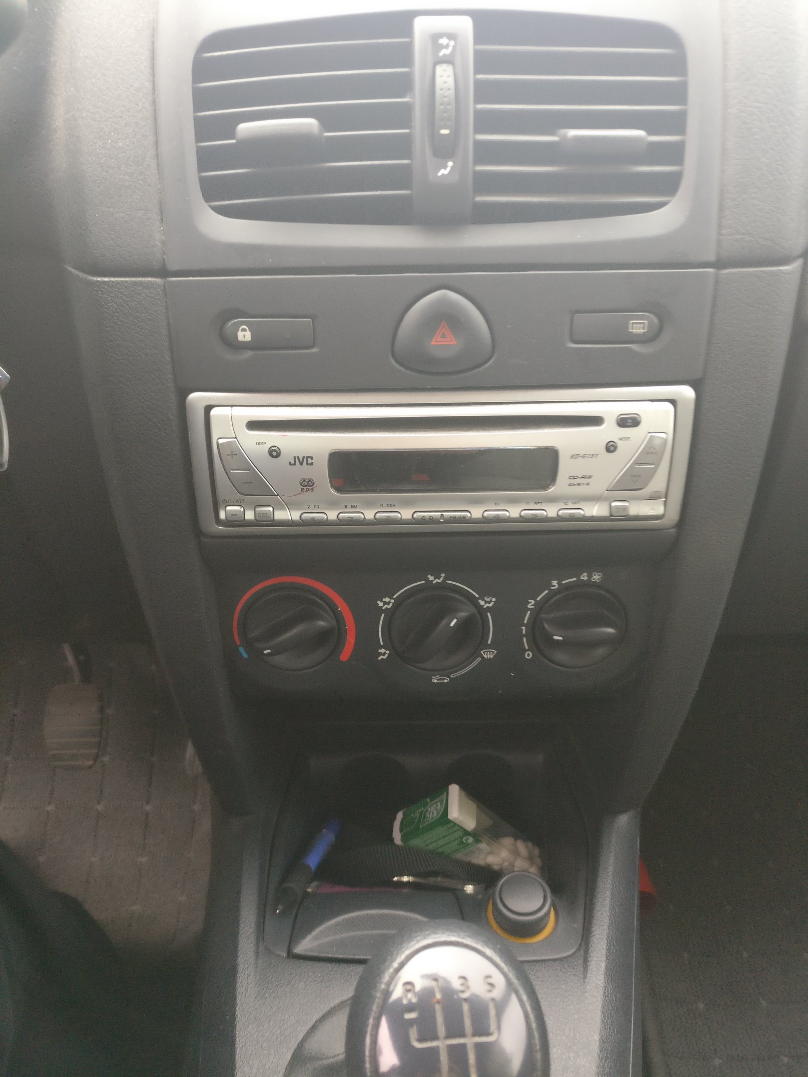

Hey,
I got myself a 2005 Clio campus
It only has a slot for a 1din head unit but I really want Android auto.
I was looking at those flip out display units but that would cover the emergency button when the screen is flipped out.
Should it be possible to switch the stereo and buttons from place. So the stereo slot is on top and the buttons are below it?
Thanks,
Greetz,
Tycho

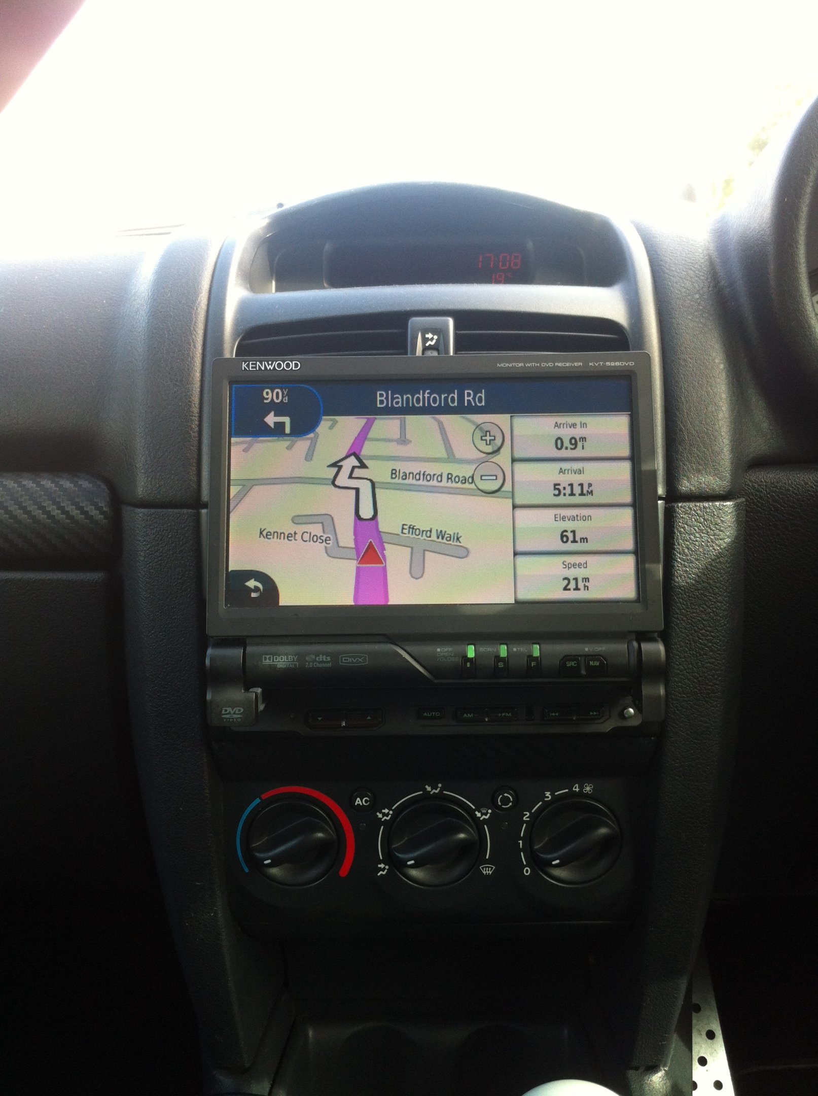

I'm fairly sure the wiring for the buttons comes up from below, so by moving the buttons further down you don't need to extend the wires.
It would require some fairly significant modification though, probably best to take the lower dash out of the car and cut the framework out and put it back together.
However, having run a flip screen unit in my clio I can't say I've ever been too bothered by the buttons, if on the rare occasion you need to use the hazards, you have plenty of room to slide your hand in behind and press the button (you can adjust how far back the screen sits, if you want). Door/demister buttons are easy to press.
That's blandford

For myself I don't mind the screen being in front of the buttons as you don't use those very often but it's the examination that I'm worried about. If they check the car and when they start it a screen pops in front of "important" functions of the car. I don't know how they'll respond

My Clio did not come fitted with a stereo out of the factory so the previous owner installed the unit seen in the first post
