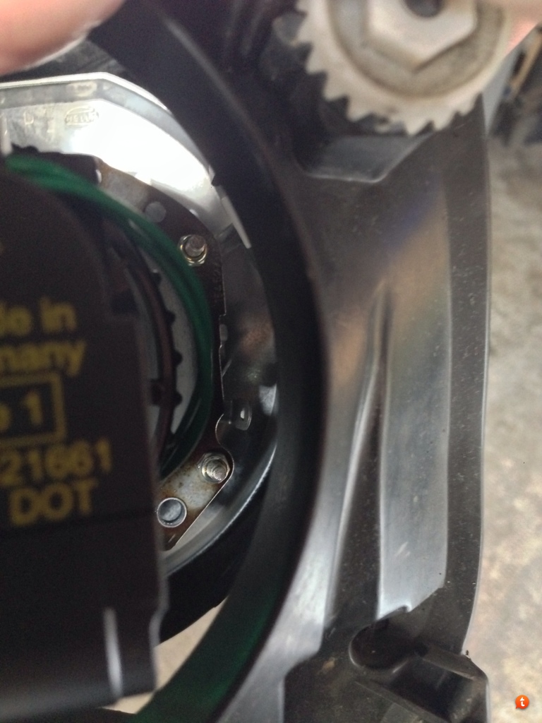

There's a little bit in the back of the projector unit that moves. Can see it here, it's the little bit sticking out just above the lower of the two bolts:
Just flick that up/down and it'll flatten the beam pattern, instead of it having the flick up at the left.
I'm pretty sure that's all that needs done for EU driving anyway

Is this easy to get to with the headlights fitted to the car? There isn't a lot of room behind them!
Alternatively has anyone fitted eurolites beam deflectors? I bought some but the fitting instructions for mk2 clios only cover halogen headlamps, not xenons.
