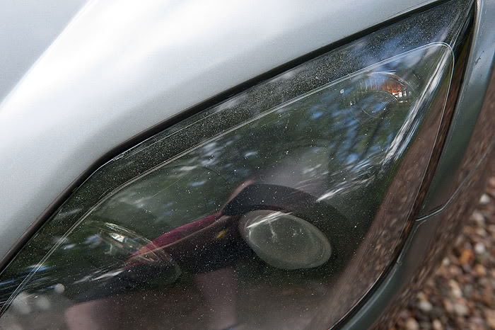

This is what they look like:
Can I fix these with the normal procedure? Wet sand followed by a damn good polish?

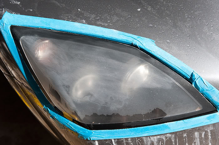

to this
its worth doing it with a machine polisher if you can get hold of one as mine only took me about half an hour to do both but by hand, you will be there for hours.

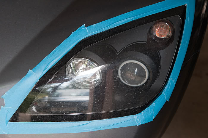

Had a go this evening instead.

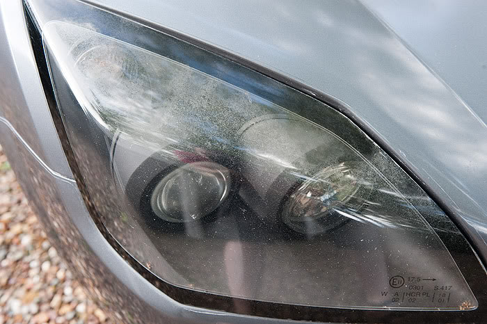

I started of with 2000 grit, as I didn't want to go nuts!
This is the offside light, which was/is the worst:
Before:

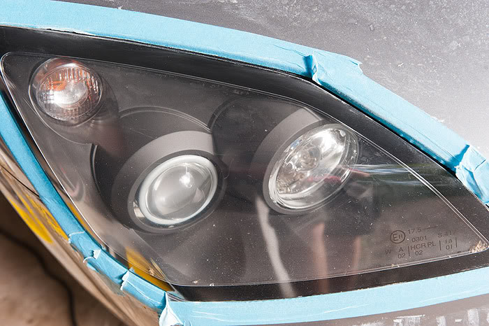

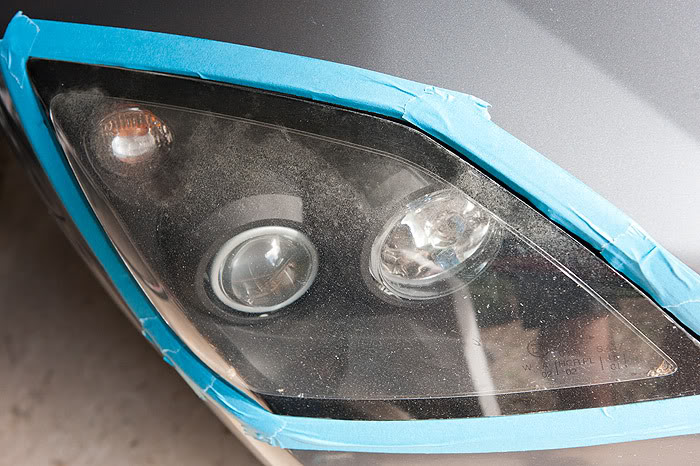

During:

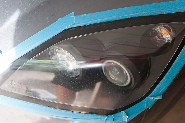

After:

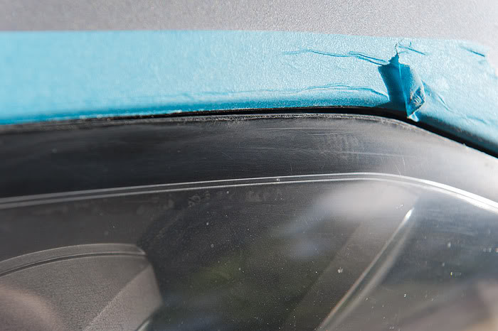

It's not 100% corrected, I struggled with the bits near the edges, like here:

The car's still in the garage, so I'll do another pass tomorrow to finish it off.
Thanks to those that helped! :)
Compared to what it looked like before, I would be happy to leave it there but as I've got oodles of time next week, I'll give it another go.
I just used 1500, 200, 2500 grit wet and dry, followed by G220 with menzerna power gloss.
good job there, how long did you spend on them? think it needs more polishing! :) but looks great compared to before mate

I'll polish it better tomorrow, just need to be a bit more thorough with the 1500 grit tomorrow.
