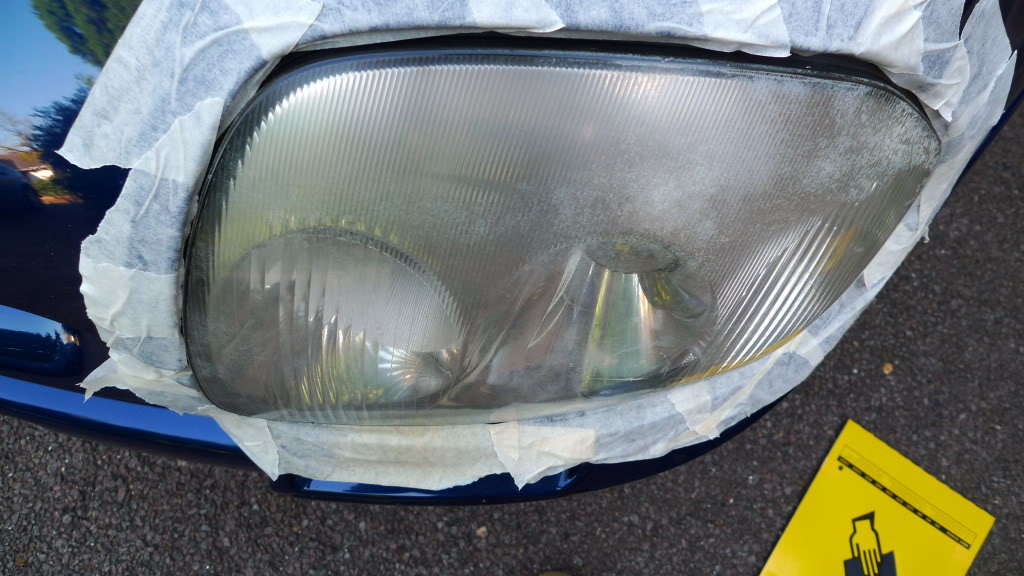

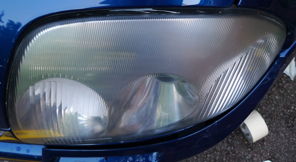

I cleaned the beast the other day, and she looked really shiny and clean. but her headlights have been p*ssing me off for the couple months I've had her. All hazy and rough. the pics are sh*tty but I think you can see it.

So I decided to set to work on them yesterday, 1200/1500 wet and dry, scratch x, autoglyn SRP and megs cleaners wax.

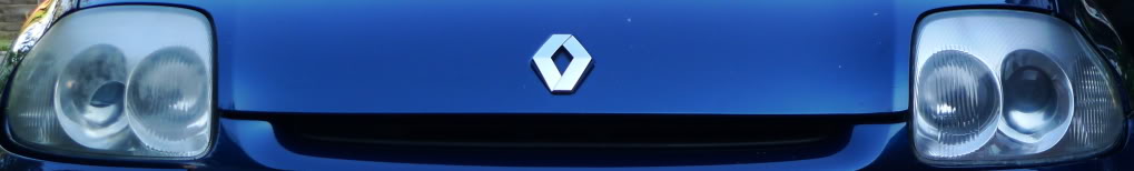

Before:
Uploaded with ImageShack.us

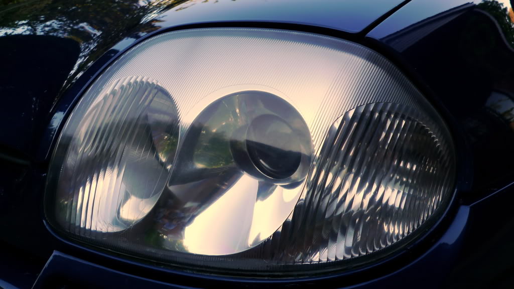

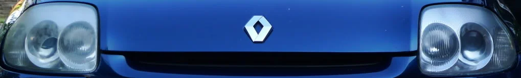

After:
really happy with how they came out to be honest. massive improvement.

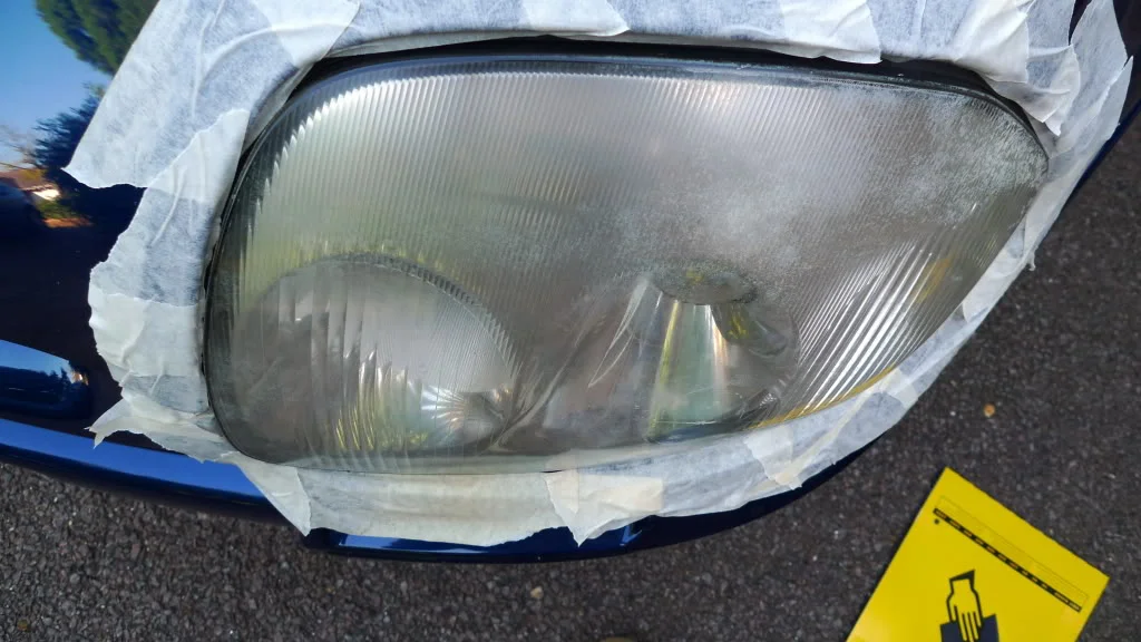

  Ph1 172.

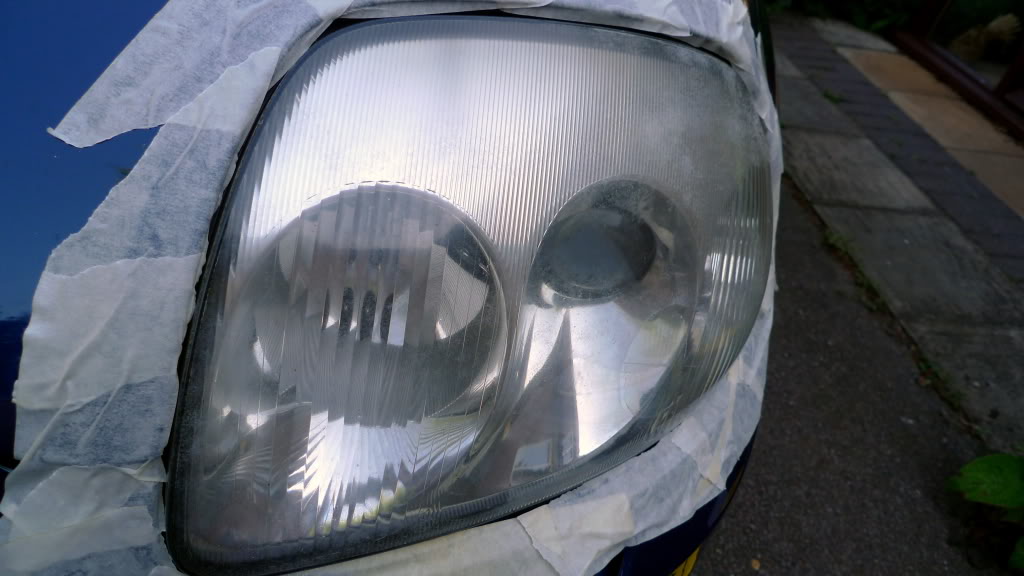

I gave this a go tonight. it took 2 hours just to get one done. I'll do the other later in the week:
