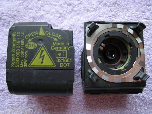

If so, then this isnt the problem, That works fine.
Underneath the light unit, there is a silver box about the same size, it is this i have been told to replace. I shall take a photo, as best i can tomorrw, if needs be.

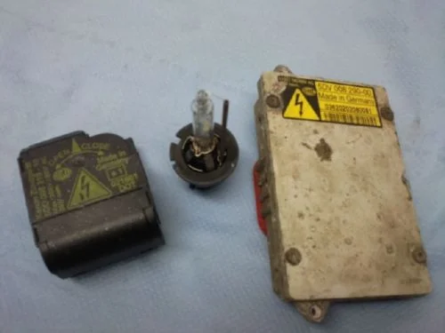

I think iv found a picture of the complete set up: !ByZ2QTQB2k~$(KGrHqIOKjoEwPVuSH7uBMRjqPJ(E!~~_12.JPG
I 'think' i need the silver part.
Could you explain what each part is and the location of it from left to right? :)
  BMW 330cd
from left to right on the last pic, you have the ignitor, xenon bulb and the ballast pack, sounds like you need the ballast pack. some on ebay £50 plus post
Thanks fella :)
