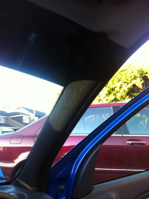

How easy is it to re-trim the headliner? I did my pillars and found it was very easy, now I want to do the head liner...the only thing I found was the centre section is held up with some type of tar.
Can it be done without taking the liner out?
Heres a pic of the door pillars I did. Was a case of just spraying glue on and pulling tight:
You need to remove it to get a good job. Its not difficult though but the clips for the sunvisors and grab handles will need replacing as you have to break them to remove them.
