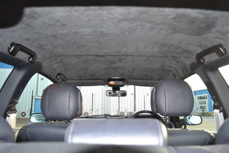

that was mine
Alcantara roof lining by matt eaton, on Flickr

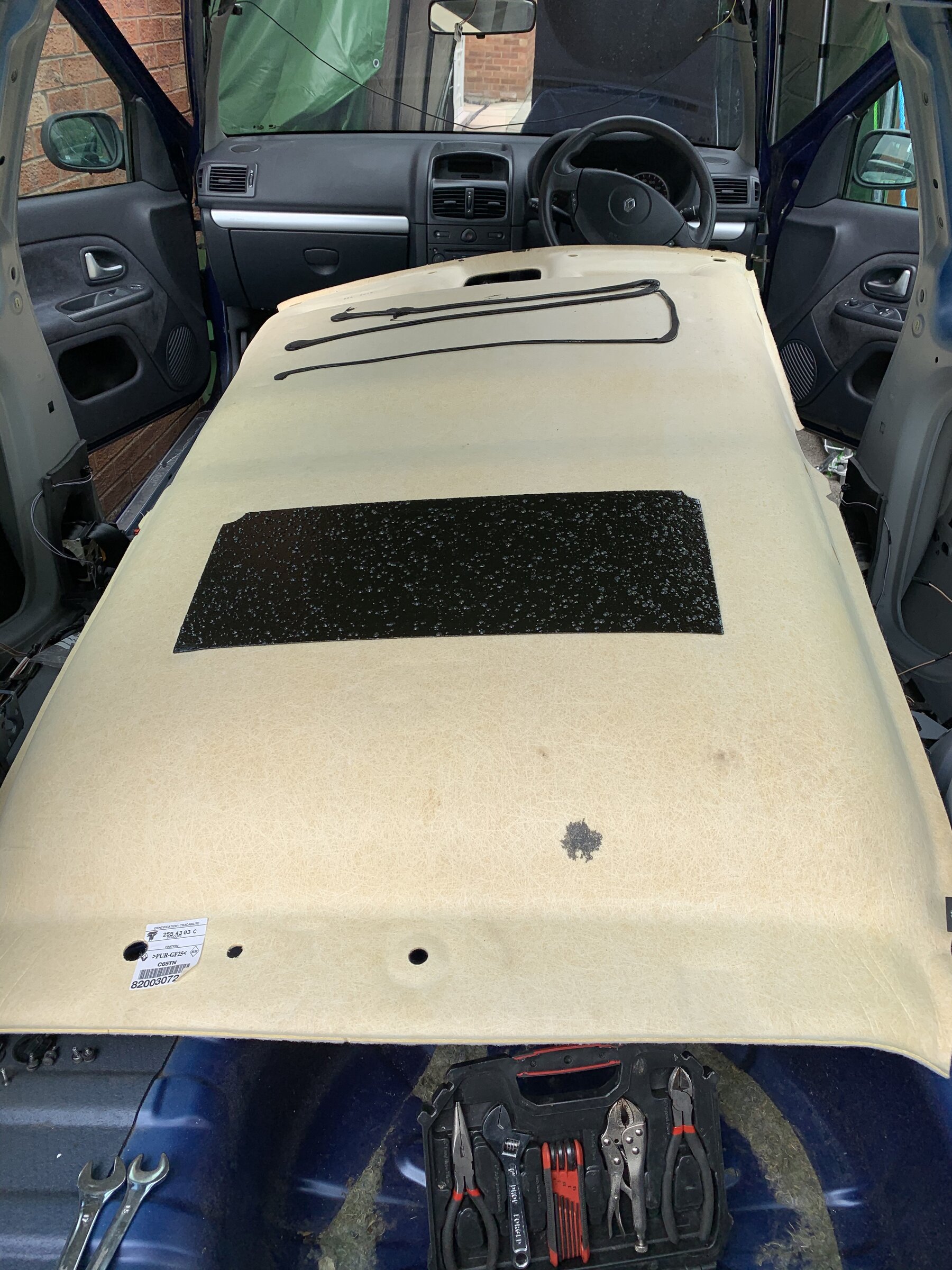

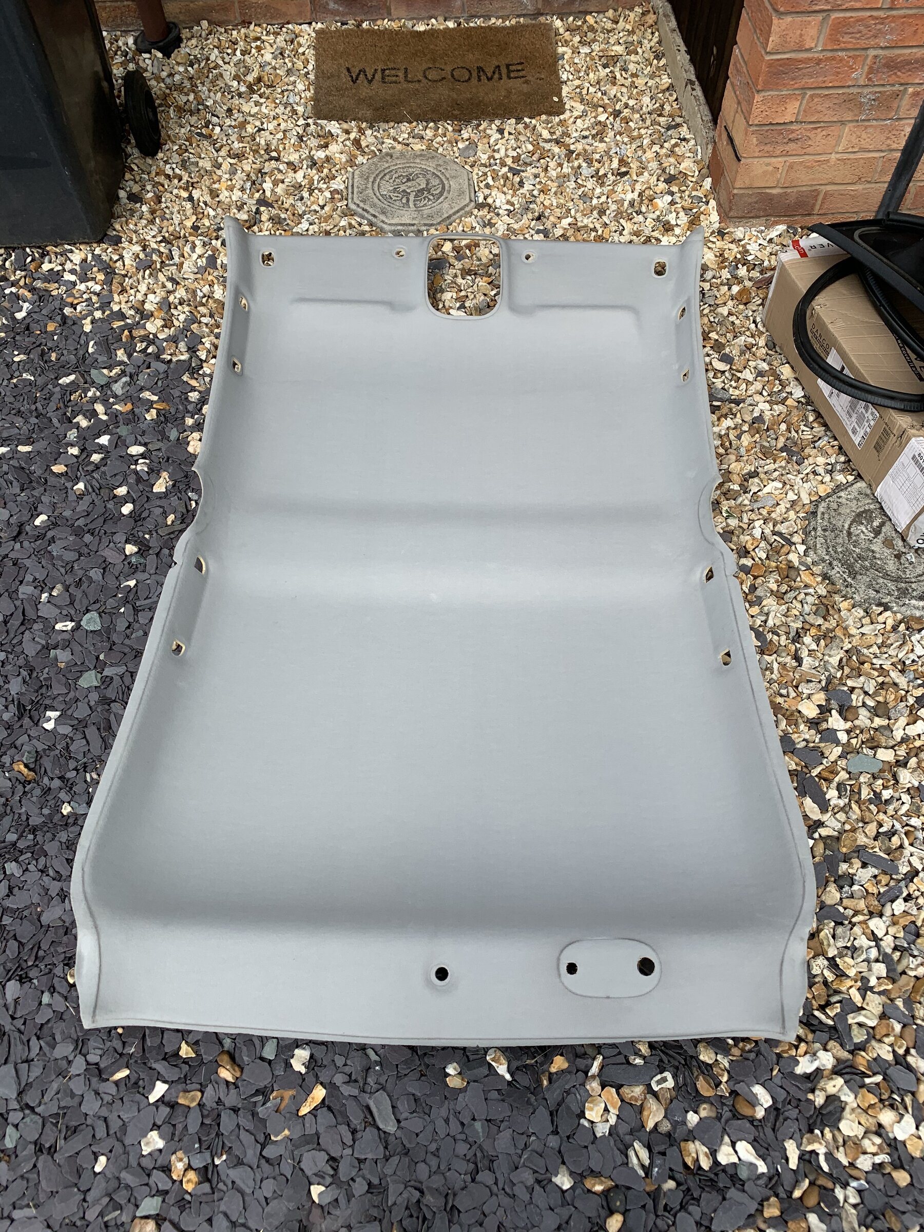

Since I’ve just removed mine figured you might find this helpful.
It’s glued on however if you wait until the roof is hot from the sun it comes off easily.
