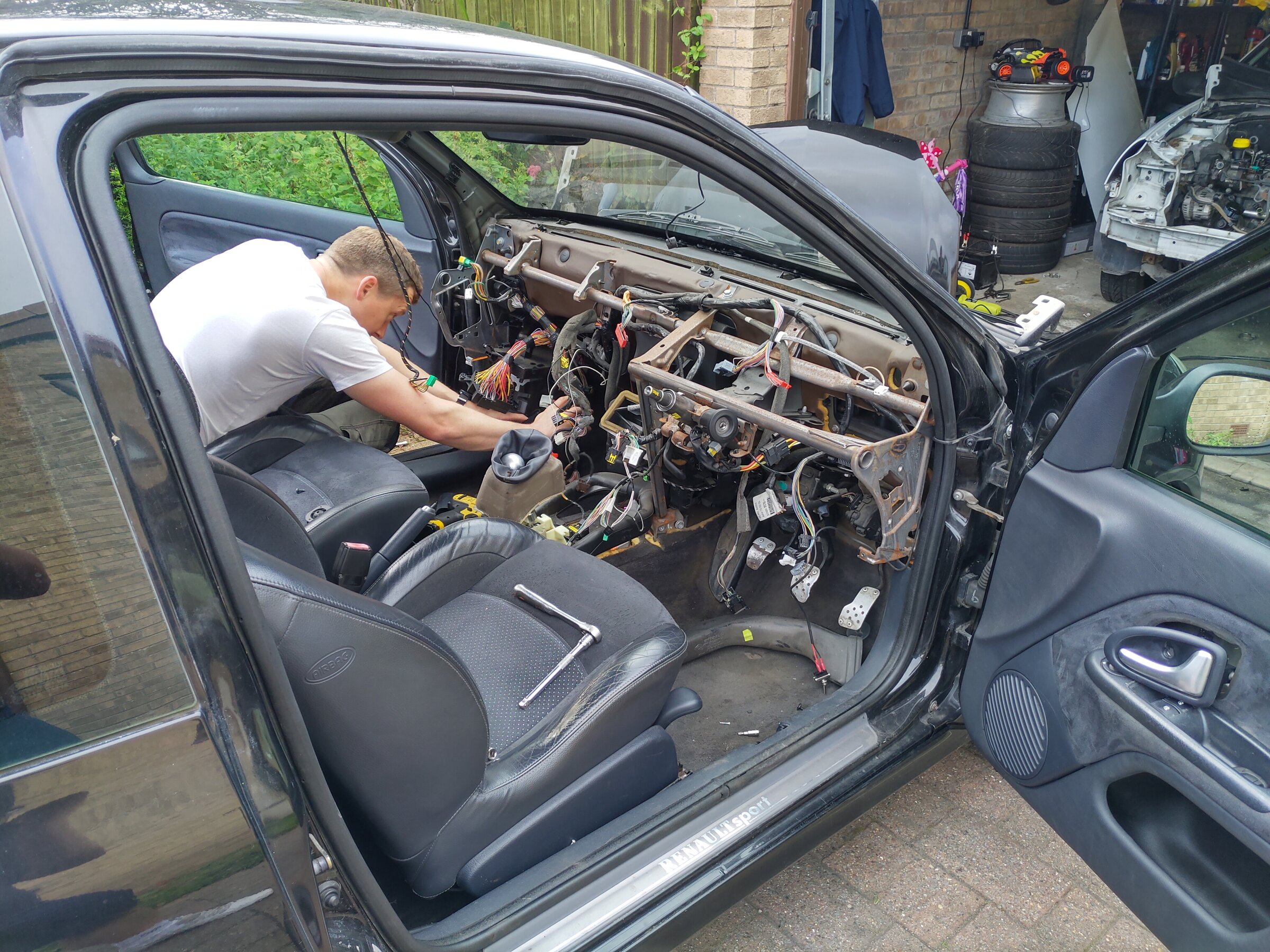

Steering wheel will need to come off along with the squib. Basicly pulling the entire front of the interior apart. Good luck :)
Martin_172
its actually not a bad job removing the dash, just time consuming lol
dash top off
dials out
steering wheel off
radio out
trim that goes around the gearstick and houses the cup holders etc out
disconnect connectors from hazard panel, cruise control panel etc etc
disconnect connectors from climate control panel
unbolt all the bolts from dash (take pics on what way cables and earths are routed to make it easier to reassemble but generally they all seem to logically go back where they should.

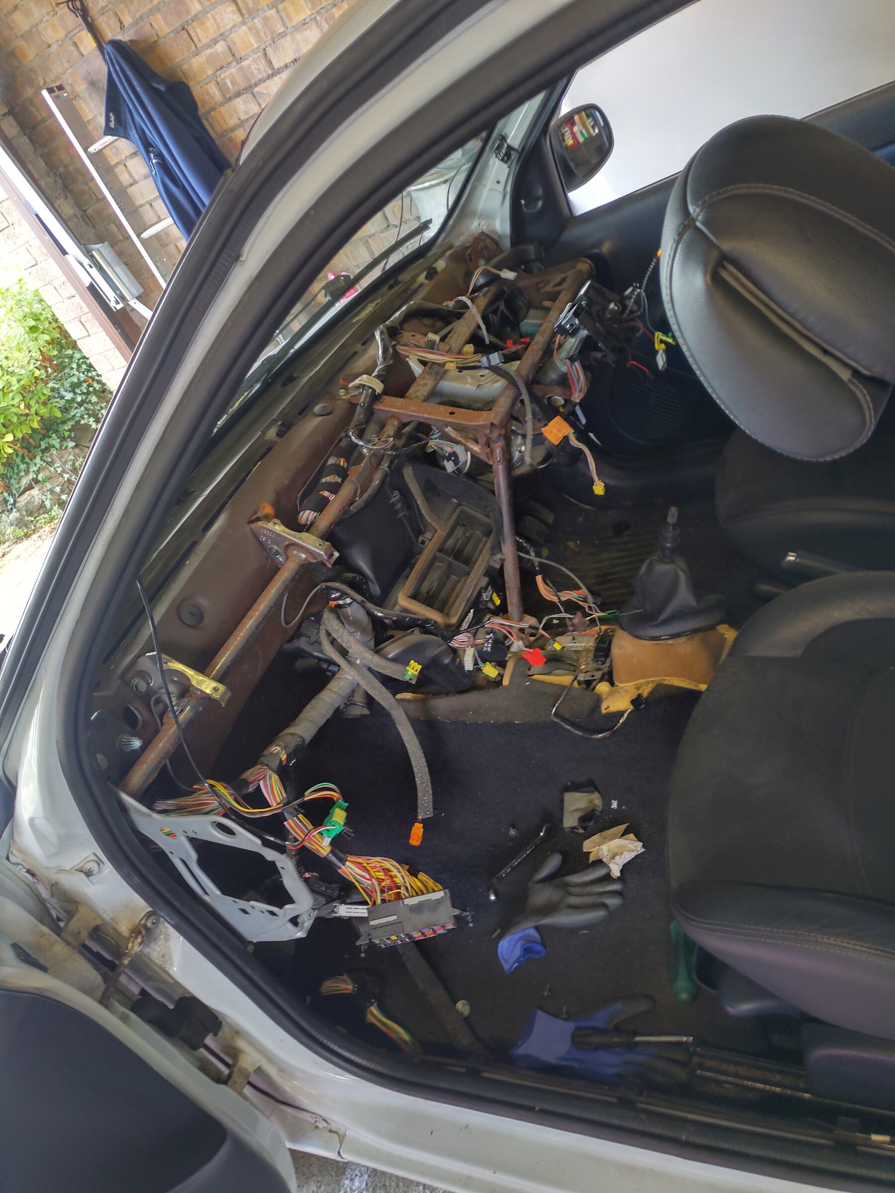

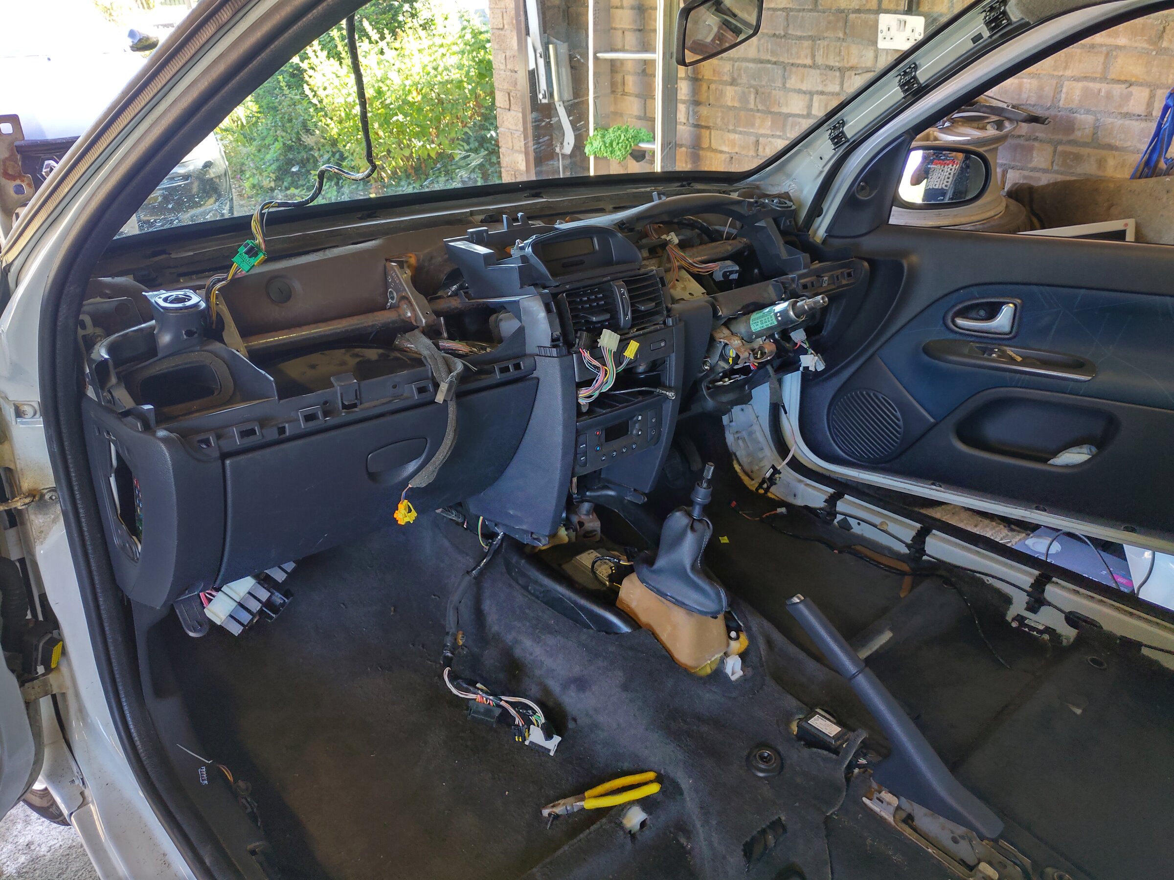

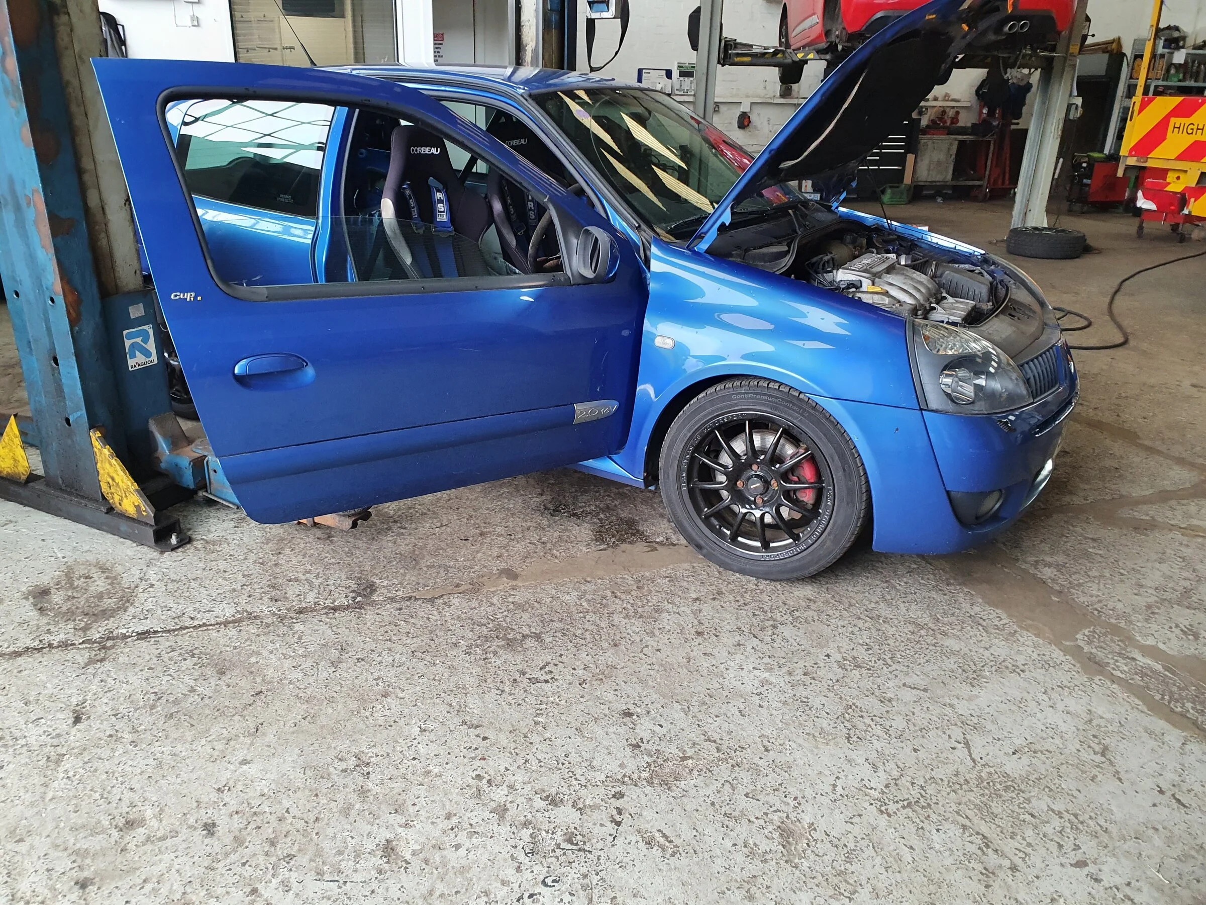

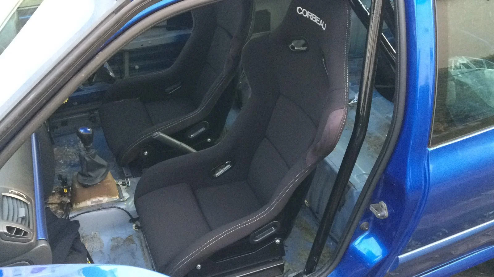

Sorry guys just seen all these messages. Thanks for reply. Yeah it shouldn't be that bad as mostly all the interior is already out of the car as it's a track car. Thanks @ Martin_172 David172 and ZachB

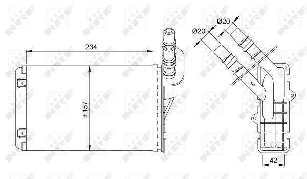

I also have changed the heater matrix on my clio 1.2 16V 2005. But now i am experiencing leaking from the hoses that sticks on the plastic tubes on heater matrix. I have looked inside and saw 2 oring. Does any one know what dimensions are they? the plastic tubes on heater matrix are outer diamete 20 mm so im thinking the orings should 19 mm or 20 mm. Any help is much apreciated.
