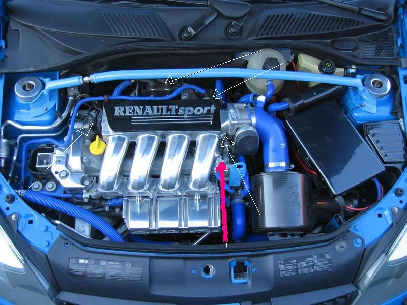

On the picture (not my car!) I have arrowed the bits where I've reconnected cables.

Do you mean where the throttle body actually is?
There is a cable to the left of that and it connects into the arrow that I've now marked pink?

yeh, to the right of them arrows! grey boxy thing with writing on it! beetween the polished bit and the blue filter hose!
