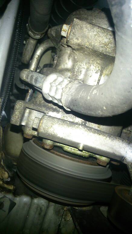

Can't find any leaks on the system when I spray it with soapy suds however I did notice slot of green residue on the underside of the compressor just on the front near the pulley.
Could this be a leak?

Is been and it held pressure but leaked out during the week. Does the green residue on the front of the compressor look like a leak

Like I say there does seem to be some green residue on the compressor where the pulley is.

Yeah that is likely to be PAG with UV dye leaking from the compressor but you may have other leaks to so it would be prudent to fully inspect the system.
Always replace the seals to... always!
