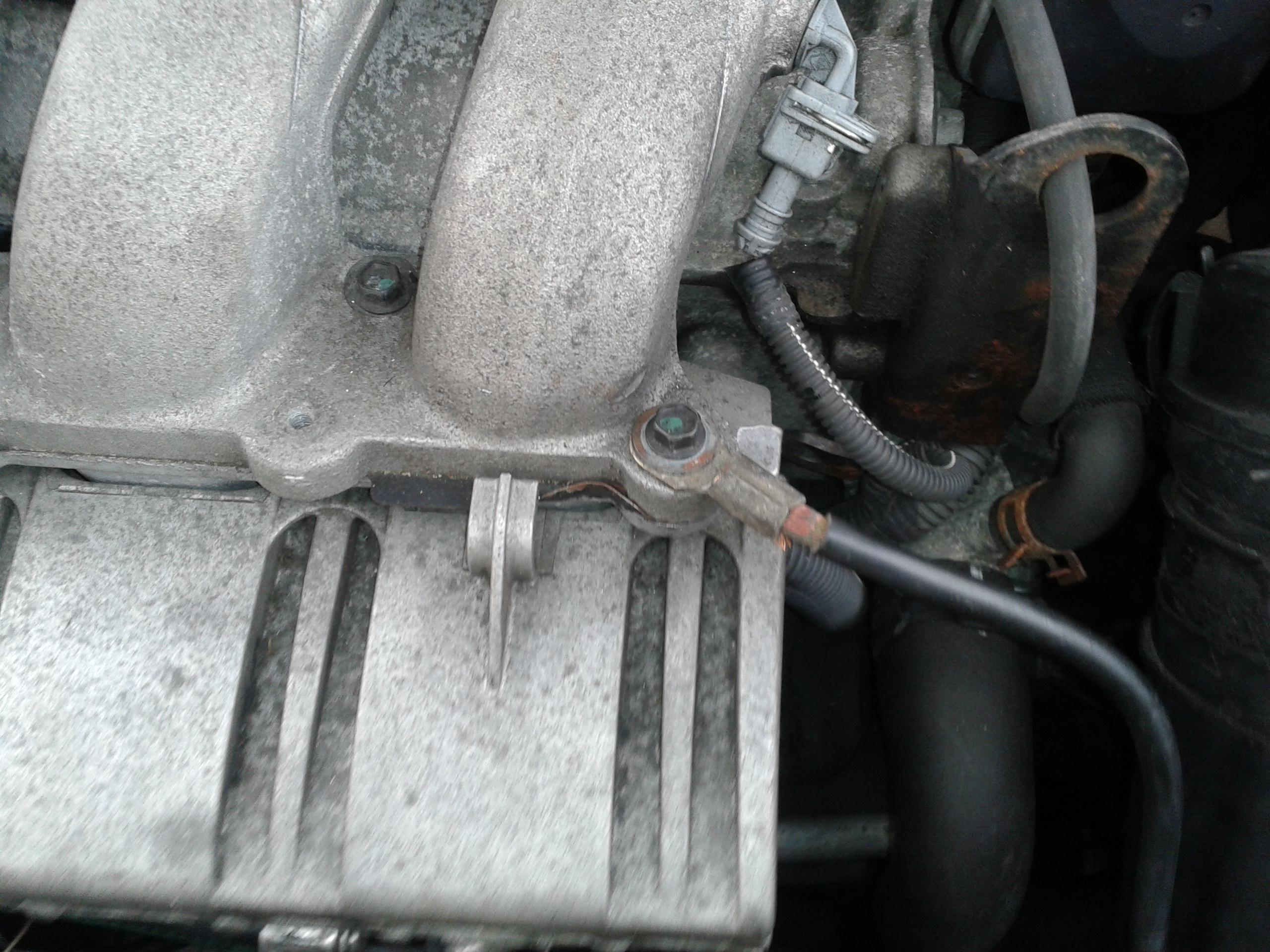

There is a gearbox loom earth underneath the battery that can suffer corrosion.

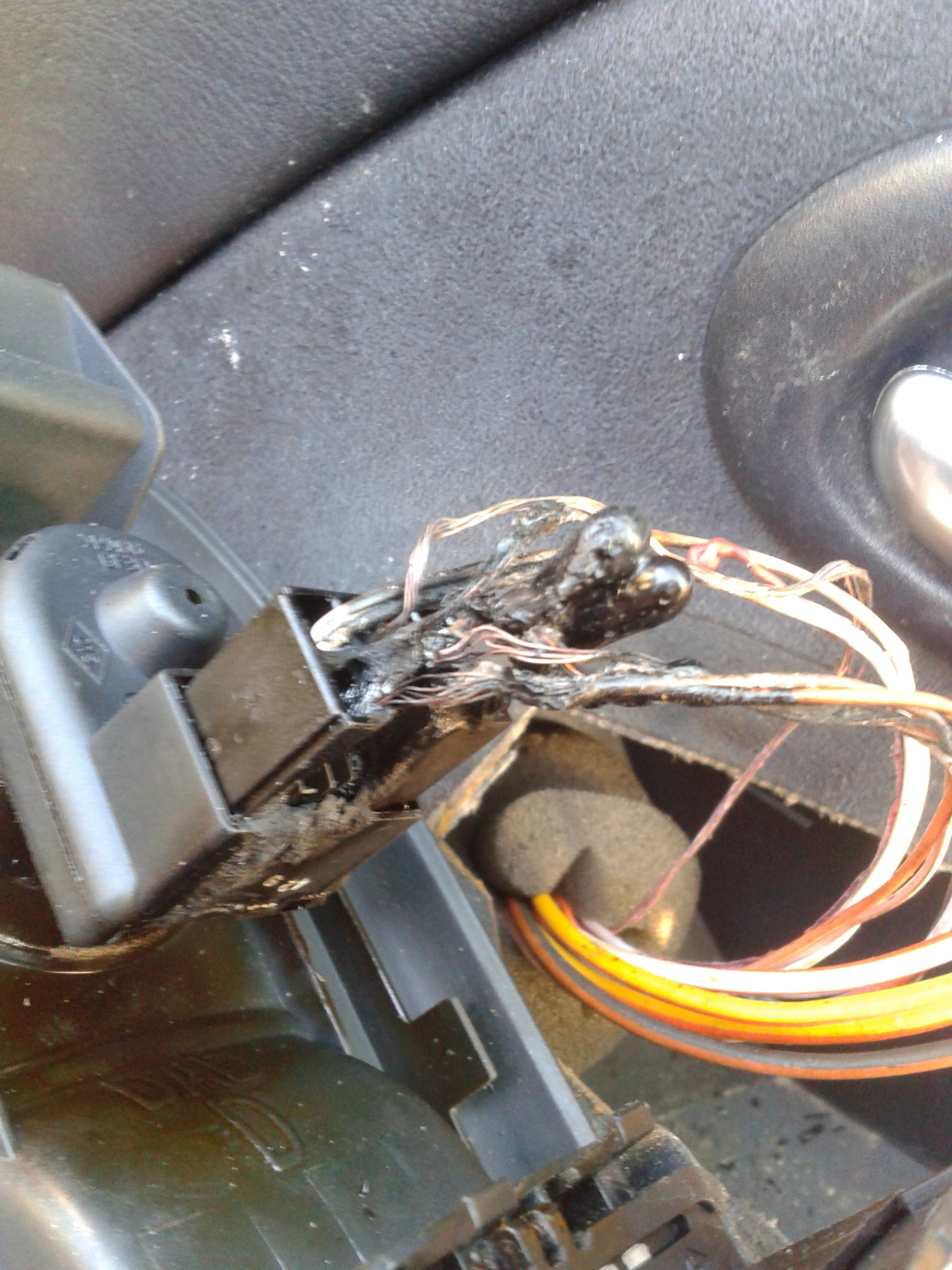

I had a mirror switch cook itself for no apparent reason, which eventually blew fuse 29, but must have been drawing current before hand. Worth disconnecting on the off chance.

Interesting you had a mirror short out, i will try and disconnect mine

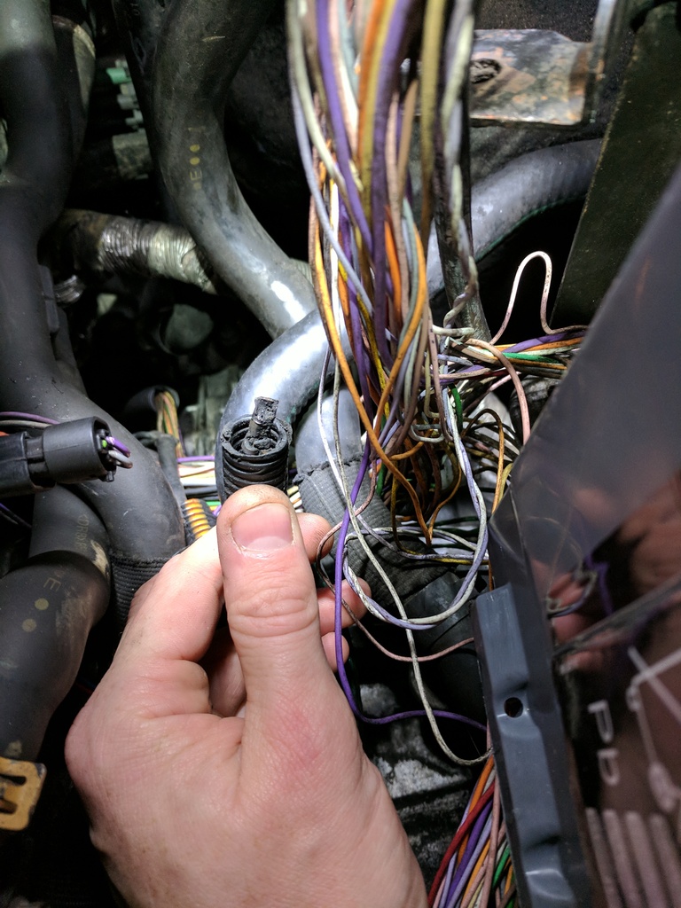

The parasitic drain was a poorly chock blocked wire behind the radio, so sorted that.
