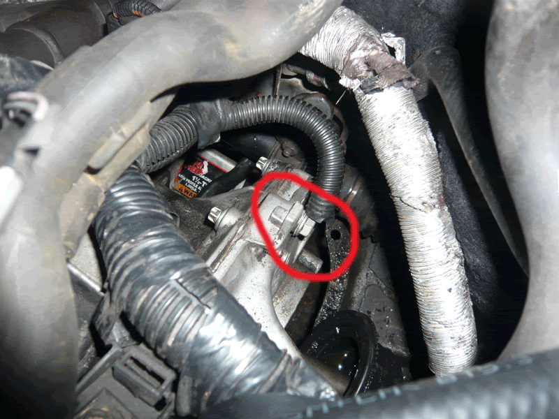

Well......after leaving it last night I decided to go back to it this morning with a fresh head.......good job I did....10mins later & the engine was running!!!
The problem.......well other than my eyesight.....was this b*****d engine earth at the rear of the engine wasnt connected....
Connected it up and she started first time!!!
Panic over....yes I'm an idiot before anyone says but I didnt even remember that earth was there - probably doesnt help that I took it apart 6months ago though!
