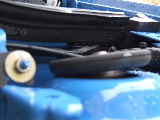

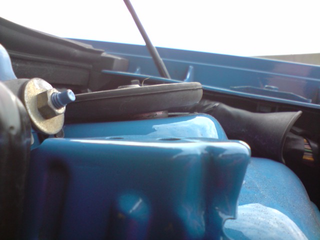

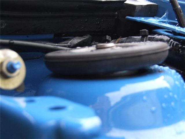

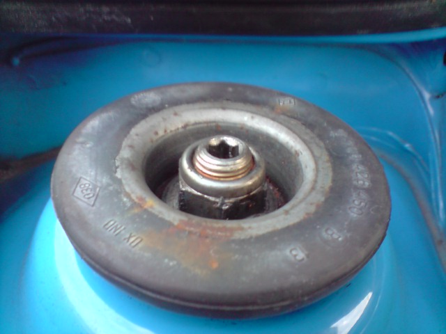

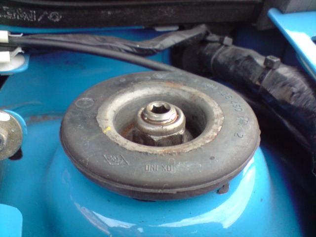

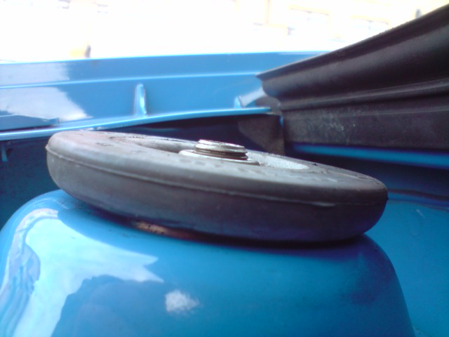

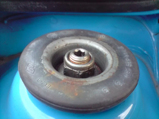

Had the H&Rs on about a fortnight, then yesterday when reversing out the drive there was some banging from the engine bay and some weird feedback through the steering.
Popped the bonnet and saw that the strut tops don't sit square in the engine bay, and they move oddly when you turn the steering wheel.
Pic 1 - Left strut, steering wheel straight ahead
Pic 2 - Left strut, steering wheel turned full left lock
Pic 3 - Right strut, steering wheel straight ahead
Pic 4 - Right strut, steering wheel turned full left lock
Is this normal? If not are solid top mounts the fix?
Basically - help! Don't like driving it when its doing this, can't be doing the car any good.

If you mean the nut, then yes. Had a garage spanner check them.
Its the angle of the coilover unit, its not at 90 degrees to the ground (i realise it wasn't exactly 90 as standard)

i think you should get your camber + alignement setup , really neccescary after lowering.
when i fitted my H&r set the car was almost undrivable !
I think this is the situation putting some stress on your topmounts there

when i fitted mine and we backed the car out of the garage you could really hear the tyres squeeling on the tarmac because of the camber that was way off , which means automatically tracking is also way off . This sounds to me like the struts can also put this sress on your topmounts + could well be why they look like that and give the clunking noise

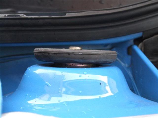

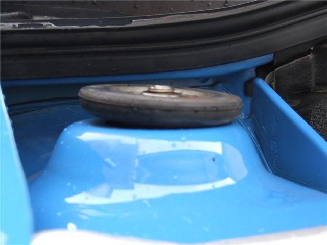

Shaun, as per our conversation yesterday, heres some pics of the top nuts along with the current position of the top mounts while parked on level ground with wheels pointing dead ahead.
Cheers mate.
