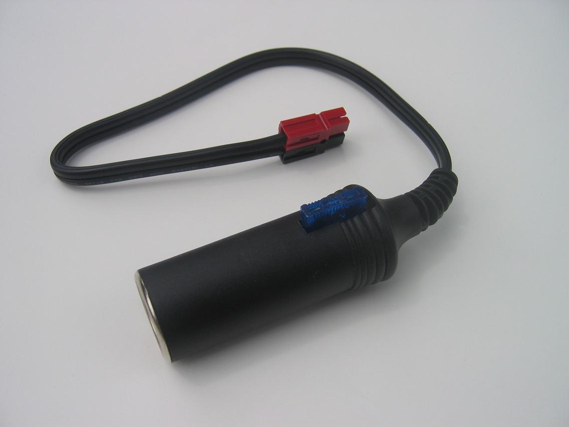

you need a molex plug/female cig lighter and a wiring loom with an inline fuse
fuse rated to no more than 5 amp but preferably the same rating as your product your fitting

depends where you get it from but just cut off the plug and solder on a length of cable rated highly enough and then make sure to add an inline fuse then splice into a feed from the fusebox.
depends where you want the plug i had mine in my clio underneath the dash cable tied in place
