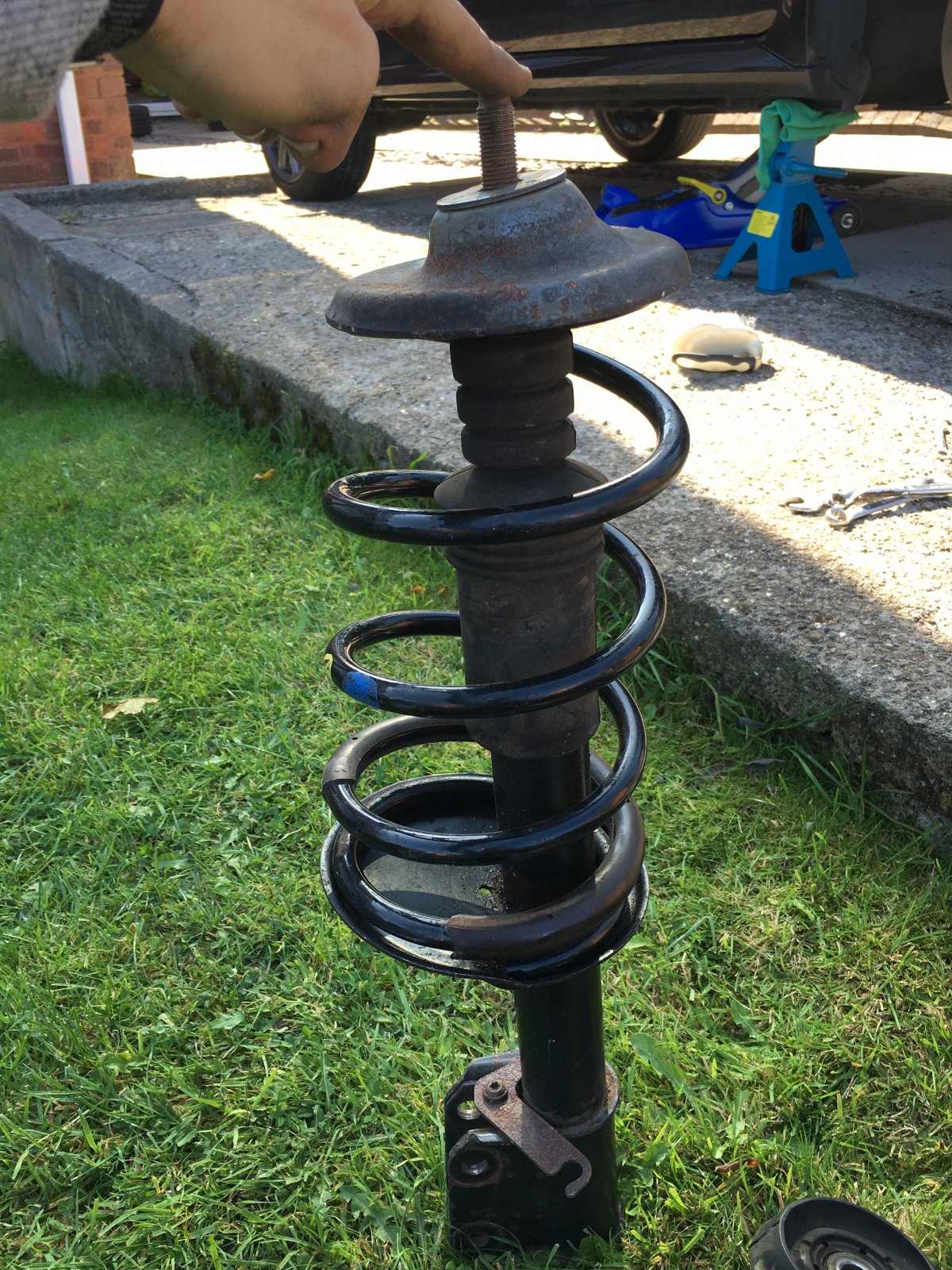

On with the front now and so far it has been easier than the rears, but im stuck with this and dont know how to remove it.
Remove the 17mm nut that holds the top mounts on.
Keep all the parts of the top mounts together and also the nut. Take not of how it all goes. (Bearing at the bottom, then rubber cup, then sleeve through the the top.)
New springs sits on the bottom cup of new shocks. Place top cup on. Make sure it's all sitting correctly in the cups. Place top mount thats all together on the top cup.
Push down on the top cup until the thread is shown and place the 17mm nut on top. You don't need spring compressors, juts a bit of muscle.

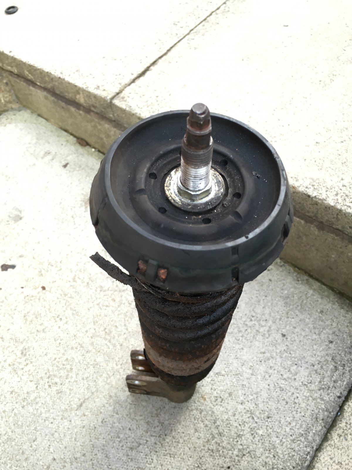

Force. It will come undone.
Get someone to hold the shock while you undo the nut. Even hold the spanner on the nut and hit it/use another spanner to loop/extend the spanners so you have one long one for extra leverage.
It just twists the shaft. So you need 2 spanners on it at the same time.
OK. Does it have allen key tips on the coilovers?
Forget that, just looked at the pic. Use a spanner/adjustable spanner on the top of the coilover stem and then undo the top nut.

Will try again tomorrow but thats what i was doing earlier and there was no moving at all
Im thinking about buying some new top mounts but i assume they wouldnt come with the bolt i need off the coilover...? If not, does anyone know if i could buy this bolt seperatley and what size it would be?

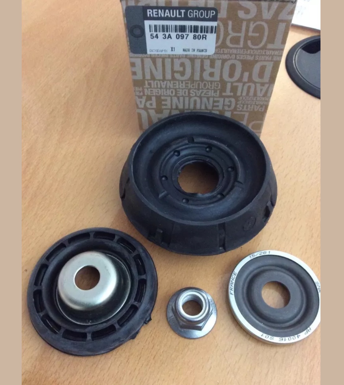

The ebay ones are the revised part, the top mount rubber sits higher so it does not touch the body work when cornering.
The nut is m14X1 according to Renault so quite fine for a nut of that size, i edited the above.
Euro will be the old style.
and the nut has to be bought on its own

Am i getting confused here.
Ok, so the ebay link with the picture, that appears to be missing another bolt doesnt it? Or is that a new design where the bolt is seperate to the very top piece of the top mount?

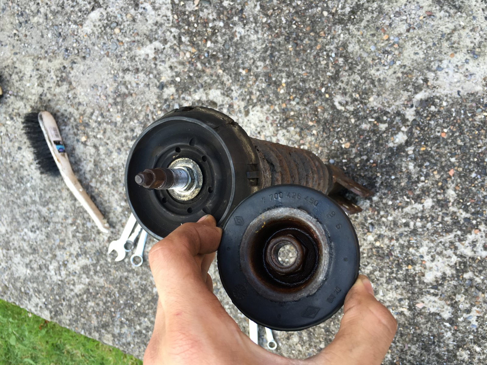

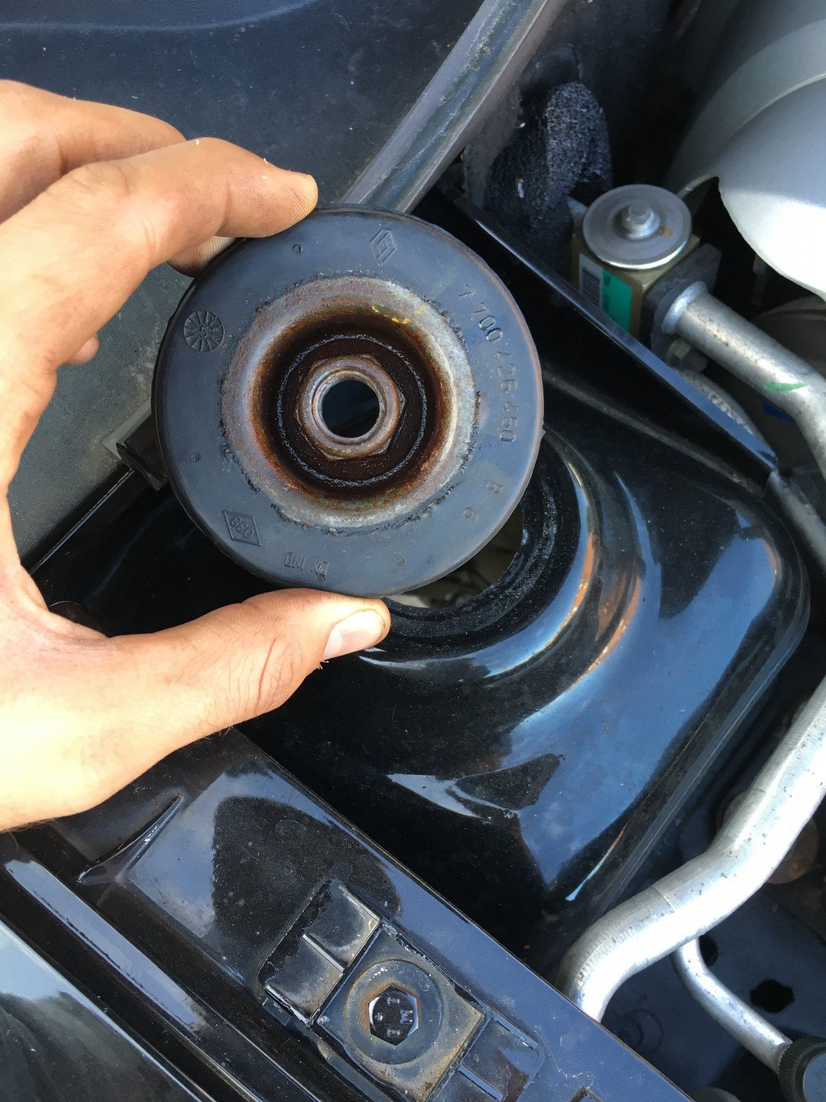

Look at these pictures. My very top piece of top mount is all one part, it doesnt have a seperate bolt.
So its the bottom piece of the top mount that keeps the spring / metal cap in place that i need the bolt and cant get it off.

Thanks for your help mate. So, the bolt pictures in the ebay add. Is that the bolt for the damper /springs / metal cap and lower part of the top mount. Or is that the bolt that is the very final piece which you would see from the engine bay keeping the very top part of the top mount on?
Its the one you see from the engine bay and the bolt is separate on the new design.
I know renault say the tread pitch is 1 but looks like a 1.5, so would be worth checking as you may have some laying around.
Thanks mate. I cant work out why they are not sold with both bolts that you need then. So the bolt pictured on ebay advert is the very top part.
The bolt on my coilover currently that i need and get get free seems to have a collar piece on it too and not just a straight forward bolt. Unless im not looking properly.

That nut on the coil over is pain to remove as it likes to round off, if you can hold the top part of the shaft in a vice or with a spanner and put a ring spanner on the small nut then hit the spanner with a hammer it may crack lose or it may round off.
That collar peace is separate from the nut its called a half nut.

Update:
I took it to a garage and they took the nuts off for me in 2 minutes. I had £3.50 in my wallet and gave them that for helping me out. Ha

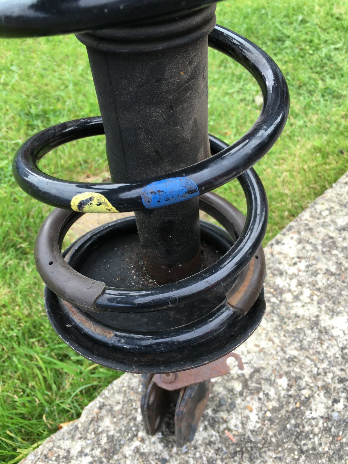

Problem i now have is the top cup seems to be slanted but im sure the springs are linged up correctly.
