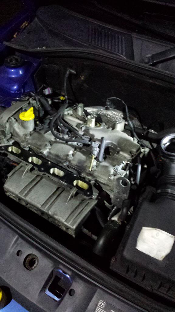

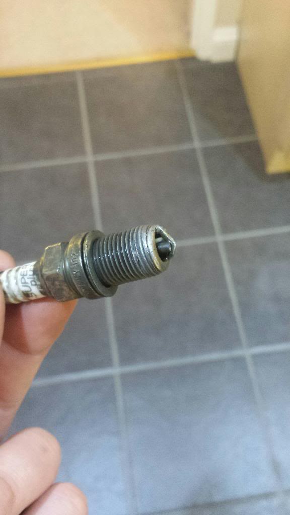

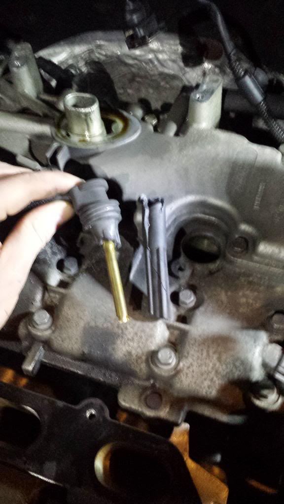

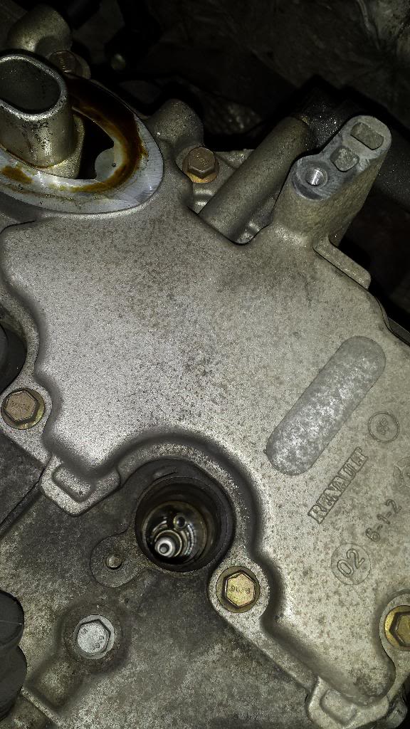

Just took the manifold off and sure enough its blown the spark plug out. I have taken some pictures of the damage and will post them up shortly. Looks like the top half of the thread in the head is nackerd aswell :(

Unlucky but you better check the others are secure to before the same thing happens.

I took all the other plugs out.. to be honest none of them felt very tight! Is it just them coming loose that causes this to happen?
Yeah i tried one of the other plugs, screwed in one turn the went tight.. didnt want to force it. Looks like there is some damage to the threads but the threads further down look ok. Any chance of just tapping a new thread?

Sounds like they've been put in but not torqued up. You may be okay but ideally it needs a timesert (i hate helical but this would work to).

Plugs should be NGK PFR6E-10 and to timesert the head would need to come off.
