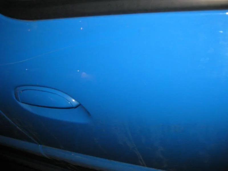

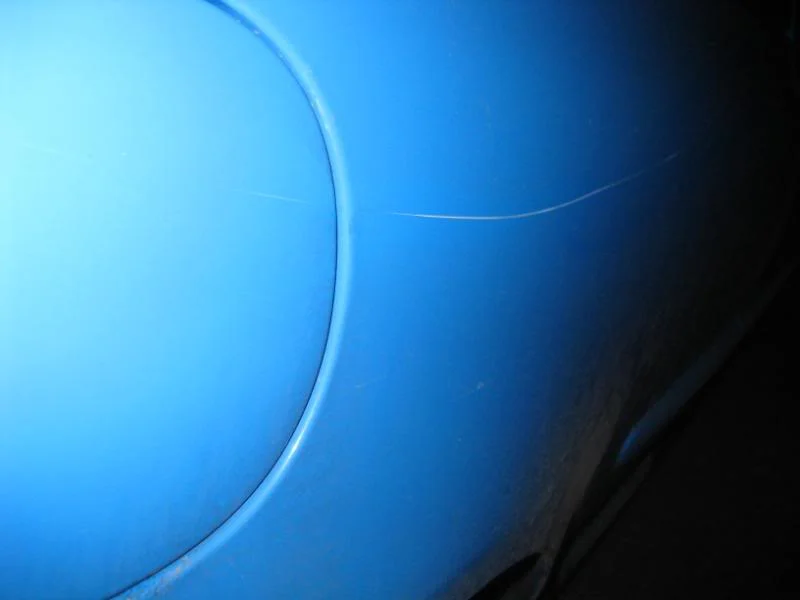

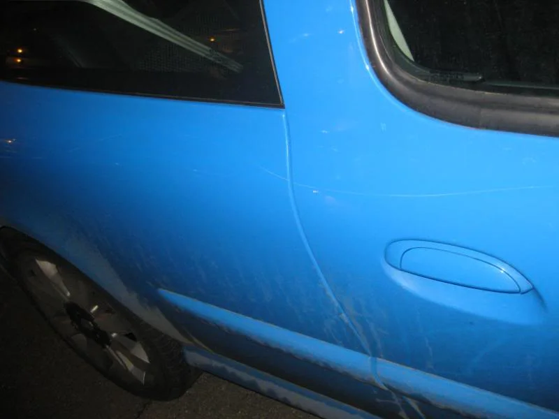

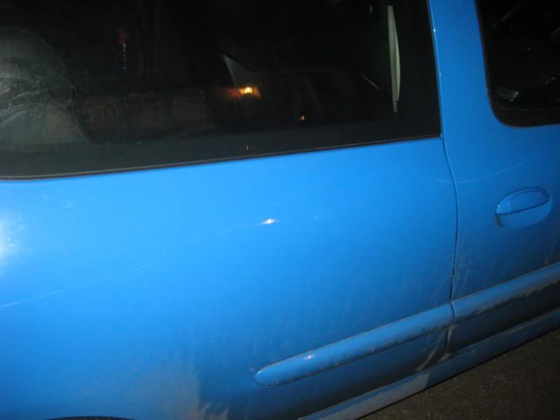

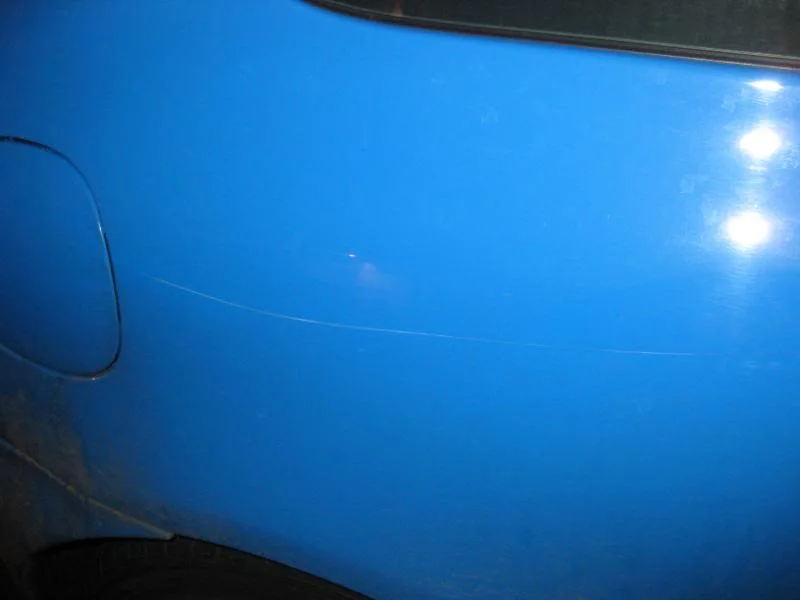

Came home from work today to find some little toerags have keyed my car :mad::mad::mad:
Can anyone advise roughly how much this will cost, it seems quite deep and it's on the rear panel and door :dapprove:
Gutted, it's come just in time for the massive Lakeside meet at the weekend too!
Here's some pics, although it was dark so you can't see it very well...
Excuse the dirt ;)
w*****s :(
If it's down to the undercoat then you have no choice but to get it sprayed :(
Get to a few bodyshops and get some quotes - if it's just a blowover it shouldn't be horrendous, but it will be enough :(

Personally wouldn't use ChipsAway (or any other company that would do a 'local repair') on damage like that. Not a chance. It would always be visable...
My feeling is get it all professionally sprayed and blended in at a reputable bodyshop. Even if it means saving up for a month or two.

i wouldn't say that damage would warent a respray... cant tell properly from the pictures but you MAY get away with wetsanding it and a ruddy good polish!
Dont know about a respray mate but its gutting :(
  Shed.
If you have a machine polisher which im presuming you dont, you could always try getting some heavy cutting compound polish on it first. If not, im sure a local garage would be able to sort you out if they know what they are doing.
So either:
Machine polish it if it isnt down to bare metal.
If it is to metal:
Paint stick, wet sand with 2-3000 grit and polish.
Or:
Garage need to do it.
