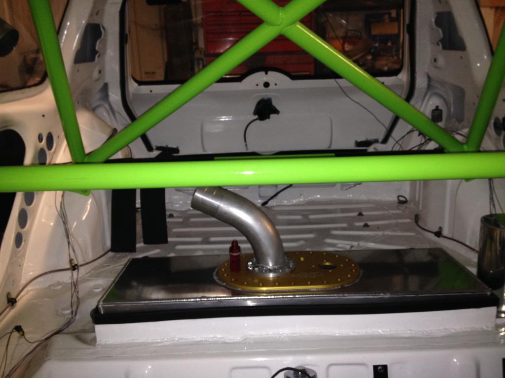

I hope someone can shed some light as i need advise from people regarding the issues i have doing a custom fuel tank.
Here's the tank in question so you can see what i'm talking about.
So one of my problem i'm facing is to do with the roll over breather (under the filler neck 1st pic) My original plan was to fit it and have the breather pipe cable tie'd underneath the filler pipe all the way to the mocal filler cap in the rear quarter window (just about see it top left) i've managed to find a pic.
The problem is the mocal flush fit cap isn't a breather type and has a rubber seal so any ideas as to where else it can go or better still a way to get around the non breather cap?, I don't really want to put it through the floor due to the exhaust near by.

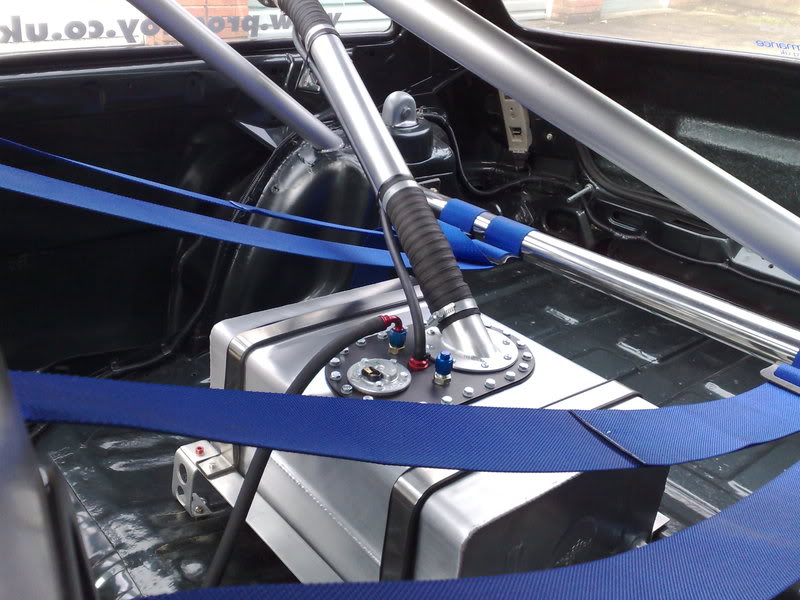

Second issue is the tank straps same as the 2nd pic again, I've looked online for a company that's able to custom make them (with rubber) for my measurements but can't seam to find anything apart from bloody truck ones.
So any ideas as to where i can get some made but MUST have the rubber?.
Appreciate Any input thanks.

Make the straps yourself. Some aluminium and strips of rubber. If your competing in anything that needs msa regs that won't be allowed either iirc
  M3, Cup racer'd 182
No not competing it's a road legal track car, any idea what the technical name of the rubber is?, the only ones i can find is truck ones and the straps are 2"+ wide which is over kill and will look daft.

Still got the breather issue if someone can help please?.
Run it up the diagonal bar on the cage and then send it out via the bootlid. It's important to get the height on it otherwise the breather won't work right as I'm sure your aware. I'm not keen on those style of breathers either tbh. I had one and the ball kept staying up closing the vent and pressurising the fuel tank!

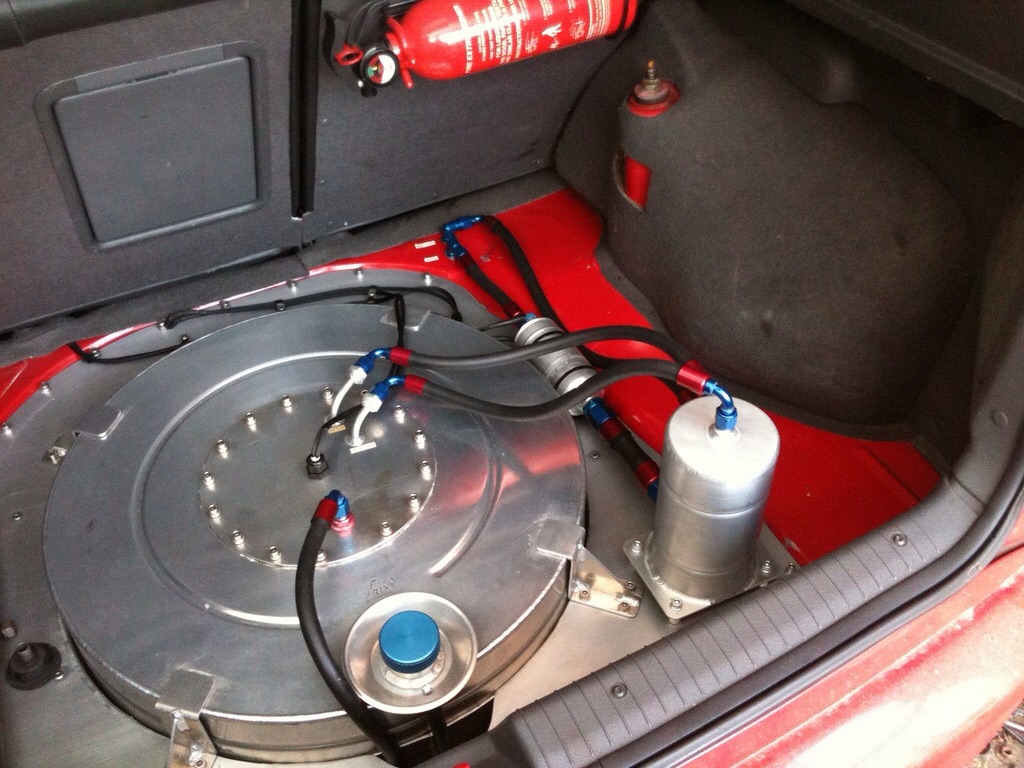

What size is the one you've got? Looks -6 in the pics? You can get some bigger ones as well that may be better for a larger volume tank.
