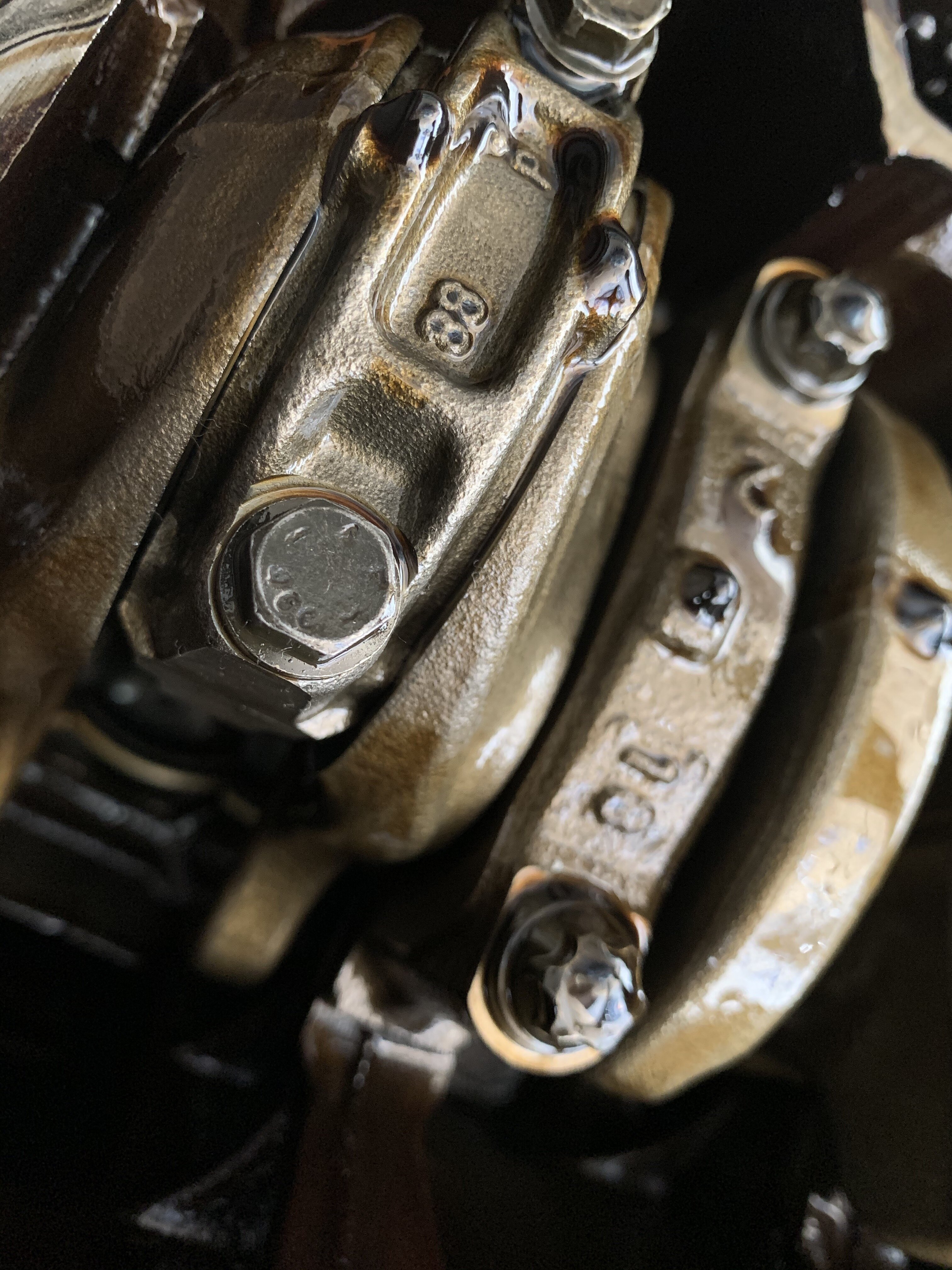

Help needed: 197 - F4R830 engine .What size socket for OEM rod bolt removal. 10mm defo to small, 11mm is rounding?
Car  Clio R27 F1
10mm defo to small, hex and 12 point
11mm 12 point is rounding? - could it be my socket is to old / worn?
7/16 12 point also rounding.
Please help!! pic of bolt below (HEX head)
I removed some rod bolts on a 172 engine yesterday and used a 1/4 drive 6 sided 11mm
Snap on FDX sockets would get these out mate no doubt
6 sided 11mm socket on them and lean your hand against the back of the ratchet head and tug with the other
They do round if you use a 12 point on them, especially on the windygun 😂
